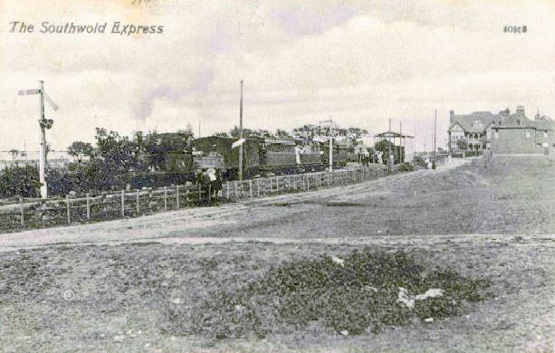

This postcard has always intrigued me as the inner and outer signals seem quite close. Would the outer/advance starter indicate the limit of shunting, do you think?

The postcard is interesting, because it does not have the lower distant arm and I can't tell if the bothy is by the inner signal. I shall have to dig out my copy of Honky-Tonk's book.
