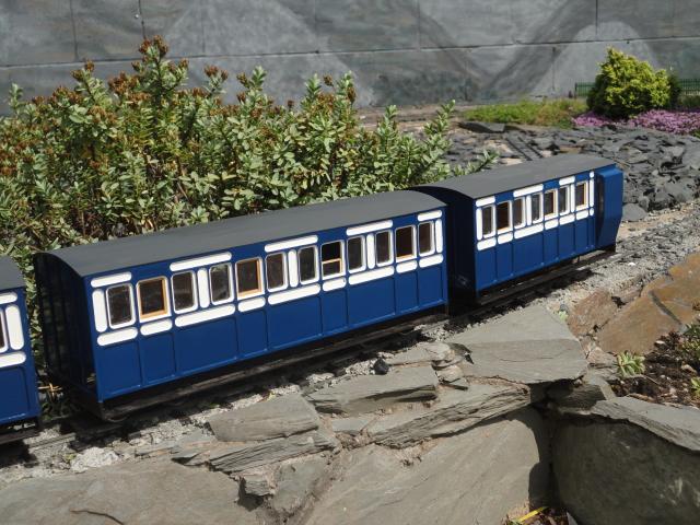

Post by laalratty » Sat Jul 07, 2012 8:40 pm
Tah-dah! The completed rake and it looks quite nice if I do say so myself. For the steamup tommorrow the Directors Saloon will also be added to make a four car rake
The two recently completed carriages. The other four wheel brake has the same interior detailing as the earlier one, except that the middle compartment is first class instead of third, just to make it different. Not fitted yet is door handles etc, I'll leave it up to uncle as to whether he wants to buy brass ones from Brandbright

Post by sstjc » Sat Jul 07, 2012 9:08 pm
Very very nice. I wish I knew how you guys make such a nice job of painting the panels (the white bits). I've tried and always make a right mess of it.
Barry
www.5inchrail.com
Post by laalratty » Sat Jul 07, 2012 9:35 pm
A steady hand, and lots and lots of time re-doing it until you get it right... :roll: A good brush also helps
