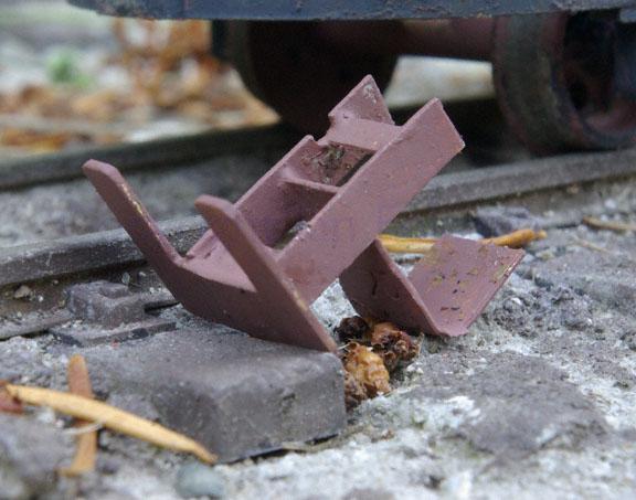

In the files section of the FR Yahoo group there's a photograph of coupling adaptors that the FR use. I thought I'd knock one up for my skips so that they can be coupled directly to Accucraft choppers.
So, the mk 1 version looks like this, made from some scrap from an etched brass kit:
It slips over the end of a Binnie skip:

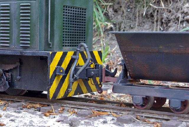

And can be coupled to a normal chopper, even those attached to bogie vehicles without derailing the skip:

Very nice indeed (& lovely pics). Really neat idea, I may have to try the same however with higher dumb buffer.

Again, Love the idea, have been thinking about something like that myself for a while but to fit to centre buffer stock.

Fantastic, very neat! I'll also have to have a go at some point as mine always detail with larger locos or larger stock.
