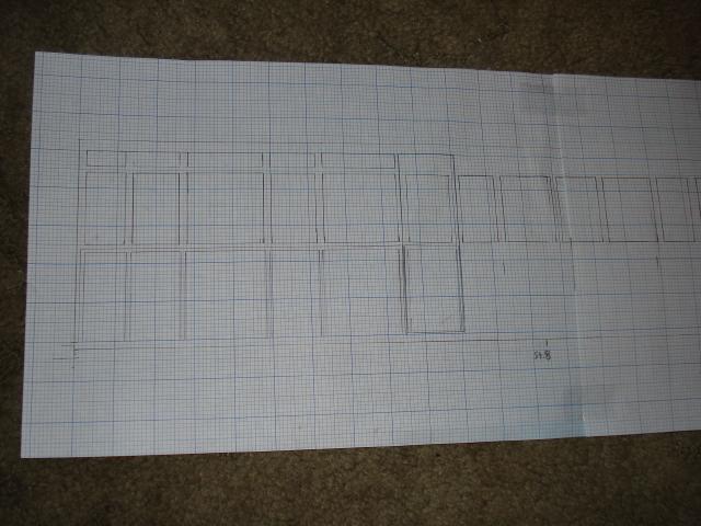

The drawing, incomplete but not needed to be complete because the coach is symmetrical from the centre

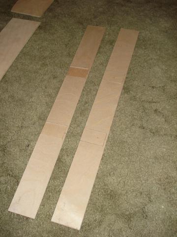

The sides have been done in a new way for me, three 1mm thick sides were cut out and glued together (because I couldn't find any appropriate 3mm ply). The front piece has had doors cut out and the inside one has doors scored out. The window frameing will be built onto the lower sides using stripwood.

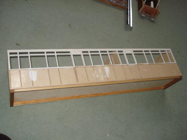

This is progress as of today, with both sides complete apart from beading, and with the partitions cut out and needing the rectangles cut out for the doors. The doors will be made seperatly. Hopefully this will be finished before the end of summer

As you can see the beading is now attached on one side, there is quite a lot for a modern general service carriage. I've also started with the wood priming, hoping perhapes by starting it now it will be less tedius to paint the carriage because the priming has already been done!

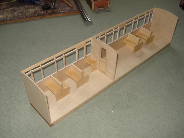

The interior at the moment. Thanks to finding a pic of the interior of 106 during the middle of its rebodying in 2002 I've been able to put more detail on the seats then usual, although I still needs pics of the finished interior, and the first class in particular to achieve the standard I would like. It is slowly coming along though.

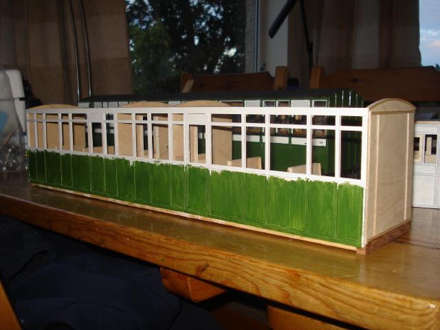

So I've just about finished the exterior panalling and started putting some paint on it, however I know need some more paint (still a bit left in the tin but once it gets old the paint takes and age to dry and harden, increasing the risk of getting dust in the paintwork and ruining the finish). So looking for other stuff to do I've finally put the replacement Brandbright ventalators on the L&B carriage, to finally complete its rebuild into FfR14, only a year after I originally purchased it! :roll:
