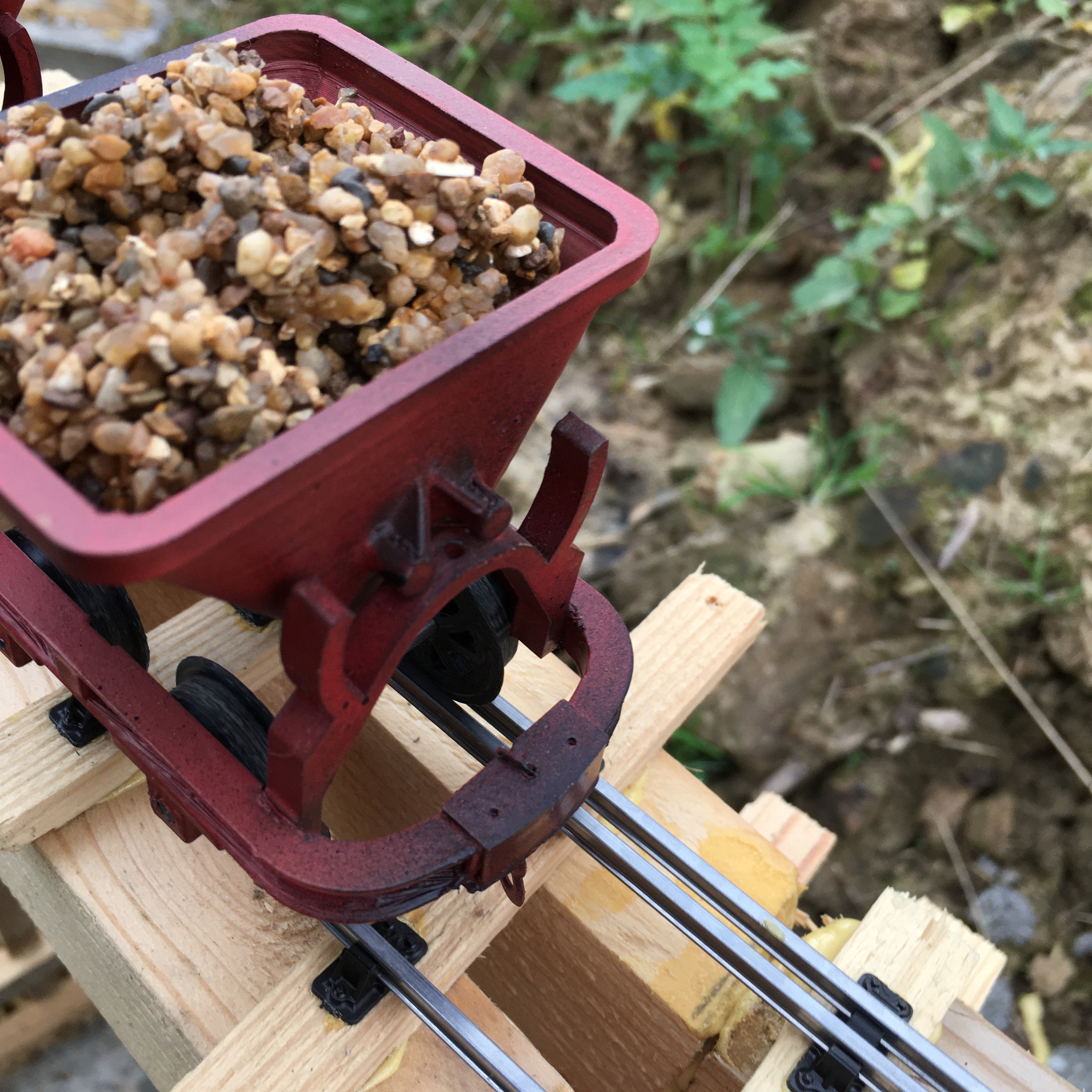

Going back to progress on extending the railway.
The track has now reached "dry land" at the other end of the viaduct:
and I am thinking about the passing loop. The first point offered up to see if it fits:
Posts: 1157
Location: South West Wales
Post by Trevor Thompson » Sun Oct 17, 2021 8:32 pm
Lonsdaler wrote: Fri Oct 08, 2021 6:21 pm I can't see how you've fitted the check rail - is it a double shoe or have you sliced part off the checkrail shoes? Either way it looks great. Looking forward to seeing it progressing.
I have realised that I have actually made an error here. The check rail chairs that I have used are actually designed for G1. And for Course scale G1 at that. So the end result is that the gap between running rail and check rail is 3mm rather than the 2.5mm which seems correct for 32mm narrow gauge. Bit of a pity really all that effort and extra expense and it isn't correct. Too late now! However I have tried a few different vehicles on the viaduct and the check rail isn't far off touching the back of the flanges - particularly on 4 wheel stock. Perhaps since it is on a curve that brings the flanges closer to the rail - so perhaps it isn't an issue. If you look closely at the photo you should be able to see that the flange on this wagon is near enough touching the check rail:
On the other hand it is an issue on the point. The wheels on test wagons just climb the frog - and its that 3mm gap which is the issue. So I am going to modify the point. I will cut through the middle of the check rail chairs (only 3 each side) and prize up the check rail. If I cut through with a cutting wheel in a dremel that should allow me to close the cut, and pin them down again at the correct spacing using a track gauge to make sure they go down in the correct position. I have noticed that if I cut off the bolt heads with a knife I can usually get a 0.9mm hole in the correct place and then use brass pins - the sort used for making model boats.
Last edited by Trevor Thompson on Sun Oct 17, 2021 8:41 pm, edited 2 times in total.
Posts: 1157
Post by Trevor Thompson » Sun Oct 17, 2021 8:37 pm
Testing the track on the viaduct:
The first train to pass all the way from one end to the other.
and to arrive on dry land at the other end.
Next stop the passing loop and Dduallt station building.
