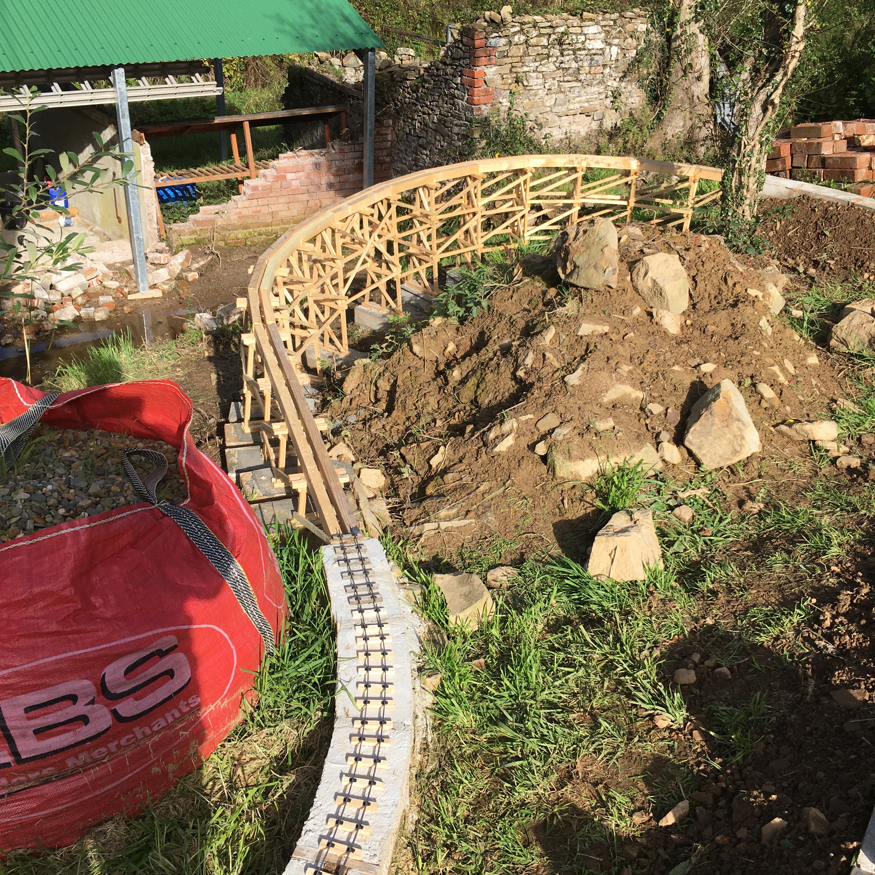

That is simply amazing. Very very well done.
Really looking forward to seeing a train going round that!
Posts: 7761
Post by ge_rik » Sun Oct 03, 2021 8:31 am
philipy wrote: Sat Oct 02, 2021 3:23 pm That is simply amazing. Very very well done.
My thoughts exactly. Especially if the video is taken from the angle of that final photo.
PS - I can just visualise a mountain stream tumbling down over rocks inside that big loop :D

Yes I see what you mean! that gap in the middle is just made for a steam to go through it.

The trestle is looking very good :thumbup: Some suitably dramatic landscaping of the slope will really set it off.

Many thanks for all the encouraging comments on the viaduct.

A number of comments mentioned water - and I have promised a pond - and I always intended to put it in the centre of the loop - so it could well go where the pile of rubble is at the moment, and feed a "stream" down through that central arch.

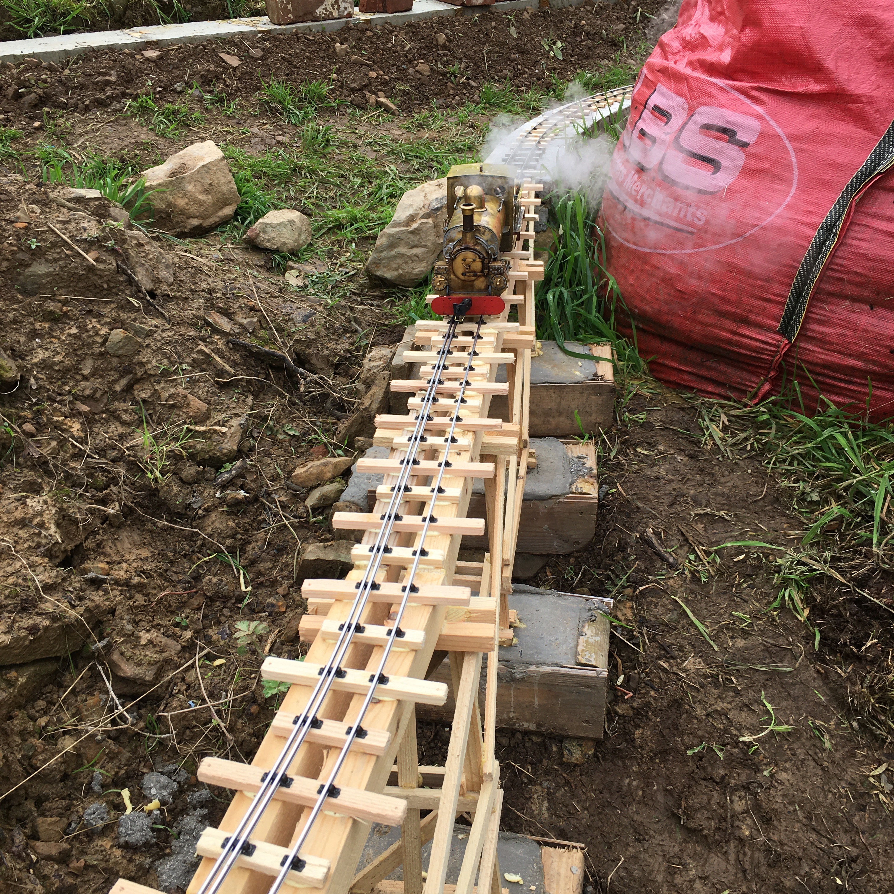

Testing the track on the viaduct:
That is 2 yards laid and four more to go before we get back onto concrete trackbed.

Brave man ..... doing it without a safety net! :lol:

I can't see how you've fitted the check rail - is it a double shoe or have you sliced part off the checkrail shoes? Either way it looks great. Looking forward to seeing it progressing.

I don't think there is much risk of it falling off, what with the check rail and the fairly level track with gentle curves. However I did try a battery loco first - and at various speeds.
The check rail is secured with special check rail chairs which have slots for both rails and at the correct distance apart. They are from Cliff Barker, as are all of the chairs, and I suppose are really intended for making points.

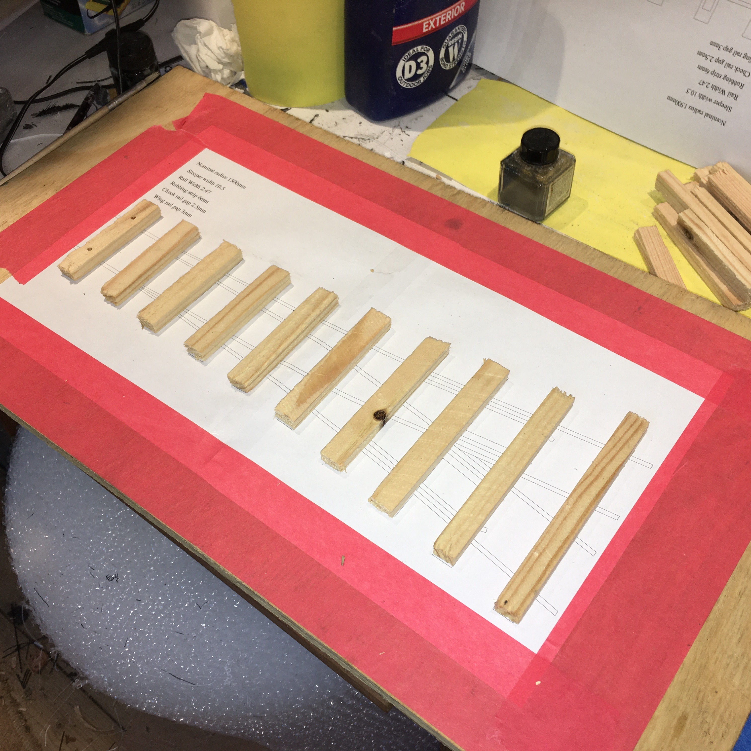

While I await the delivery of more chairs I have made a start on the "Y" points for the passing loop just beyond the viaduct. This passing loop is where Dduallt station building is going to fit.
The plan downloaded from the 16mm Association website with the sleepers glued to it:

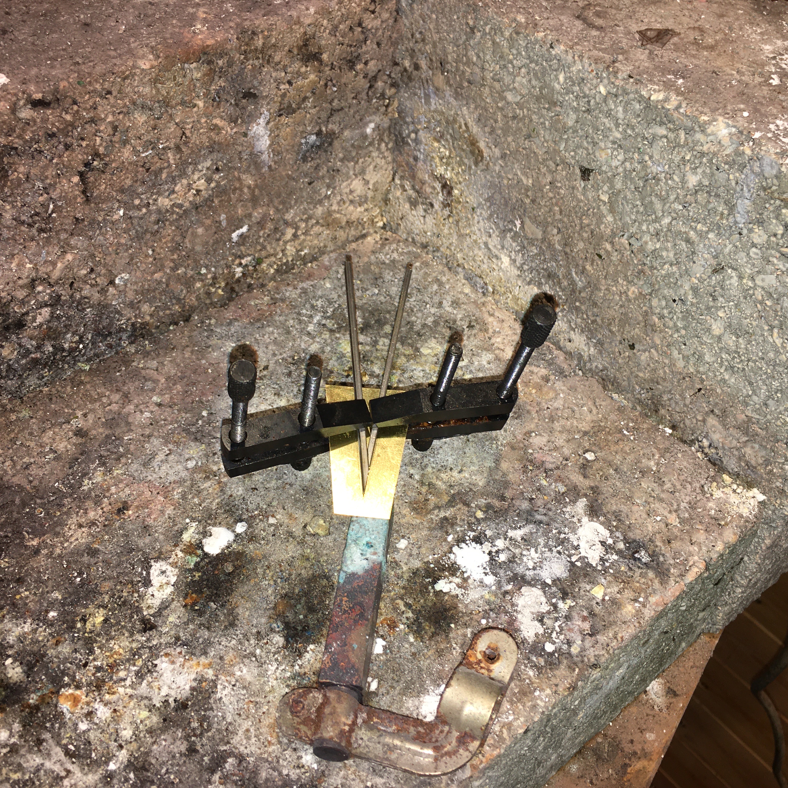

and the frog unit ready to silver solder:
I like to silver solder this part because I can then use ordinary solder to fit the wing rails to the frog without fear of the parts already assembled moving. I am using stainless steel rail, and while that is not a problem when silver soldering, it adds extra complication when using ordinary lead or lead free solder in that it requires a special flux.
The frog is in the pickling bath to remove the flux, and the wing rails are ready to fit next.

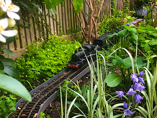

I’ve found Sweet Woodruff really useful for ground cover, filling holes and hiding scabby bits. It’s easy and quick to cut it back (with scissors) every now and again as necessary. Here’s a healthy plantation of it (permanently in shade) in the picture below, to the left of the loco.
