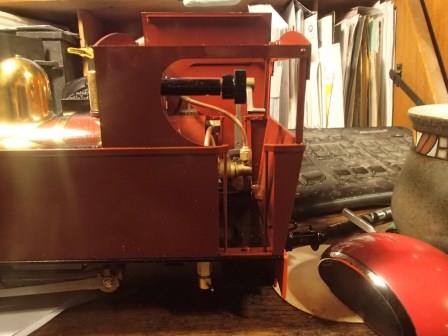

As you can see, with the revised siting of the gas valve just where the driver's head should go there seems to be nowhere to put a driver. Any suggestions? Has anyone got a ragleth like this and found a way?

I just put the driver on the other side, here's my Ragleth Purdy with Bob at the controls :)

Well here's two suggestions. The red loco is my Ragleth fitted with servos on the reverser and the regulator. As it is an earlier loco than yours I've had to site the regulator servo in the cab but never-the-less can still fit in the driver attached to the cab floor with velcro.
The green Caradoc, which has a similar cab layout to the later Ragleth, only has a servo on the reverser. I've also fitted a gas control valve that extends out of the back of the cab as I find it easier to use. That's meant I can put my somewhat portly driver in the position you see him. He's held in place by a M2 bolt which projects into the cab floor from below with a suitable hole drilled up through the drivers leg.
In the past the Caradoc also had a second servo for the regulator in the same position as the Ragleth. The driver user to stand in the same place as the driver of the Ragleth.

Thanks! Purdy looks pretty with her additions.

You could try cutting off the leg that would be on the inside of the cab. This should allow the driver to be fitted further into the cab and consequently hide the fact there is a missing limb.
