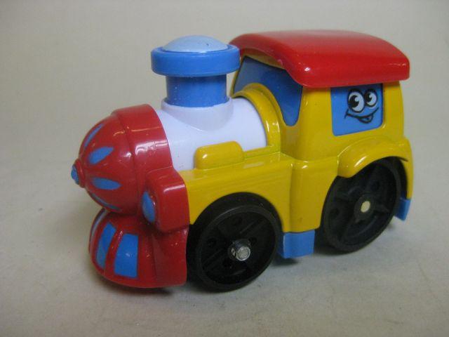

At the last CMES open day I found that the kiosk was selling some friction toy locomotives. They were made from plastic with a die cast body and when pushed the boiler rocked back and fore.

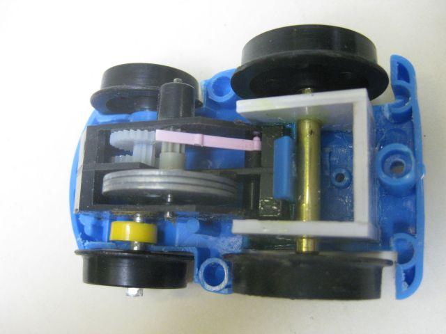

I thought it would be fun to fit flanged wheels to one.
After some chopping of the chassis, the result.

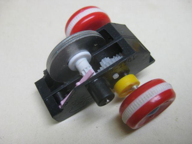

However a more practical use of the gear box might be.
The existing axles are just long enough for '0' gauge so the gear box could be used on a small wagon.
A piece of K&S 1/8" aluminium tube was used as a sleeve so the Binnie wheels could be fitted to the axles.
Regards Tony.
Regards Tony.
For use on aListowel and Ballybunion type line, perhaps? Not too sure about the hexagonal wheel though!  :lol:  :lol:
