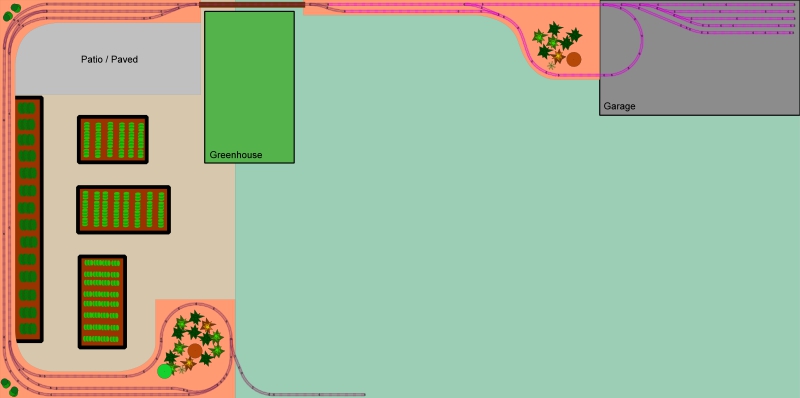

Post by stevenfitch » Thu Apr 30, 2015 11:00 pm
That plan is using (Piko R3) 920mm to (Piko R5) 1240mm radius curves - what would you suggest as a minimum?
I took the Piko quoted minimum for their rolling stock of 600mm (R1) and went with their R3 & R5 curves so i wasn't at minimum.
R5 straight points
R3-R5 curved points
