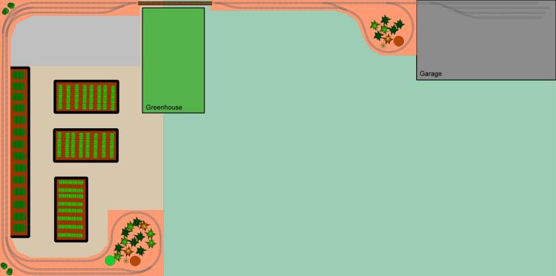

Thanks for the comments, the current plan is as below, im using Piko Radius 3 as my tightest and Piko Radium 5 points. That gives me a 1,240mm / 4ft radius.
As for wiring i am planning on housing all of the electronics in the garage in a cabinet with an anti condensation / frost heater installed and running all wires back to there, no soldering and splitting outdoors. The only solder joints will be to the track sections themselves.
The cable i am leaning towards is 7 core tow bar / trailer board cable as 3 wires are required for each section and i can then run the DCC bus for non detected sections and a 12VDC bus around too - It works fine using multicore alarm cable for N Gauge but some experimenting is to be done as too how much interference the cables within a multicore cause each other.
The stock will most likely end up as a mix of everything, probably staying away from full length mainline type coaches as i wont be able to fit enough in to make a realistic length train.

There are less implications for loops that are too long than for loops that are too short. Make a good guestimate then add some generous leeway.
Also, Kevin Strong of 'Garden Railways' mag fame has written a series of articles on DCC and automation of garden railways starting in August 2013 edition. As I do live steam and onboard battery power for my locos I didn'take too much notice of them but clearly if it can be done in the US then perhaps it can be done elswhere.
Good luck

The plan was to start construction about this time next year but I think i may put down a loop with a passing siding shortly in one area to test out various ideas and the automation. See what lasts to next year and what doesn't.philipy:109761 wrote: Not trying to put you off doing it, but just be aware of all the possible pitfalls before you spend lots of hard earned cash. I made the transition from N gauge -> 4mm-> 16mm Garden and it is a very different ball game out of doors.

Just be aware of return loops on track powered lines, wiring can become complex!

I think you've given Steven some very good answers to a rather odd and very open ended question, particularly Phillipy.
Surely track section lengths and loop lengths are as fundamental a part of railway planning as are the type of motive power and the colour of the axle box covers (if you see what I mean). It's integral to how the railway will operate, if you haven't got that sorted then maybe that's the next problem to solve, rather than this. No matter how 'right' you get the length of your sections, operation will still be unsatisfactory if you haven't considered and decided on what you want your railway to do and what you want to do with it.
I hope you get it nailed and look forward to further reports as your line grows. The track plan looks very professional and impressive!

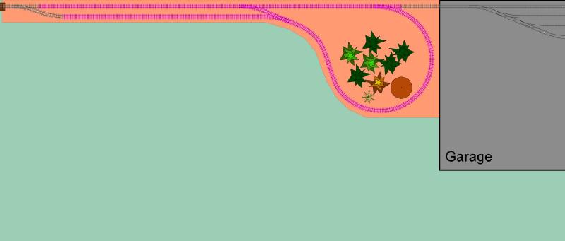

Smaller plan has been decided on. I will first construct the section highlighted in pink below and run it as a shuttle back and forth to itself. That way if it does work to a satisfactory standard then at least i've already built some of the bigger plan.stevenfitch:109769 wrote:The plan was to start construction about this time next year but I think i may put down a loop with a passing siding shortly in one area to test out various ideas and the automation. See what lasts to next year and what doesn't.philipy:109761 wrote: Not trying to put you off doing it, but just be aware of all the possible pitfalls before you spend lots of hard earned cash. I made the transition from N gauge -> 4mm-> 16mm Garden and it is a very different ball game out of doors.
