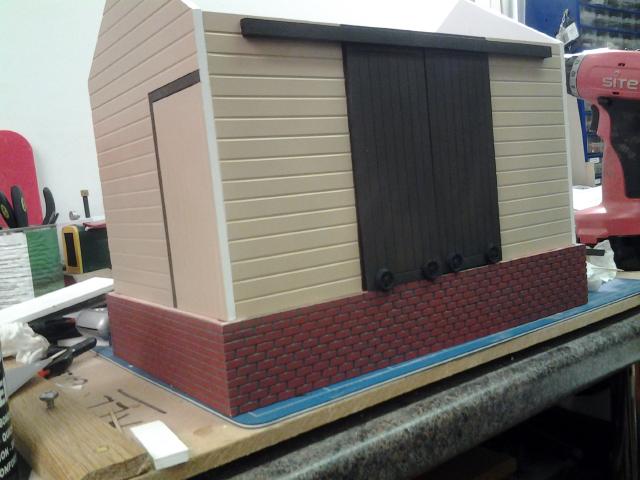

Post by bazzer42 » Sun Dec 15, 2013 10:22 am

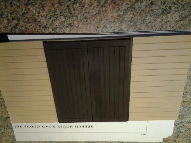

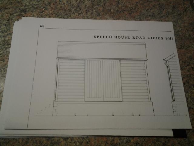

I feel guilty about reading other people's construction threads, pinching their ideas and never posting anything in return. This model, when we get there is based on some of the Eassie designs for the Severn and Wye. The rear of the wild swan books have 4mm drawings so it was 10 minutes on the xerox and full size drawings appeared. I have just moved into live steam so it was a chance to construct new buildings with a common style.

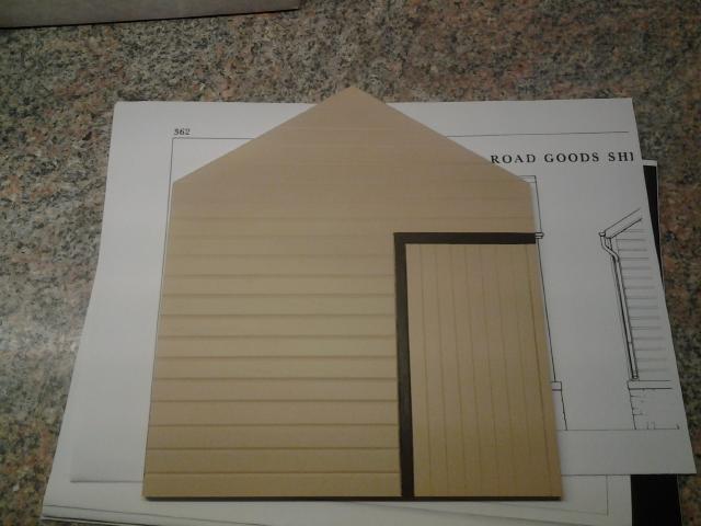

After a bout of pneumonia in March I invested in some 5mm foam board to scribe brick buildings from but have only just got round to using it. It is nice to work with and has been scribed with screwdrivers and a 2.4mm pin punch for the ship lap.
The doors ran on metal wheels but I have a feeling some old airfix tankers will be without wheels by the end of the day. I also hope to cut some pvc angle corners to cover the joints - todays job. I am thinking of 1mm plasticard for tiles and barge boards from the 3mm foam board I have used for the doors.
Having no windows this was an easy model to start with but I have invested in some resin to try and cast some window frames that I can use on station buildings. It looks easy enough on other people's threads :roll:

Post by bazzer42 » Sun Dec 15, 2013 5:18 pm
If you open a window you might hear the swearing as I haven't left enough room for the guttering with the size of the doors..... :evil:
my mate Stanley knife will help.

Post by bazzer42 » Mon Dec 16, 2013 8:06 am
You are right Jim but you would have thought that by now though I would have learnt not to just to dive straight in! I think I can make the doors work but not sure whether something like that is fine if it wasn't destined to live outside. Probably safer if they are permanently fixed.

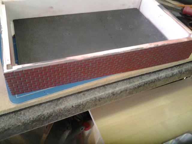

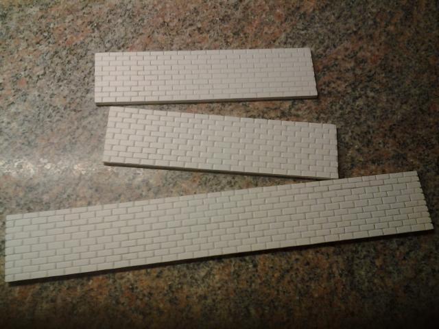

Post by bazzer42 » Fri Dec 27, 2013 5:00 pm
Taking advantage of the inclement weather I have scribed three sides of the brick base. I need to complete this so I can fit the doors.

The brickwork looks to be most impressive. Neat and evenly spaced. Time consuming I'll bet!
Keep up the posting and show us the finished item, please.

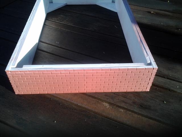

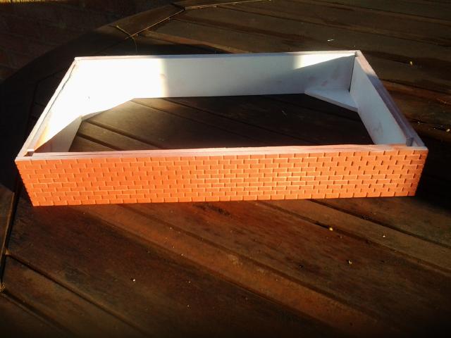

Post by bazzer42 » Sun Dec 29, 2013 1:17 pm
A quick shake with a red oxide rattle can and my bottom is all red! After all this I've just noticed my deliberate mistake...tip, when measuring up to get full bricks at each end you will probably have an odd size left. I have tried to overcome this by measuring in from both ends making the central bricks smaller for 3 or four. I have obviously used the wrong marks on this end piece if you look at some of the central vertical scores. From 6 foot who cares?

Post by bazzer42 » Sun Dec 29, 2013 1:22 pm
A quick coat of masonary grey and a wipe with a damp rag and instant mortar. I have added a slice of artificial slate to the bas for ballast and will use it as a base for the roof to give weight to the shed itself.
The scribing is tedious Peter but you learn an awful lot about screwdrivers, that is a boring subject (apologies to any screwdriver collectors).

Post by Peter Butler » Sun Dec 29, 2013 4:32 pm
Tedious or not, it is well worth the effort. The base with mortar lines is most convincing and the corners work well with bricks interlocking. I'm tempted to try this method myself to make use of my extensive screwdriver collection!

Post by bazzer42 » Sun Dec 29, 2013 4:59 pm
I'm working to 12mm bricks and 5mm spacing, this assumes the scribed line eats 1mm to give 3" bricks.
I'd like to try some other types of courses in other buildings, one day I plan to build a single road engine shed with integral water tank so that could be a chance to experiment.
The sheet is 5mm foambord sourced from ebay.

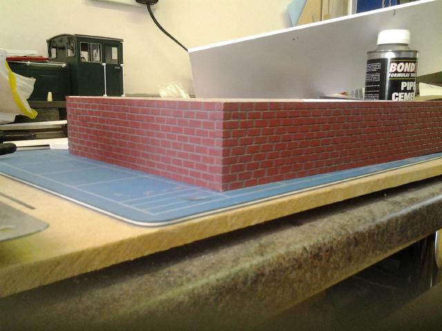

Post by bazzer42 » Sun Dec 29, 2013 9:33 pm
The last post for the day. Poor Mrs B has a migraine so I have had to fill the day somehow. Walls glued together waiting for their corner strips.
