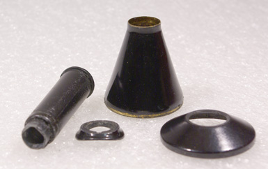

The spark arrester smoke stack was loose and fell off the smoke box with little encouragement. It wont be going back on as I much prefer the straight stack design. I would be grateful if someone could tell me the top and bottom diameters, and height of the 'normal' (slightly tapered) chimney.

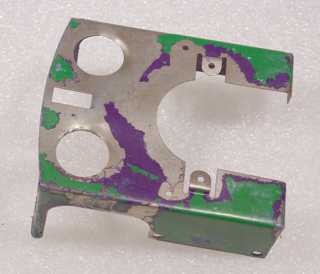

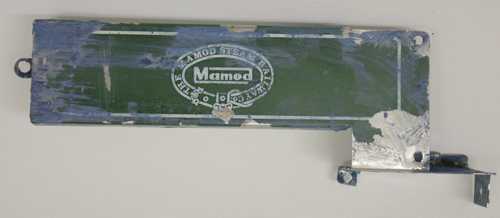

The side tanks were originally green (SL1)?
The cab front was green under the dark blue, but further stripping showed purple under the green (SL6)?
Then part of that chimney will be going back on. The SL2/3 chimneys use the standard straight chimney in the middle with a brass balloon spark arrester body and a brass circular top which is painted black.
The bottom of the chimney stack has a locating tab and was pressed on with a square punch. These work loose because owners picked up the loco by the chimney. Sometimes they can be glued back in place although I know someone has managed to produce a tool which flares out the bottom of the chimney.
Not sure about your cab front. Mamod are known to have made too many parts some times and re-used these by repainting them. However it is unlikely that they would have taken an SL6 cab front (which was a limited edition of 1,100 so why make too many?) and repainted it. More likely that your Mamod has been harvested from the spare parts box by a previous owner (the boiler has a riveted back plate).

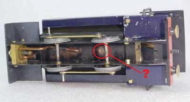

Intrigued by what looks like a repaired hole on the bottom of your boiler.
Mamod sent out display models to retailers and to prevent them from being sold as a working model Mamod drilled a hole in the boiler, which on the locomotives would have been in that location. I have an SL3 which had a hole drilled there and I've seen photos of an SL1 which was on eBay recently which also had a hole in the same place.
Chris Cairns.

The shiny patch on the bottom of the boiler is just that, a clean bit of boiler, no repairs or mystery holes. I'm more concerned about the lack of solder around the steam pipe connection, the pipe feels well fixed and is concentric with the dome fixing. I need to cobble together a connection to my test pressure gauge and find out if the boiler is sound or not.

Loctite 603 - Note that some traders on ebay are charging the same price for 10mls that other traders are offering 50mls for. But it is the most suitable Loctite.
Not sure how the saddle ring is held on to the bottom of the chimney (possibly glued but do not heat it up too much as Mazak has a very low melting point) but it is a bigger ring than the straight chimney one so that the bottom of the brass spark arrestor fits into the ring.
The joint at the bottom of the boiler is a known weakness. I had a rather arrogant moderator on another Forum telling me that as long as you had water in the boiler that joint would never leak, but he was totally wrong (it is right above the middle burner on a 3 wick meths burner, and similarly affected by a gas burner). I have had several boilers leak at that joint including a new MSS Saddle Tank loco. I would recommend roughening up the boiler surface around that tube fitting then using a plumbers silver bearing lead free solder (has a higher melting point than other soft solders) to strengthen the joint. As it has already been assembled using soft solder paste apparently you cannot silver solder it.
© Peter Longfils
You will need to trim up the solder as it will foul the combustion chamber when you try to fit it back in (there is only a small cut out on the bottom front of the combustion chamber for that tube).
Narrow Minded wrote:to meths or gas, you have a fuel supply with the opportunity to outlast the boiler capacity
The original meths burners had their capacity designed so they would run out before the boiler water level got too low (on a well running loco). However many users fill them up again having raised steam thus overriding that design feature, and of course meths burners like the Gremlin one have a much larger capacity. I agree that most ceramic gas burners have too big a capacity gas tank, although the Merlin gas burner was originally designed to run out before the water. But that was using Butane gas, does that capacity change if you use a Propane/Butane mix for cold weather?

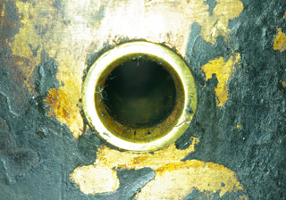

Here is a close-up of the boiler bottom steam pipe connection – not a lot of solder showing here, but only a pressure test will show if there's a problem.
Following on from Chris's comments about the chimney, with a bit of careful levering I managed to separate the component parts.

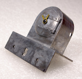

The smokebox has finished its visit to the paint stripper. I'm quite impressed with the detail in the die casting with the neat rows of rivets on the door hinges. I prefer this design to some of the later ones.
It will be interesting to see how well the satin black BBQ paint takes to the metal.
That is exactly how the boilers come out from the Mamod SL & MSS locomotives. The theory is bubbles/beads of solder visible around that joint indicates the boiler has been run dry (a common problem with used Mamod boilers). A lot of people are under the impression that these boiler fittings were/are soldered in using a gas torch, but they were/are actually brushed with solder paste then passed through a furnace (watch this video from 1:08 http://youtu.be/V9c83qO08HM - I've read elsewhere on-line that on some later stationary boilers these fittings are just press fitted). So this solder paste method is why many of the inserts work loose (particularly the steam dome threaded insert). I would still recommend soldering up that joint as my previous examples, particularly if you intend using a meths or gas burner.
Remember this.
Well 2 coats of U-Pol Etch primer followed by 2 coats of Plastikote BBQ paint produced this.
However I'm having problems getting the aluminium cap to fit onto the brass spark arrester body, and I do not have the bottom ring (the original Dream Steam was going to get me one but I never chased that up).
Your smoke box is the earlier version (no bulbous boxes on the side for the side tank tab fittings) which were the best castings. They got worse towards the end of the original Mamod railway production, and the current MSS ones suffer from poor casting/Mazak composition as well.

I love watching restoration projects on this forum. I would say that the purple paint on the cab is just a under coat for the repaint that your loco has had.
And the old ones seem to hold paint better than the newer ones from my two locos!

I just use stove paint on a smokebox, bit thin but well wearing. :)

Dichloromethane did not take the original Mamod SL3 paint off the smokebox, but did off of the SLK1 very quickly.
Both were repainted with high temp BBQ flat black rattle can spray.
On the SL3 smokebox it is doing well, it is coming off the edges on the SLK1 however.

it is coming off the edges on the SL1K however.
Which is what has happened to my repainted smoke box above.
