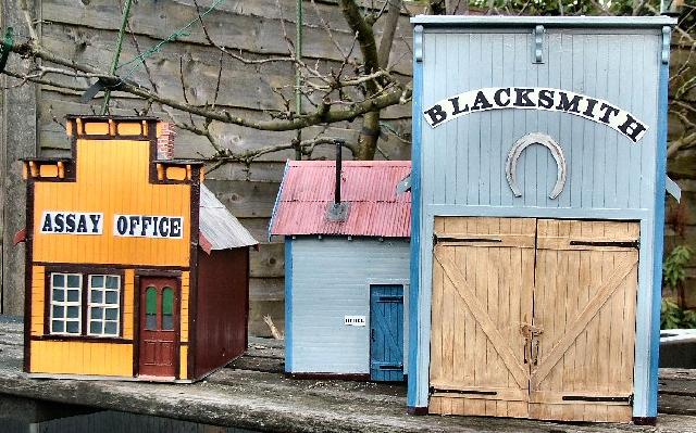

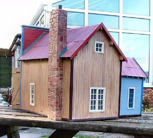

Hi,
Here are some photos of my Blacksmiths shop, made from 5mm thick PVC solid foam, and the doors were built to open so they can accept a Schliech wagon, as shown
The outer roof is made from the aluminum in Fosters lager cans, the forge chimney is PVC 5mm solid foam with the stones cut with a small burr in the surface, then painted various colours. The whole building sits on part of a flag, and the inside, at the front is painted black. The windows are made from scratch.
The last photo also shows a much smaller building which will be lettered for an Assay Office -  where ore was 'assayed' or checked to see if the miner had struck it rich!
(my apologies I forgot to tick the 'thumbnail' box!:( :( )
All are painted in acrylics and masonry paint then varnished with Johnson's Klear; transfers are being designed, thats right agin by me: I get them printed in the USA, on Bel Decal paper and they are very good., having been printed on an ALPS printer.

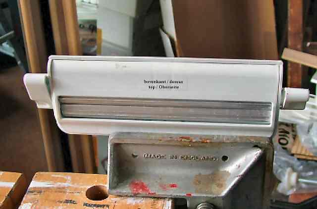

When all is complete open the kitchen window to get rid of the smell – I think it’s the coating that the cans have as it burns off. The sheets are now ready for the crimper – mine came from Fred Aldous in Manchester but Hobbycraft also sell them I believe. Since this was written the crimper does not appear of Aldous's or Hobbycraft website. However it is on the following weblink
to Cheddar Crafts
http://www.cheddarstamper.co.uk/P/Paper ... 6075).aspx
it is the Light Blue ones, with a handle at both ends which is important and are needed.
The crimper needs to have a handle at each end, otherwise the sheet being crimped will not run straight; and it is much more likely that the upper roller will lift resulting in no courugations in the centre iof the sheet – not the intention! Here is a photo of mine in a ‘Stanly right angled vice, which is fixed to a Workmate to keep both still; note how far into the vice it is fitted, that is to keep it quite still, leave a space at the ends so you can add pressure when turning the handles..
Take a sheet and feed it into the join between the rollers, and gently turn them slightly to grab it, using both handles, check it is straight, and again using both handles feed the sheet in for about three corrugations, it will be hard to turn – do it gently, feed it back on itself but not enough to let it fall out, then do another 3 corrugations again reversing it – this reversing will enhance the corrugations, continue to the end of the sheet, watching to make sure the rollers do not rise in the middle, if so you need to add pressure when re rolling (no hands available otherwise!), it really boils down to practice and watching what the sheet is up to it is much easier once started. Just ‘bear in mind’ that it can & will try to twist off line so producing corrugations that are not at right angles to the length of the sheet, with care you can go over the bad one to get it straight.

This is my crimper in a vice - that leaves both hands free to turn the rollers.

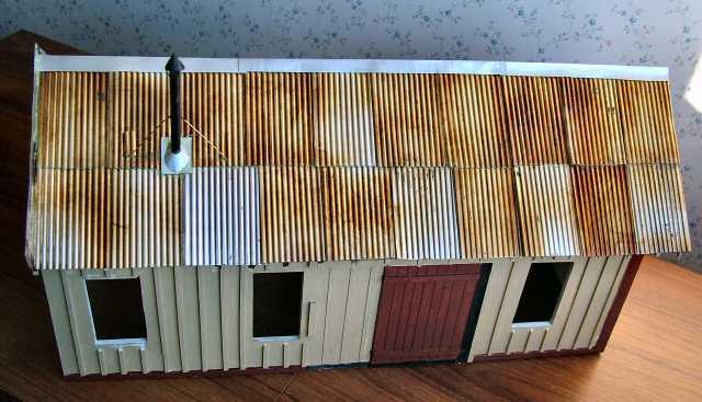

This is the roof of part of a large produce building (built for refrigerated vans to unload at), it is the colour of the asheets aftyer annealing, and they are fixed onto a plasticard under roof with Evo-stik.

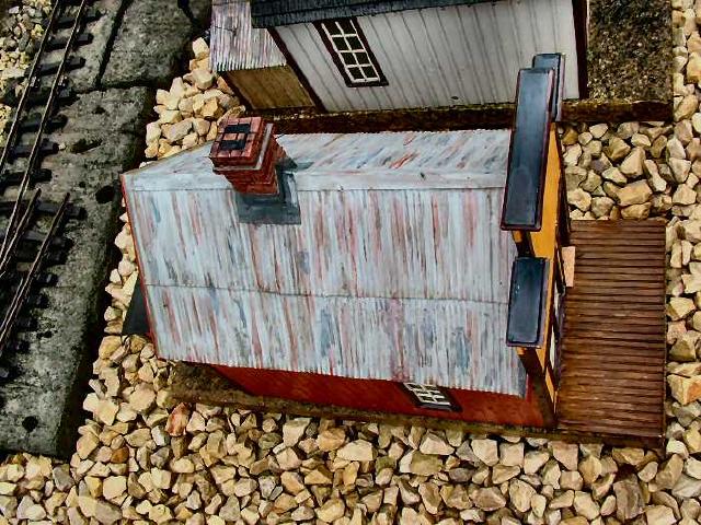

Here are a couple of rooves for the rr staff in location, and painted and weathered - it looks like some more is going to be needed. The rooves are painted with <asonry paint and varnished then you can have 'fun' with any old dirty/rusty/messy colour you want, and cap it off with some more varnish(Johnson's Klear)

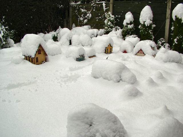

Here is what the buildings  had to put up with over the winter-
other than some minor rectification work, they all survived quite well.
