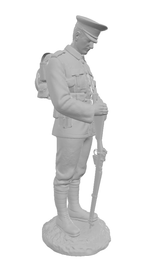

Just out of curiosity I quickly tried putting your B&W photo into Meshy. It made a fair stab at it but created a 'something' above/behind his hands, and omitted his helmet from hanging on his backpack.

That's amazing. I thought that it would be a longer process to achieve that result! And making the helmet and rifle separately opens up other options too (gun running, anyone?Durley wrote: Mon Nov 10, 2025 9:39 pm Hi Phil

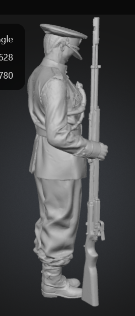

Here's where I have got to, which I'll now trial print. I've ended up adding the rifle, helmet, backpack, bayonet frog/entrenching tool and water bottle as separately created STLs that have subsequently been combined into one.
It's not a perfect recreation of the Clitheroe memorial, but I think captures the general look. It could be further refined with time, but to my eyes is close enough. A 3d Scan or digital sculpture would be the way to achieve better prototype accuracy, but at considerable cost versus this AI generated approach. It has also been a useful learning exercise for me in creating models from composite STLs, opening up other possibilities for me to try.

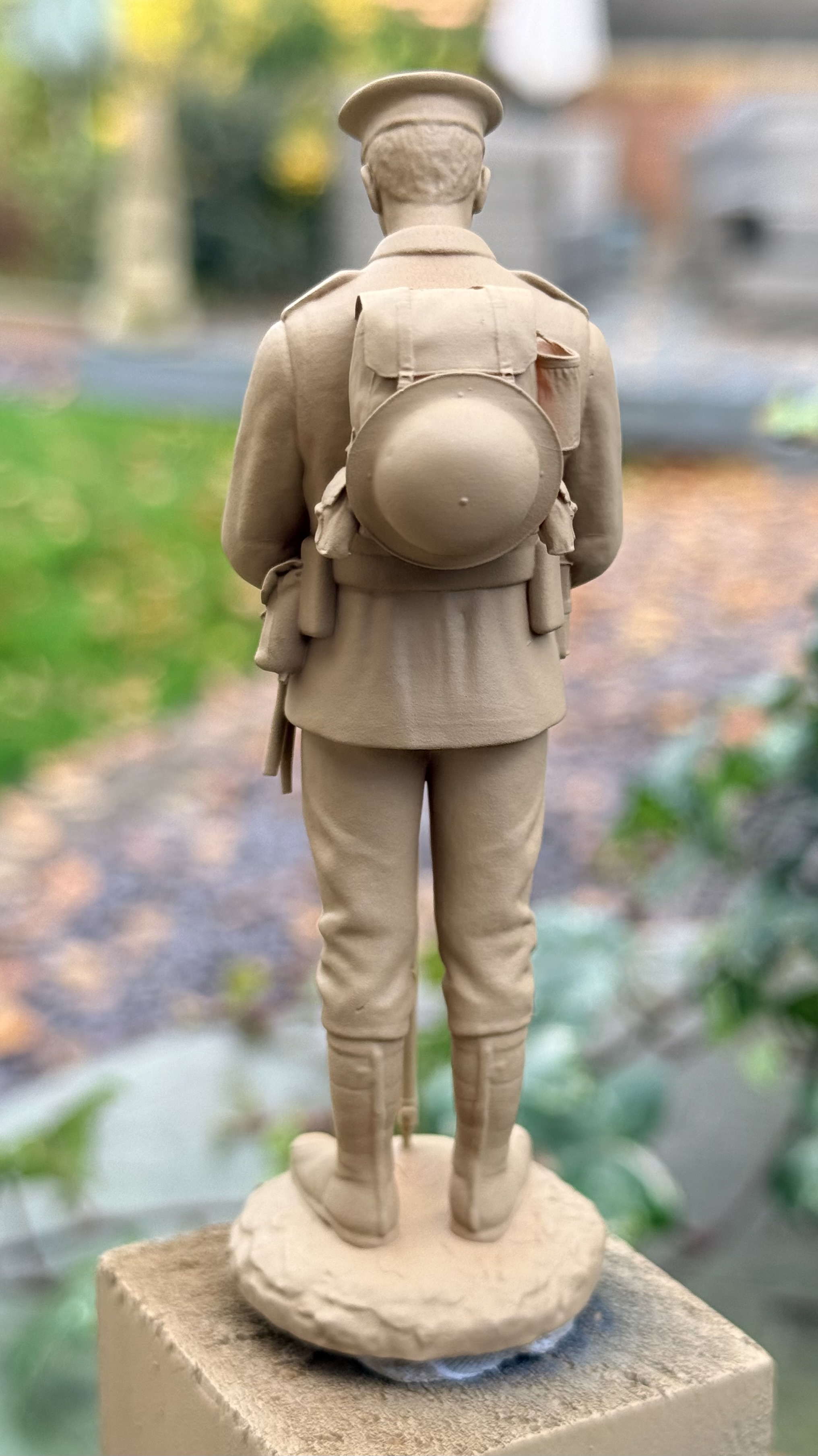

Trial print successful. Here he is with a coat of spray primer applied.

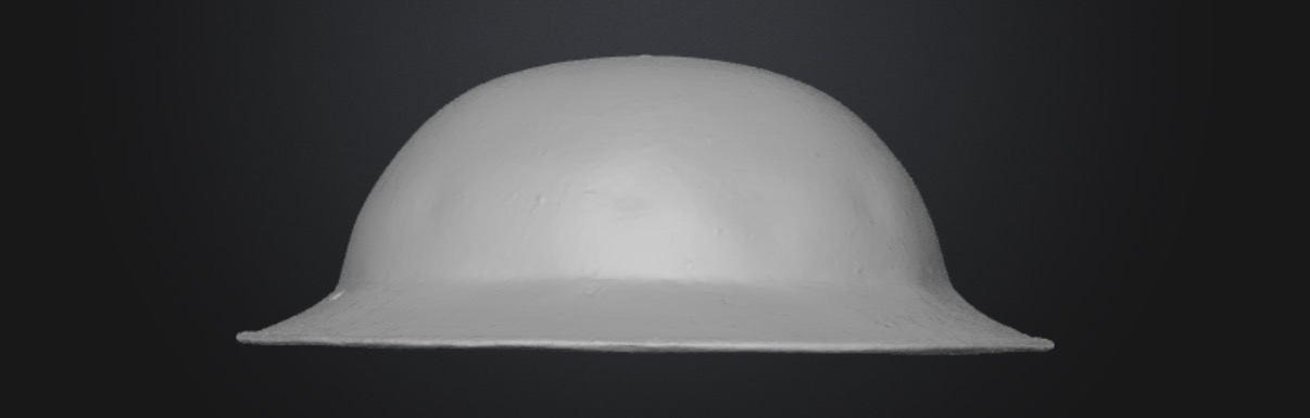

Just for your info, this is a screenshot from Chitubox reporting the error (at bottom right), but showing the different components, as I mentioned.Durley wrote: Wed Nov 12, 2025 3:38 pm

Thanks Philip. I think that is a result of the way Meshy created the canvass texture on the webbing items. It’s obviously not modelled as a homogeneous structure. Similarly it looks like some of the rifle is hollowed out. Looking at the sliced images, there’s no obvious defects in them, so I suspect the holes are smaller than the printer pixel resolution (less than 0.05mm) so have no noticeable effect on the physical print.
If I was to do it again I would try lowering the mesh resolution of the STL files for the separate items in Meshy, that would smooth out the texture and reduce the chance of creating hollows. It does explain the large file size of the STL as it is retaining a lot of unnecessary mesh complexity.
