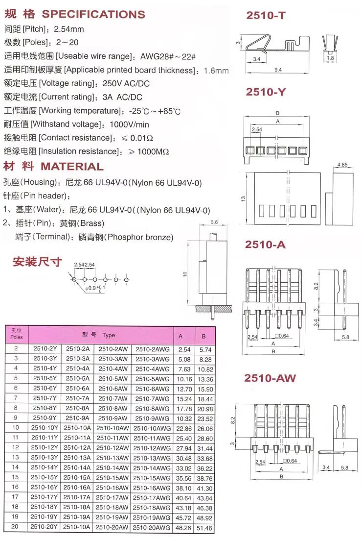

Indeed these appear to be the ones - I managed to find a site on AliExpress that included this diagram:
Many well meaning persons said the obvious (Google it) but as I already have smaller dimension connectors in this form I needed to establish the dimensions and pitch of the connectors I was purchasing.
Think I have purchased the ones I need - they were found at: https://www.aliexpress.com/item/1005006 ... 1802MS4lMz
And the table is from the "View More" section in the description.

As I stated in earlier posts this form of multi pin connector is available in different sizes based on the pitch (distance between the pins).
I have a stock of smaller width 8-pin connectors that wouldn't do the job as the pitch is less than 2.4mm.

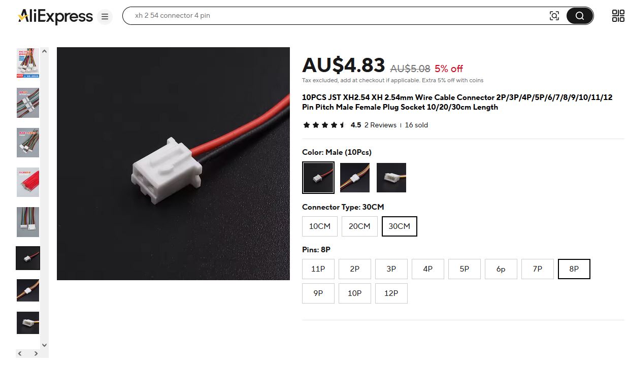

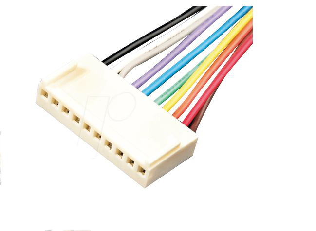

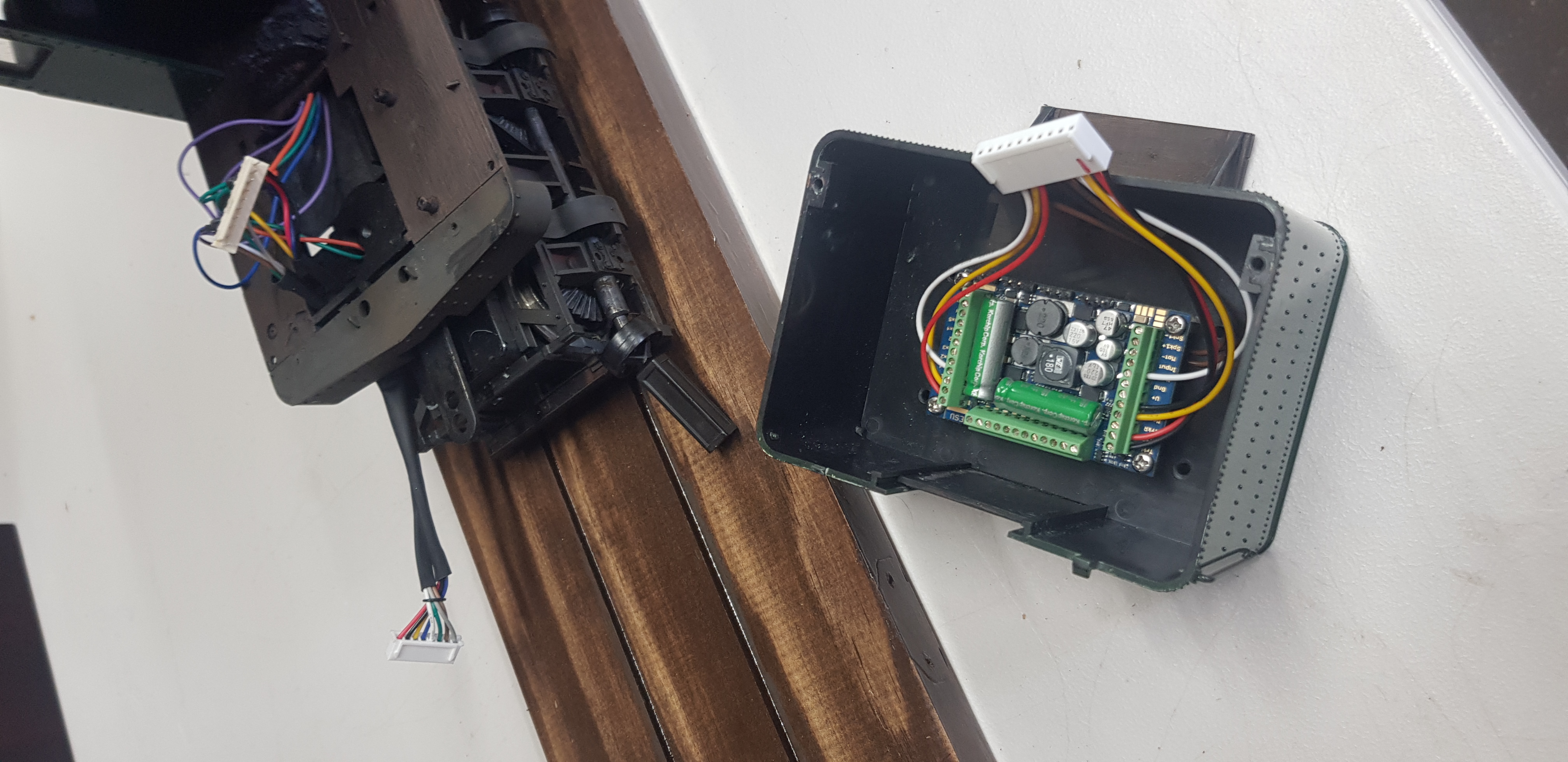

The 3-truck Shay is fixed - the Amazon order arrived after I had completed the repair but 10Pairs JST-XH Connector Kit, XH 2.54mm 8 Pin Header Male and Female Connectors Plug Adapter with Flat Wire Cable 200mm 26AWG Compatible with JST XH (8P) would have done the job - with the added advantage in that the order comes with the same sockets used on the Bachmann PCB and could be used to repair same.
Several other packets of connectors were purchased from AliExpress and whilst all appearing to meet the same specification only this supplier's connector mated correctly with the Shay's PCB socket under the water tank: 10PCS JST XH2.54 XH 2.54mm Wire Cable Connector 2P/3P/4P/5P/6/7/8/9/10/11/12 Pin Pitch Male Female Plug Socket 10/20/30cm Length sold by DTQ Connector Store.
Note that he lists the sockets as Male connectors (in my industry they are classified as Female - connectors with pins are Male).
This is the image of what to order to suit the Bachmann PCB socket with long enough lead length to go from the rear unit up into the coal bunker:
I took the opportunity to rewire the decoder and coal bunker connections using smaller form connectors than the original install that used a 10 pin connector more suited to automotive use (smallest that Jaycar could provide).
The decoder is an ESU 5XL mounted on stand-off posts with a ten pin socket - the 8-wire loom from the rear unit connects to a 10 pin plug to allow additional wires from the front headlight and cab light to connect to the decoder.
(The Shay came as a wreck from the US with no original electricals after a pretty poor attempt at battery power and radio control with no track power connections and completely non-functional as mentioned elsewhere).
Hopefully my posts here will shortcut the effort anyone else needs to take to repair/replace this loom.

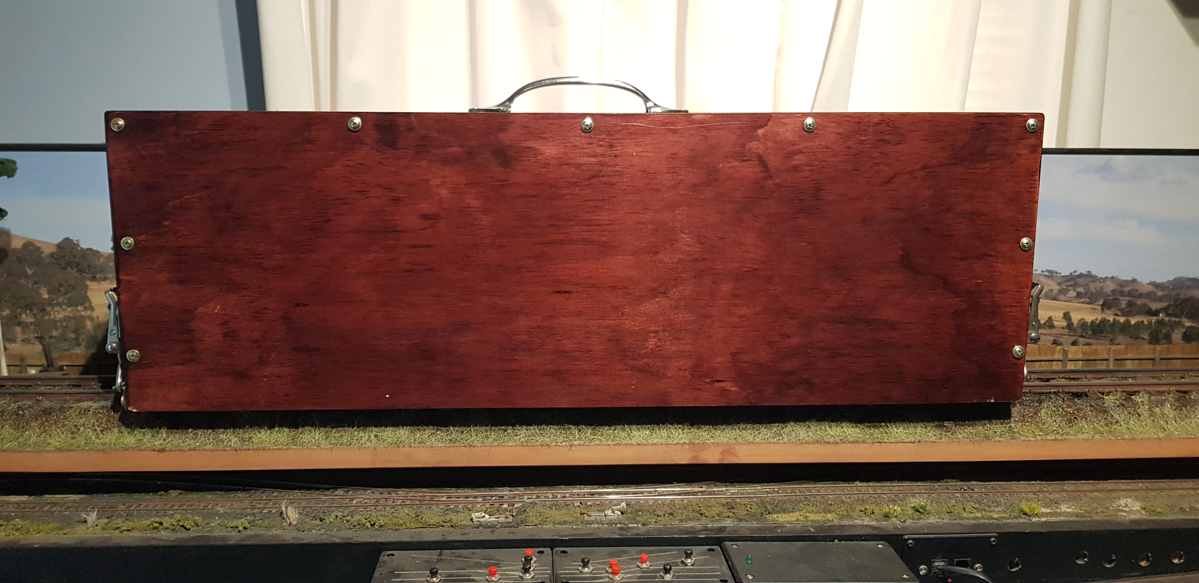

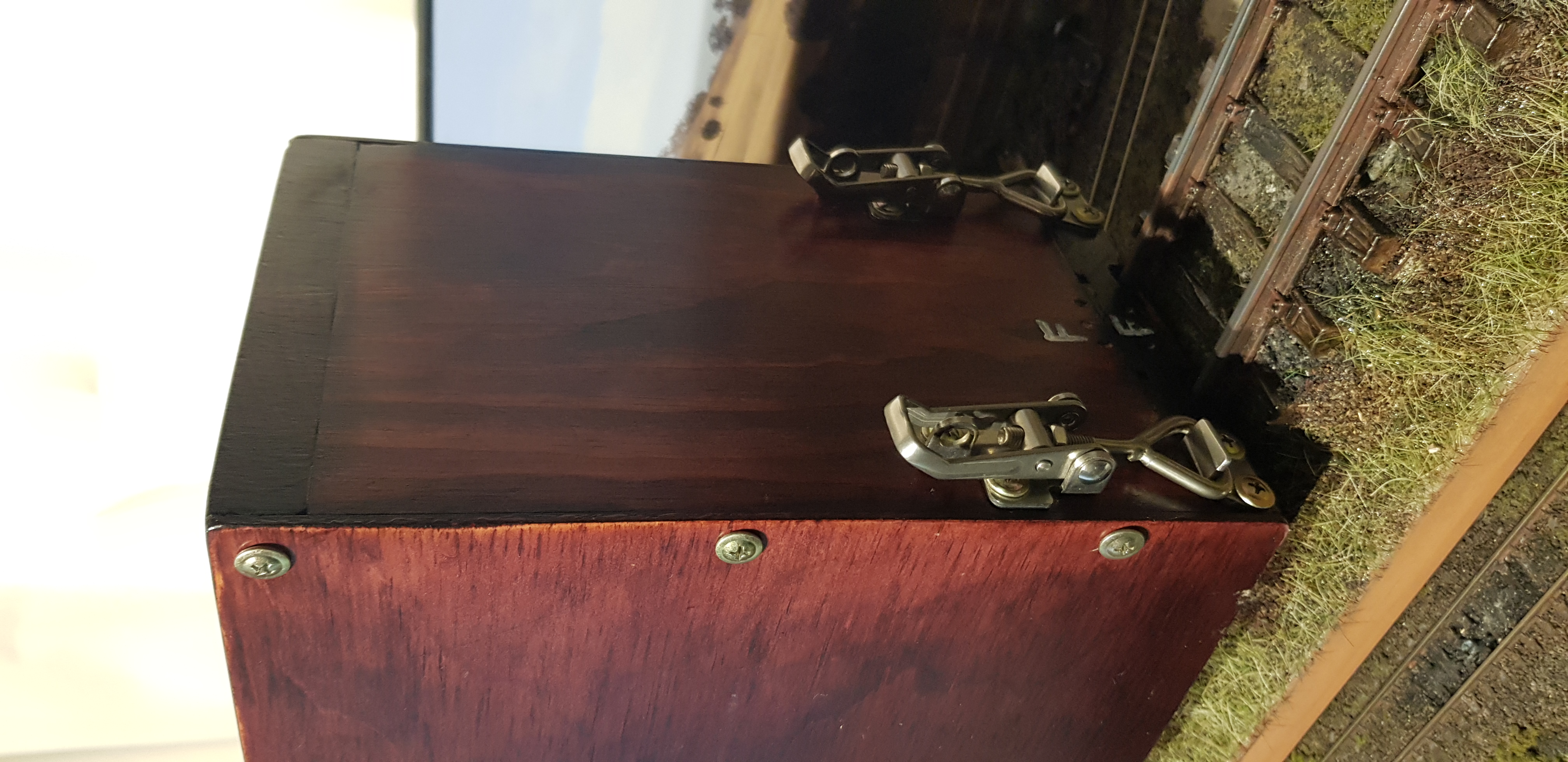

However I don't have an issue with handling as such as the Shay (and my Mallet) travel in a custom built box that allows them to be driven on and off the base using an LGB re-railer (both are battery powered - I don't run track powered locos except when first purchased).
The box is not the greatest piece of carpentry as I don't particularly enjoy woodworking and as my wife says it is not fine furniture you are making:
This shot shows how it aligns itself on a straight piece of track:

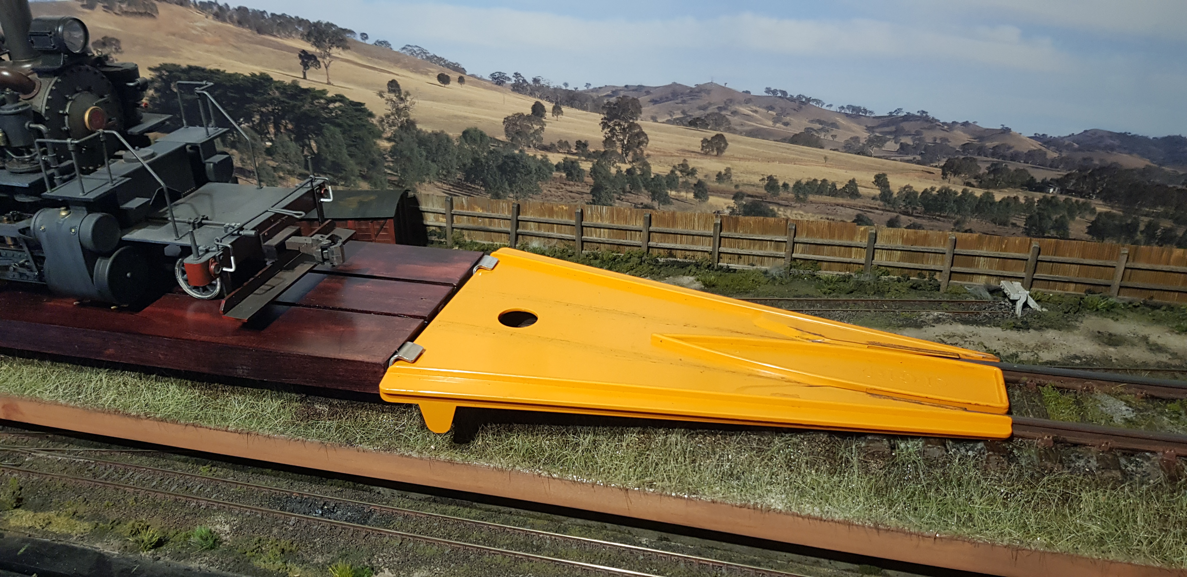

And how the LGB re-railer aligns with the track slots in the top of the box (all fabrication was done just using an old table-top saw-bench - no router required):
I did this as the Shay in particular needs three hands to pick up and the Mallet is only slightly less of an issue. Also by doing this components do not get damaged as occurs when you accidentally grab the wrong thing.
This was reinforced for me on Sunday when one of our club members was seen having to vertically lift a Bachmann 4-6-0 out of a nice box he had made followed by the tender - a future recipe for bits getting broken or damaged (as well as then having to connect cables and the tender bar).
