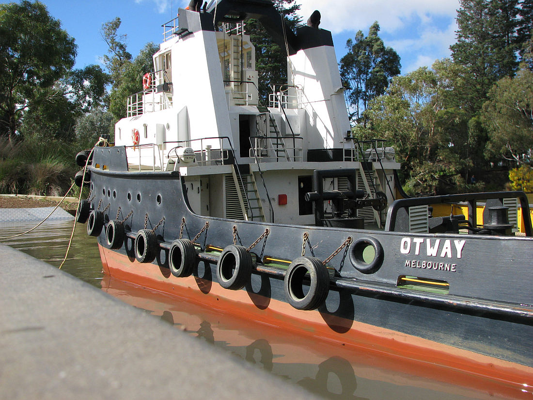

Post by LNR » Wed Sep 18, 2024 12:13 am

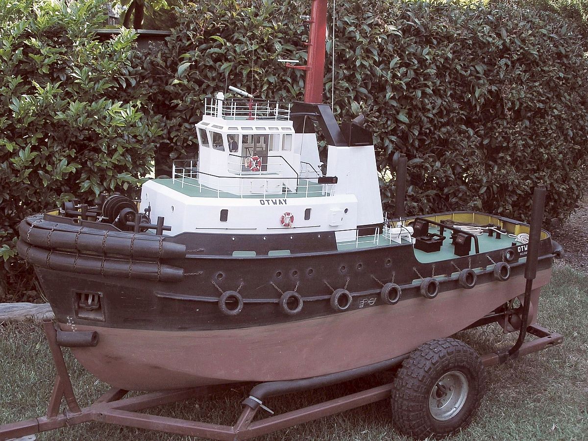

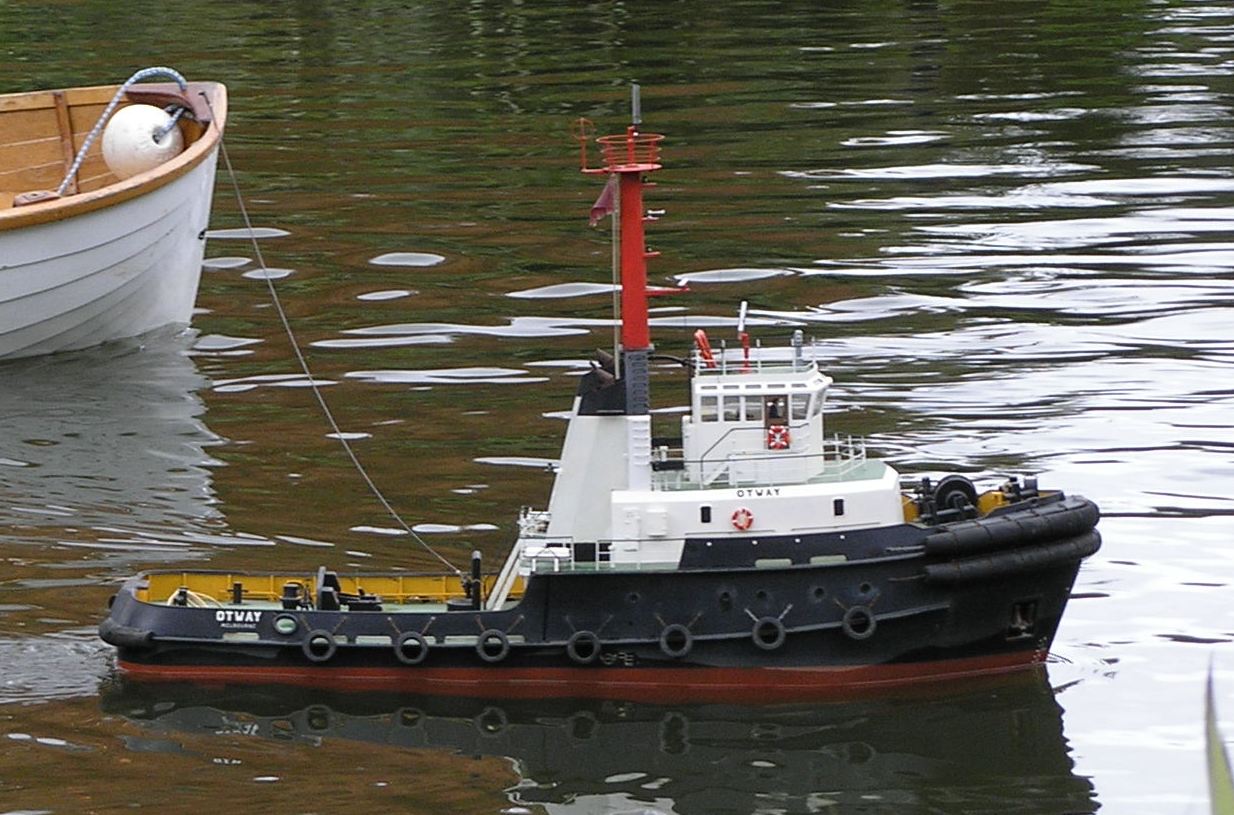

After racing Marblehead yachts, I decided to start building scale. This was my first venture. It weighs 60KG. and launched from a trailer.
Otway at Como Gardens 2.jpg (185.83 KiB) Viewed 126026 times
Otway Refit 8.JPG (330.44 KiB) Viewed 126026 times
Tug Otway 1.jpg (236.73 KiB) Viewed 126026 times
Fire fighting monitors shoot water about 6metres, radar, fully lit, two 105mm props in Kort nozzles.

Post by ge_rik » Wed Sep 18, 2024 7:06 am
Wow!!!! I mean, WOW!!!
How on earth do you find time for both hobbies? That must have taken a fair few hours' work.

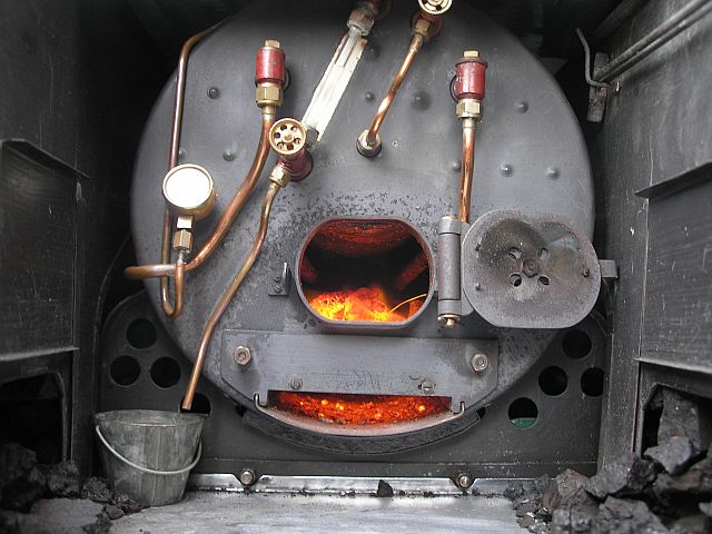

Post by LNR » Wed Sep 18, 2024 11:44 pm

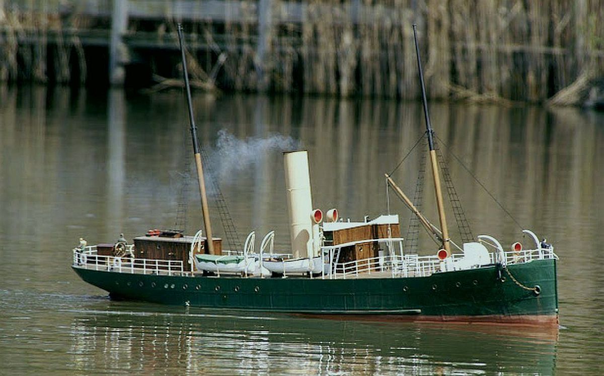

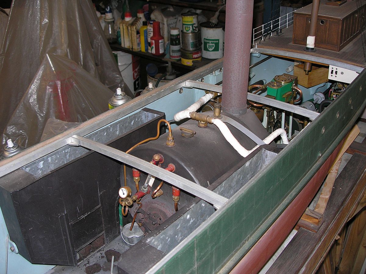

Probably my favourite, based on the "St. Ola" that plied the Pentland Firth.
Six ft. long coal fired, copper plated hull with rivetting to Lloyds 100A1 for a vessel under 500 tons. She carries a kilo of coal in two bunkers either side of the boiler and a litre of water in a forepeak tank.

Let me get this straight. Are you saying the model is constructed from individually riveted copper plates?
Posts: 1903
Re: Another Branch of My Hobby
Post by LNR » Thu Sep 19, 2024 8:57 am
No Rik, I built a fibreglass hull then sheathed it in the copper plates.

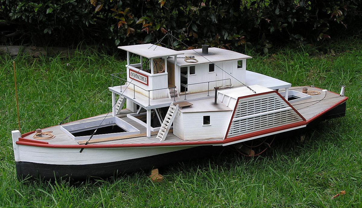

A Murray River paddler and barge would make sense for an Australian theme. I have one, probably a bit big for what you want.

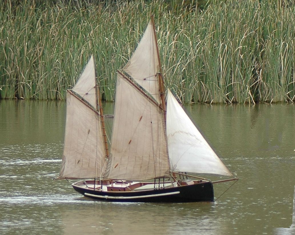

Post by LNR » Sat Sep 21, 2024 12:43 am
A different form of power.

Post by ge_rik » Sat Sep 21, 2024 8:26 am
LNR wrote: Sat Sep 21, 2024 12:43 am A different form of power.
What controls does it have? Rudder obviously, but can you set the sails independently of each other?

Post by LNR » Sat Sep 21, 2024 9:36 am
Not independently Rik, but you don't need to. It has a winch that controls all three sails.

Post by ge_rik » Sat Sep 21, 2024 12:20 pm
LNR wrote: Sat Sep 21, 2024 9:36 am Not independently Rik, but you don't need to. It has a winch that controls all three sails.
That makes sense. I've been tempted to acquire a RC sailboat. I used to do a fair bit of dinghy sailing in my younger days.

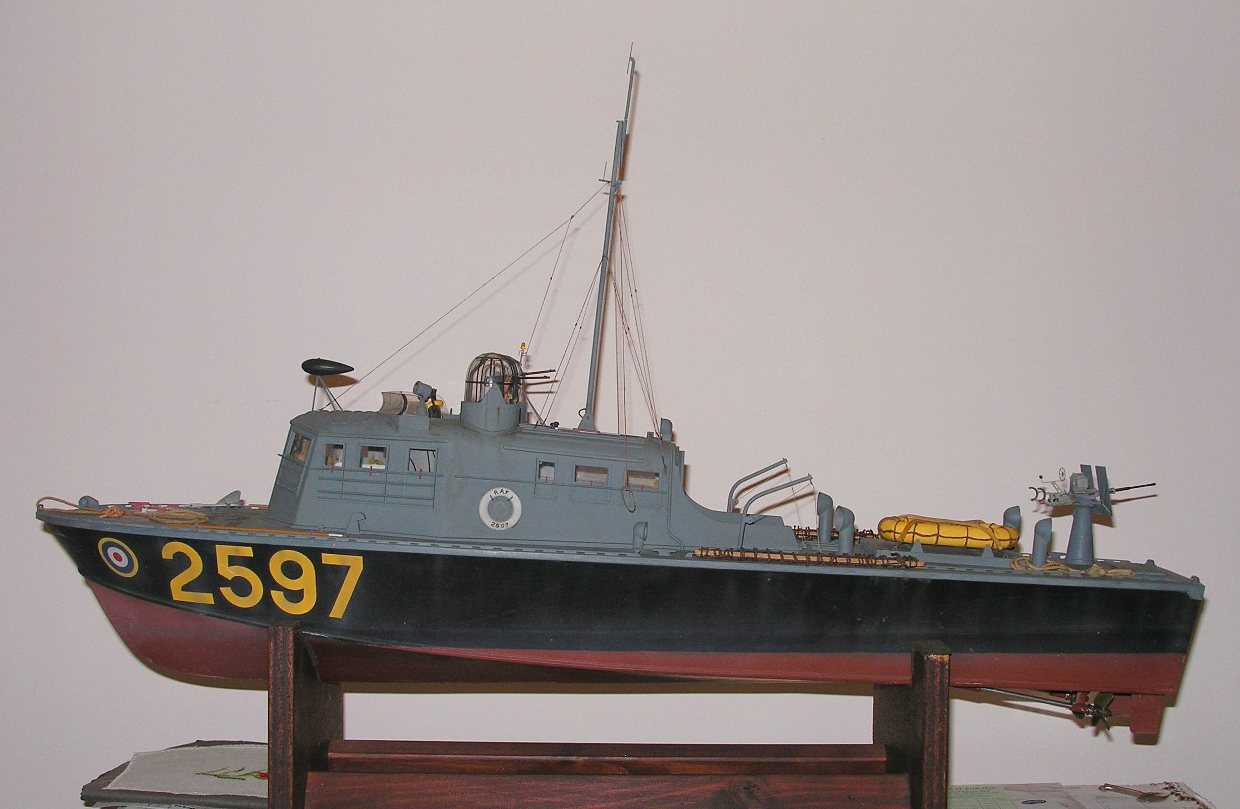

An RAF "Hants & Dorset" Air/Sea Rescue boat.
Hants & Dorset 2.JPG (378.18 KiB) Viewed 125341 times
Posts: 1196
Post by Old Man Aaron » Mon Sep 23, 2024 11:11 am
Absolutely superb.
How did you make that glass dome over the forward AA gun?
