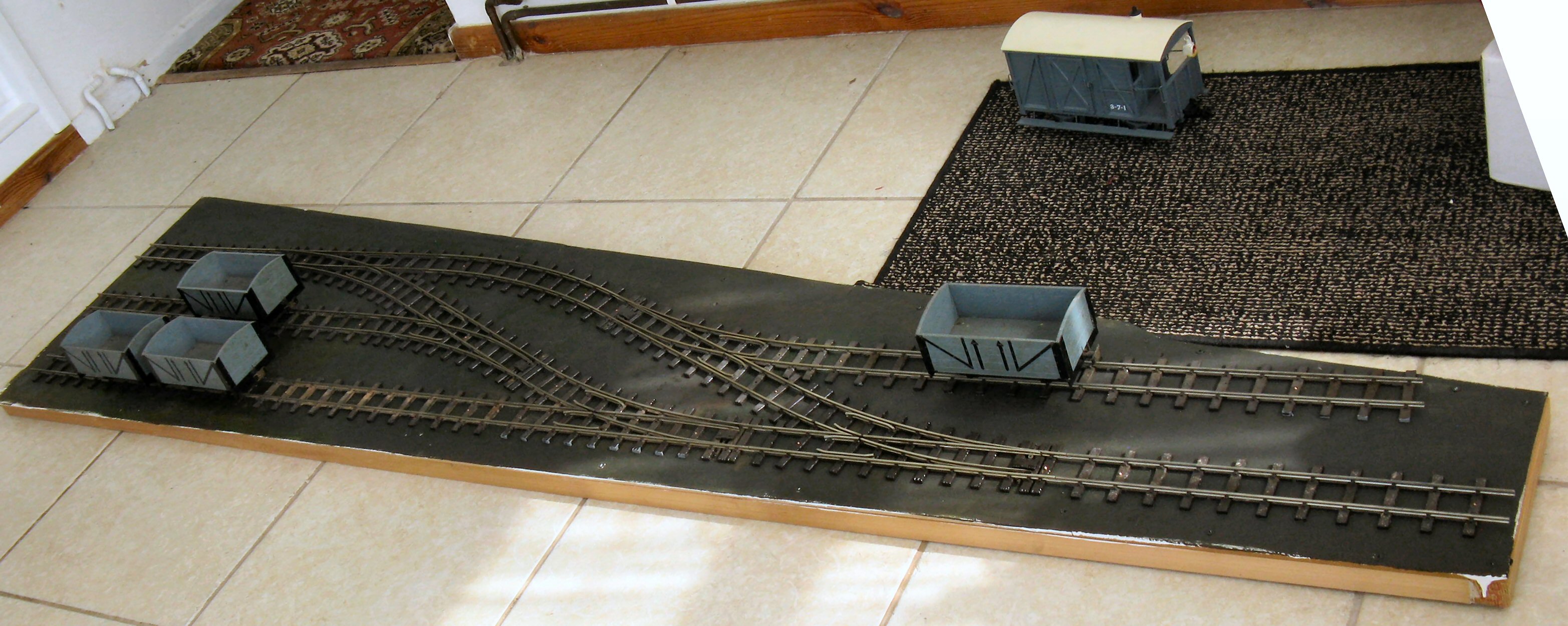

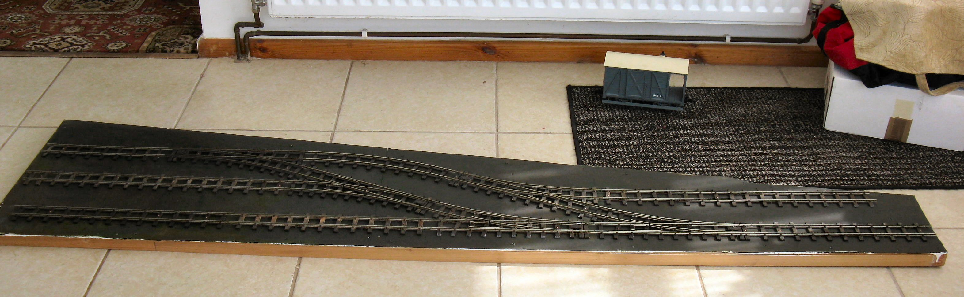

As mentioned in the First Great Project thread, I have ambitions to build a line round the garden. However, that's going to take some time to complete and I fancied something a little more manageable. I was given four setrack points as part of the trackwork I inherited and have always been interested in shunting puzzle layouts. There's plenty (too much!) of timber lying around, so I thought about an SM32 inglewood layout. Some rough measuring and laying track out later and I thought I would adapt it to a version of a plan I drew quite a few years ago for someone wanting a OO starter layout.
There's no surprises in construction, it's MDF on timber section, screwed and glued together. A base coat of a mix of dark brown, green and grey paint gives a generally 'eugh' colour. I may ballast the track or leave it. Scenery will be very basic and ground level. I can carry the board myself, though have to take care moving it between rooms in case I take lumps out of the wall or doorframes. Which, as I've just spent too much time repairing and repainting these, would probably lead to more than a little bad language!
Not much money has been spent. An extra setrack point was purchased second-hand but aside from this, expenditure has been pennies, most of the material I had already. I hope I and others will get some pleasure out of this and I'll learn a bit about operation before starting significant work on the main line outside. I need to finish painting the edges of the bracing and put in some ground-level scenery. Maybe a carrying handle. But the track went in today and it's ready for testing.
So, progress so far. I give you 'Ingleby Yard':

Nice work, you should be able to have some fun with that and even be warm and dry.
- Posts: 7969
Re: Distraction No. 1...
That looks fun. More interesting than the usual inglenook sidings layout as it includes a run round loop.

Yes, the loop was something added after initial reflection and specifically to add operating interest. It takes up very little extra space and I thought 'why not'?ge_rik wrote: Mon Aug 05, 2024 7:12 am That looks fun. More interesting than the usual inglenook sidings layout as it includes a run round loop.
So far I haven't done much shunting with live steam. I've had a session with a Darjeeling battery 'diesel' and could operate that fairly precisely. One of the reasons for building Ingleby Yard is to have a play without getting in others' way when visiting the local 16mm association's lines.GAP wrote: Mon Aug 05, 2024 9:13 am I'm thinking of pinching the idea for my inside portion of the railway to give some shunting interest.

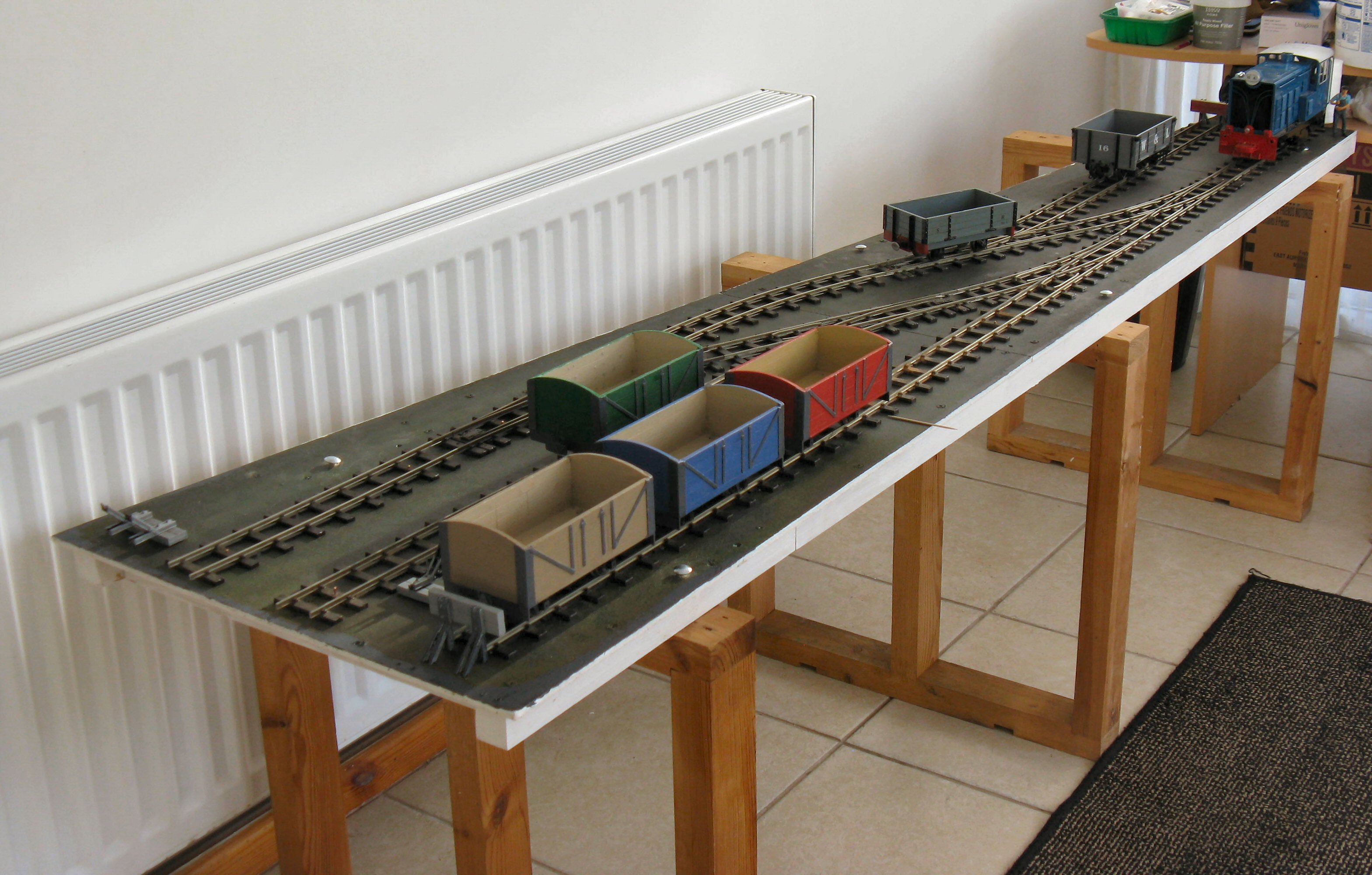

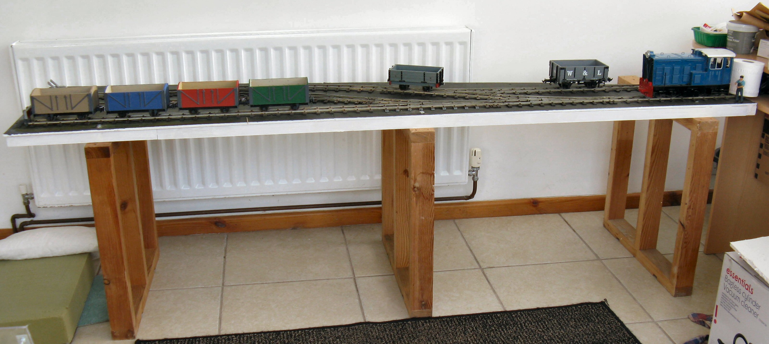

Well, given the Bank Holiday traffic, I thought I'd stay at home and do some railway and gardening work today....
Since the last post, I've added 'legs' to Ingleby Yard' and painted up some POWs in basic bodyshell colours - the transfers artwork will make a big difference but I'm undecided as to what to go for (any recommendations/advice welcome) but they look better already. I've been doing some measuring and calculating as to how many wagons go in the various sidings. As ever, I suspect an extra couple of inches would have been most useful. But it does work, even if some clearances are a bit tight. If people visit, then I expect their wagons will vary a bit in length and clearance anyway...

Some Fun to be had there ,while you build your garden railway. When I make an inglenook layout I make sure the head shunt is slightly longer than the longest siding .

Looks great! Love the NDM6... I've been working on building mine on and off for about a year so seeing it on your layout gave an instant sense of scale.
Does the runaround loop make up for the short headshunt? I made the headshunt too short on my HO scale Inglenook and eventually got so fed up with it that I extended the shelf with a staging area on that end which allows me to 'cheat' a little if I have to.

Here, the headshunt is only the length of the loco and one wagon. But the loop does give you more options. And I built it so I could extend the headshunt onto another board, whether a fiddle stick or a 'scenic' section.Preseli Chris wrote: Mon Aug 26, 2024 7:56 pm Some Fun to be had there ,while you build your garden railway. When I make an inglenook layout I make sure the head shunt is slightly longer than the longest siding .
Thanks. It's the Roundhouse version. I'm not sure if it was originally kitbuilt or RTR. But - except for occasionally through the Setrack frogs - it runs sweetly enough and I can get good control, it is a good shunting loco. One of these days (round tuit...) I'll see if I can take a short video and if You Tube still recognises me.drewzero1 wrote: Tue Aug 27, 2024 3:59 am Looks great! Love the NDM6... I've been working on building mine on and off for about a year so seeing it on your layout gave an instant sense of scale.
Yes, time/more experimenting will tell but I may have made the headshunt and the middle siding a bit short - though making the layout much longer would have required two boards and more complicated joinery. I'm trying to avoid that at this stage. I can get three of the PO wagons in the loop, four in the front siding, three (just!) in the middle and right sidings. One potential complication is I don't know where the [coloured] wagons came from and others I have are fractionally shorter/longer. So I do see some potential problems there. But I'll keep the layout basic for the time being and if I dismantle it next year for a mark 2 iteration with lessons learnt factored in, then there'll be very little lost.
