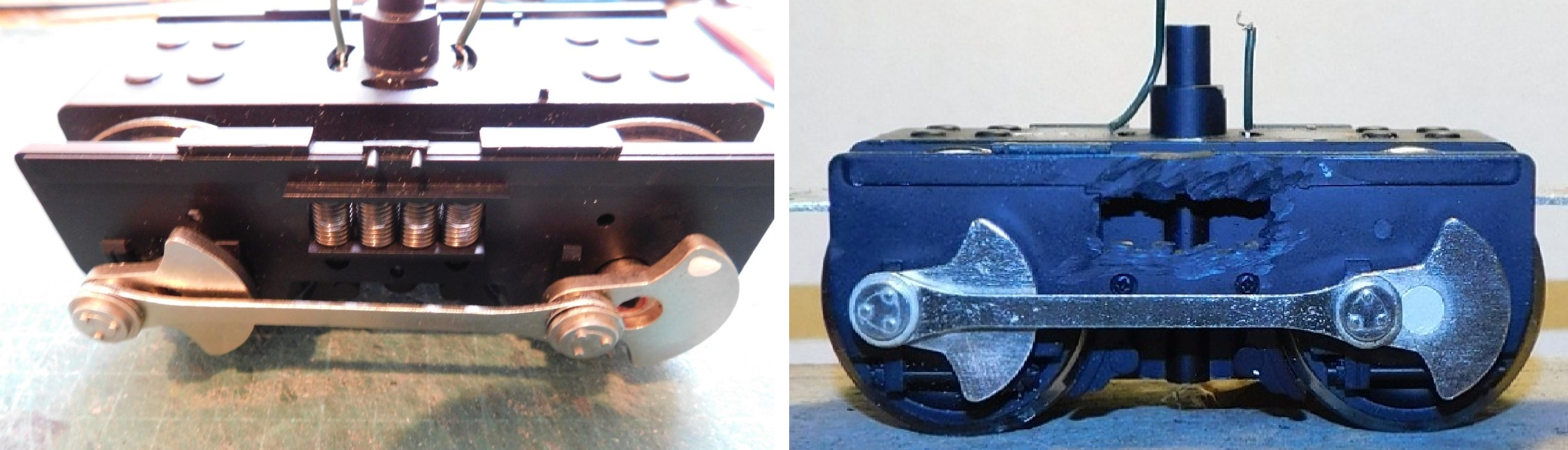

And I thought an outside frame type might be different. So I purchased a Bachmann motor block from a 45t centre cab diesel. One unforeseen problem is that the wheels are quite large – 41mm dia.
Note the metal ‘ spigot’ on the motor block that sticks up.

The outside frames would need to hide the large wheels, but the motor block height at 41mm (?) above rail was a bit high for a small loco. I decided that the baseplate at 43mm above rail could be partly hidden by the side tanks extending below the baseplate as per the prototype.

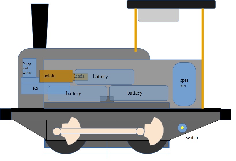

Like all my ‘designs’ the body is designed to fit in all the ‘ stuff’ that I need, and to allow access. Not a prototype to scale. I decided the side tanks had to hold three AA cells on each side of the loco. (I had done some tests and found that 6V would give about 25kph scale speed, so the nominal 7V of 6 cells would be enough.)

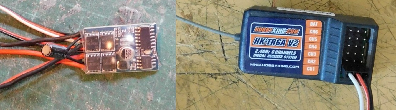

I purchased a Pololu bidirectional speed controller for use with my usual Hobbyking 2.4GHz receiver. This ESC uses a centred ‘stick’ which is pushed up for forward and down for reverse and has to be held in position. This is OK for the short indoor line. (I could remove the stick spring )
These ESC are only about 10 AUD but their limitation is a max voltage of 8V. The esc and Rx are in the boiler front and have to be inserted from the front (smokebox) because of that spigot sticking up. (I cut some of it off)
I make my own sound circuit so I can make it any size to fit anywhere – probably in one of the side tanks. The small speaker will be in the other side tank.
Here is the final design..
I had to cut off bits of the existing ‘diesel looking’ frames and springs, so that the new sideframes I make will slide between the wheels and coupling rod+weights.

I contact glued two aluminium angles to the motor block ends to support the baseplate and to allow me to screw the whole body onto the block, from underneath.
Then I screwed the baseplate onto the motor block and somewhere I had got my measurements wrong. The baseplate was 51mm above rail – much higher than the planned 43mm and it looked horribly wrong!

Compare the prices. Hobbyking Rx+ Pololu ESC maybe 35AUD - less than 20GBP. Deltang in UK?? in Australia ?????
Yes the Pololu do make a high pitched PWM noise. A couple of ways to 'mitigate'
1. have a good loud sound system!
2. Always choose a battery voltage just high enough to give you the top speed you want. That way you are usually operating at close to 'full on' where the PWM noise is low or off.

So after the debacle I decided to cut a big hole in the baseplate to allow it to fit down over the motor block. This weakened the 2mm styrene but luckily the outside frames running the length of the loco have strengthened it.
I also had to pull the glued alum brackets off the block to re-glue them lower them. And all the side tank pieces that I cut out are now wrong size too. Grrrrr.

After much filing I managed to get the new sideframes to clear both the wheels and side rod/weights, but finally I could bench test it with no scraping noise.

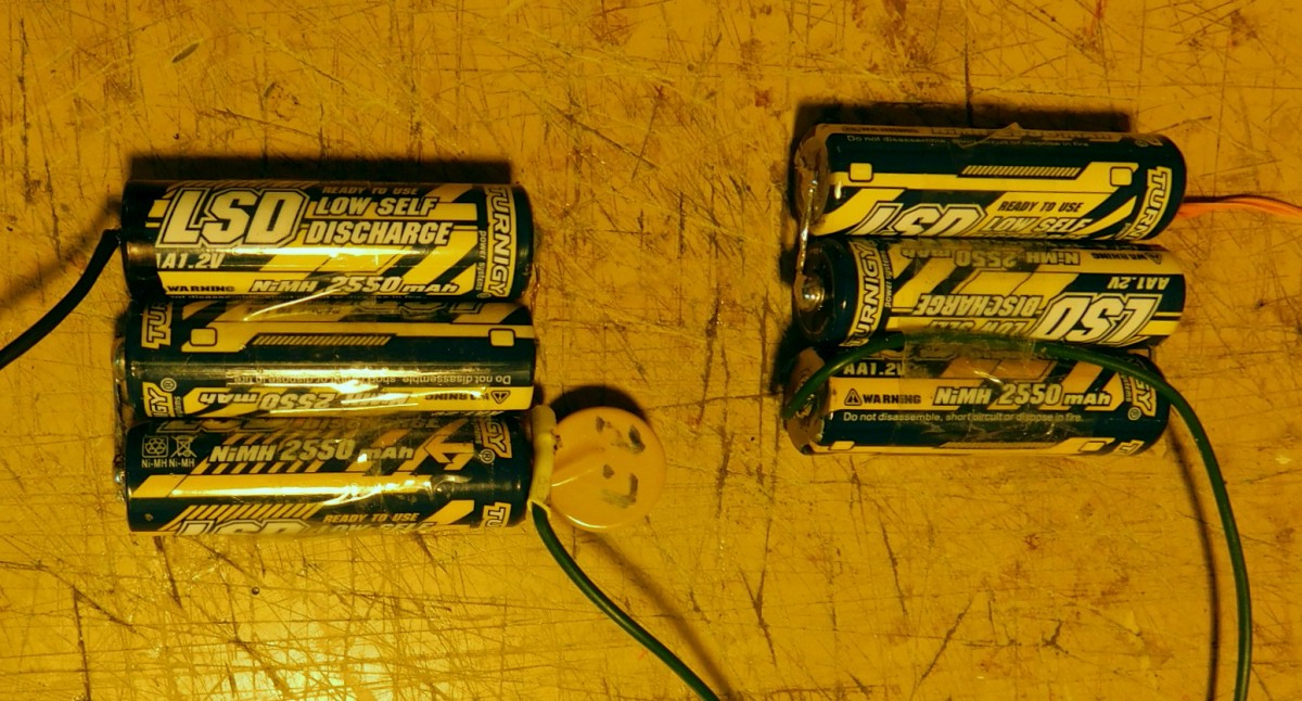

Then it was time to solder the six AA cells together and test the whole thing on battery power with the esc and RC, and all OK! – giving 30 scale kph on 7V.

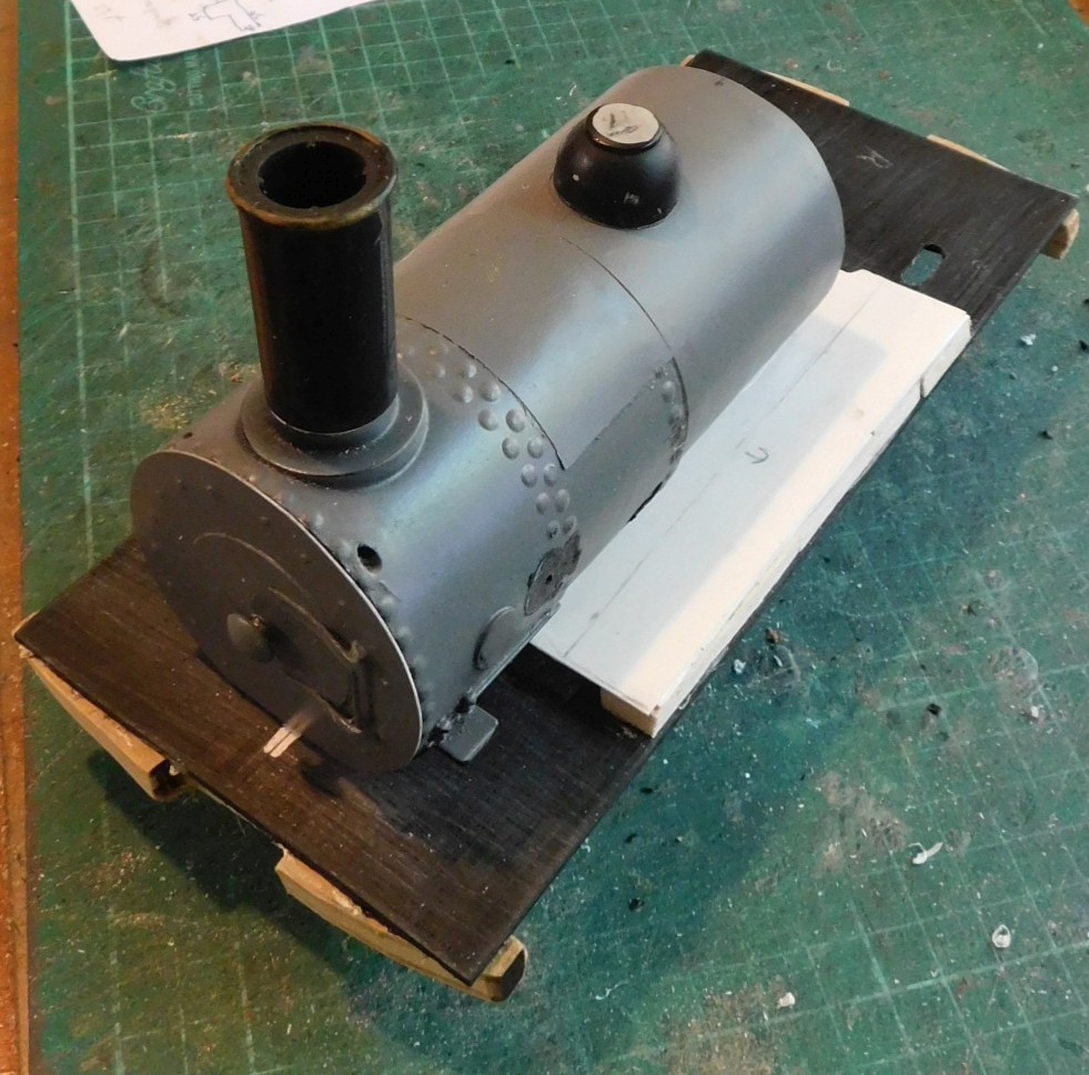

After wasting a week on Picaxe programming, I finally came back to actual modelling.
I found a small dome from some old kitbash and glued and screwed it to the boiler.
I epoxied the boiler to the baseplate, with all the usual hassles of getting it centred on the baseplate, making sure it is level lengthways and that the funnel is vertical.
The firebox backplate is also a push fit like the smokebox, to allow access to the electronics in the boiler.
Then I could start making the side tanks. These had to be ‘deep’ enough for AA cells diameter– ie 16mm internal and they just fitted beside the boiler – for once my measurements worked. They were made from 1mm styrene covered with 0.5mm styrene which had the rivets embossed from the back using a dressmakers tracing tool. I made so many errors in cutting all these out that I began to wonder if I would ever finish this build.
The batteries ( six AA, NiMH rechargeables) were soldered together – 3 on each side of the loco. As usual I solder directly to the cells.
I have enough space in the tanks to be able to put the sound board in one and the speaker in the other (I hope)
By now I have the wiring diagram decided ie where things go and how to connect them and hopefully holes in the right place for all the wires.
Now it’s off for undercoating, so I can do no more work for a few days until it is really dry.
Time to make the sound board..
