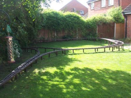

UPDATE!!!!The first 3 yards of track has been relayed with the help of my future niece, Lucy-lou, piccies coming soon
Colinw
"Temporary" track base
Post by Colinw » Fri Jul 31, 2009 9:15 pm
I am due to start track laying tomorrow. The basework can all be removed in a few hours, but should be rot proof, and stay put for many years if left alone. It is built using recycled plastic.
It is re-usable if you move house. Note - no concrete / cement is used, the posts are just driven into the ground - there are enough to resist subsidence providing your garden is stable.
