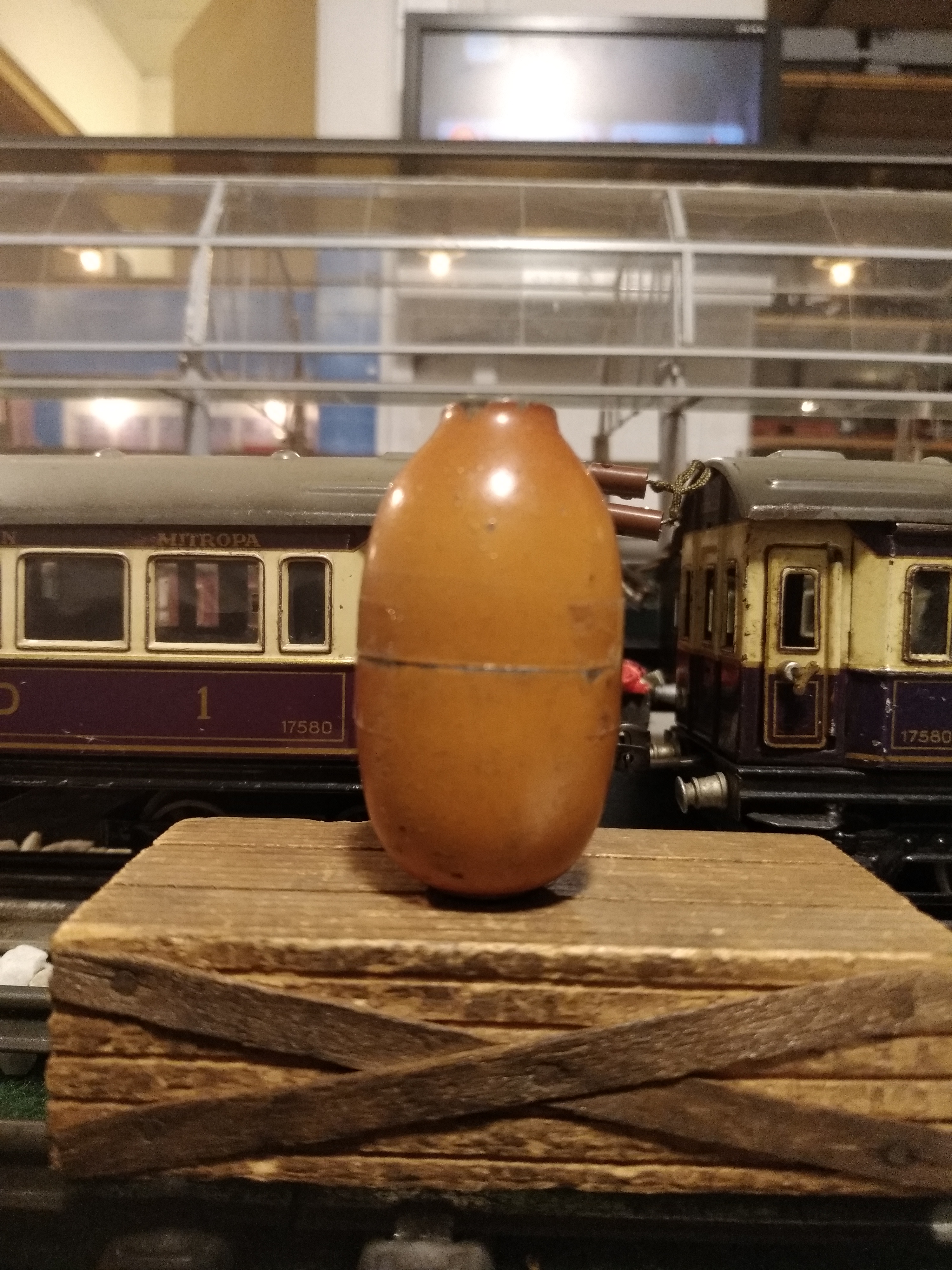

Just kidding, the pot is made up of two halves.
This is an old Märklin acid pot wagon.
I only have one pot. The wagon holds four.
Could anyone draw up a 3D model so I could have some more printed?
Exact dimensions will be provided.

OK, here we go.
It was difficult to measure as the sides are curved.
These are the main dimensions (in mm):
and another picture to show the profile:
I do not need a 100% match. It should just look right from normal viewing distance.
Best regards
Holger

The bottom is not open. The flat portion at the bottom is abt 1 mm high.

To get the curve, I imported your photo into Sketchup and then used the "arc tool" to trace over it. It took a couple of goes to get it acceptable ( to my eyes).
Then I simply joined up the curves with straight lines for the sides and base, so that I ended up with a flat outline of half of the vessel. You can see the black lines on the LH photo on my post above. Next I drew a 9mm radius circle at right angles at the base, selected the edge of the circle, selected the "follow me" tool and clicked on the shape and it instantly rotated it to give the completed vessel.
If you want a more graphical explanation I'll try to do a series of stills.
One thing I should say is that at present it is completely solid, because I didn't want to mess about with hollowing it until I was sure you liked the shape, but that shouldn't be too much of a problem to do before producing the stl's
For printing it, personally I'd try a resin printer ideally, but if you want to use fdm, I very much doubt you would get away with less than 1mm thick walls and you might have to go to 1.5. Having said that, do you really need them completely hollow? Because if they were solid up to a couple of mm below the neck you might have more chance of "balancing" a thin neck on top, if you see what I mean, and painted matt black inside it would hardly be noticeable. I could taper the edge of the neck down to say 0.5 mm but no guarantees that it would print properly, that will depend on your slicer and printer settings, I think.
I know you wanted three of these to match the metal original, but in terms of consistency, you might want to print four and put your original away somewhere for the future, because they won't look absolutely identical.
BTW, do you want an indication of the central horizontal seam, or is that just where the originals are joined in two halves?
Lemme know what you think?

OK, I don't think I can attach an stl here, so I'll put it on the 3D print files section.
I'm not sure about the straightness of the sides, it looks as though perhaps it ought to be a bit more bulbous in the centre? If you want me to adjust it, just say.

First prints were successful.
Pots look good and have the right shape.
Something must have gone wrong during the data conversion as it is too big by a factor of 1.4.
Strange.
Will look into it and show pics after the right size has been printed.
Strange.

Here is the final result.
I had to adjust height and diameter to fit the original.
Still haven´t figured out what the problem was.
Original tin pot on the left, printed one beside, printed and slightly weathered ones on the wagon.
Thanks to everyone who helped.
