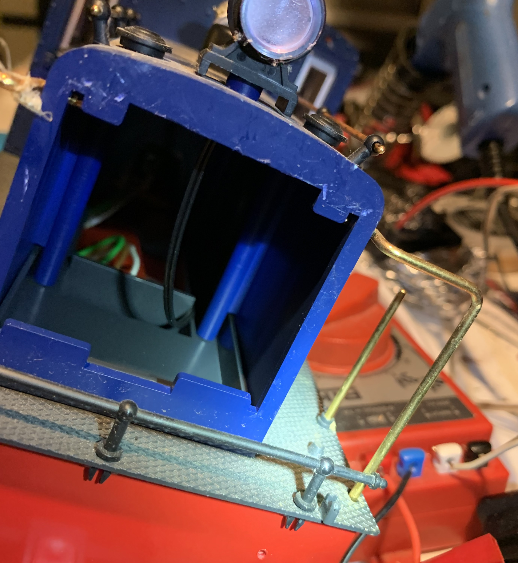

Thanks all for the information. From the PDF file, I could pry to open the panel in front of the locomotive. From there I could see the motor block, and most important to see where the screws that hold the frame to the chassis.

It turns out the screws are blocked from view by the wheels. Basically, the wheels need to be removed first before we can have access to the screws and removing the motor block.

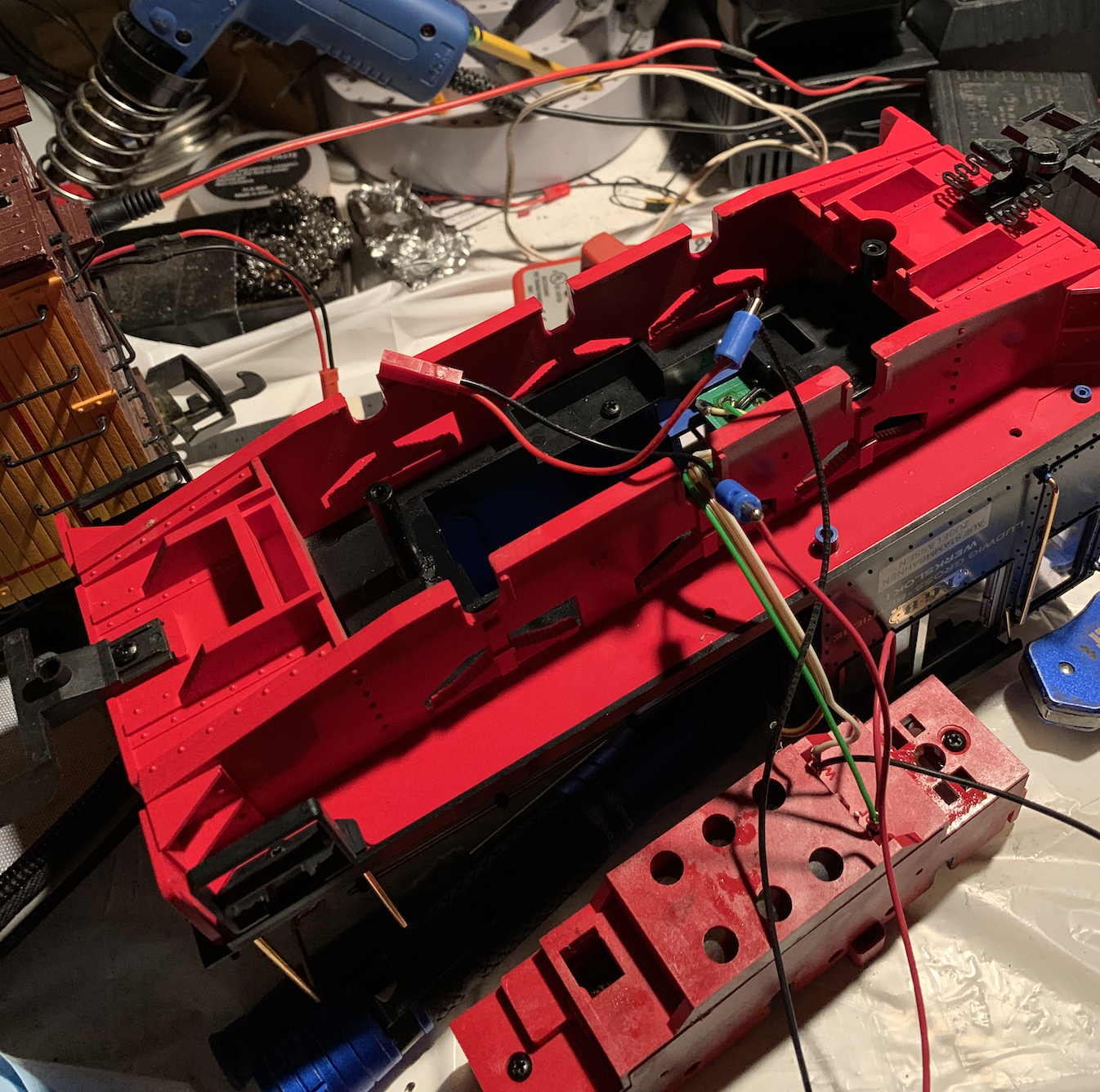

Ludwig Gross Bitriebe2.jpg (1.36 MiB) Viewed 8092 times
As Phil said there are 3 wires on the motor block, white and green are for the motor, and brown is not connected to the motor, so I assume as Phil said, for the track connection.
Now, I soldered wires that link to the motor and connected them to the remote control system. The locomotive runs smoothly now. It's a good experience, thanks.

Have you connected wires directly to the motor, and have bypassed all the other wiring?
I ask as the LGB wiring convention is that white and brown are track, and green and yellow are motor.
You do not want any connection's to the wheels or skates (if fitted). - You do not want power to get from the track into the loco, or your battery-power to get out to the track.
Hi Phil, I am Wellington.
I connected the power wires from my ESC/remot control system to the motor and all of the skates and connection related to the track have been removed. This is probably my 12th locomotive that I wired for battery-run.
