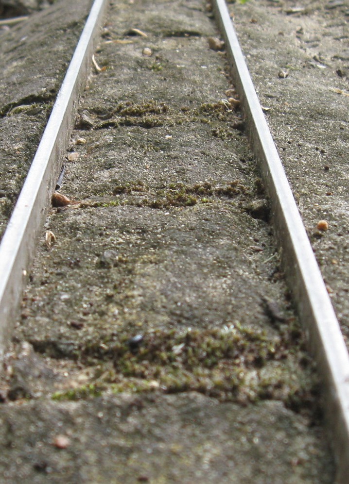

The best way to create flangeway is to do it like The Real Thing with an extra pair of rails. Run a couple of lengths of string between them in the flangeway, and remove the string when the concrete has hardened.

String! I wouldn't have thought of that but I can see how perfect it is for the job. Great tip - thank you.TonyW wrote: Fri Mar 05, 2021 7:22 pm Run a couple of lengths of string between them in the flangeway, and remove the string when the concrete has hardened.

I have two path crossings where the track runs in concrete. I spiked down lengths of rail on the inside, like check rails, and simply infilled between them with mortar. I wouldn't use wheel flanges to create a groove, even that specific wheelset will rub and wear as it runs through, and any others which are fractionally different in B-B will cause perpetual derailments.Ensign Elliott wrote: Thu Mar 04, 2021 10:02 pm

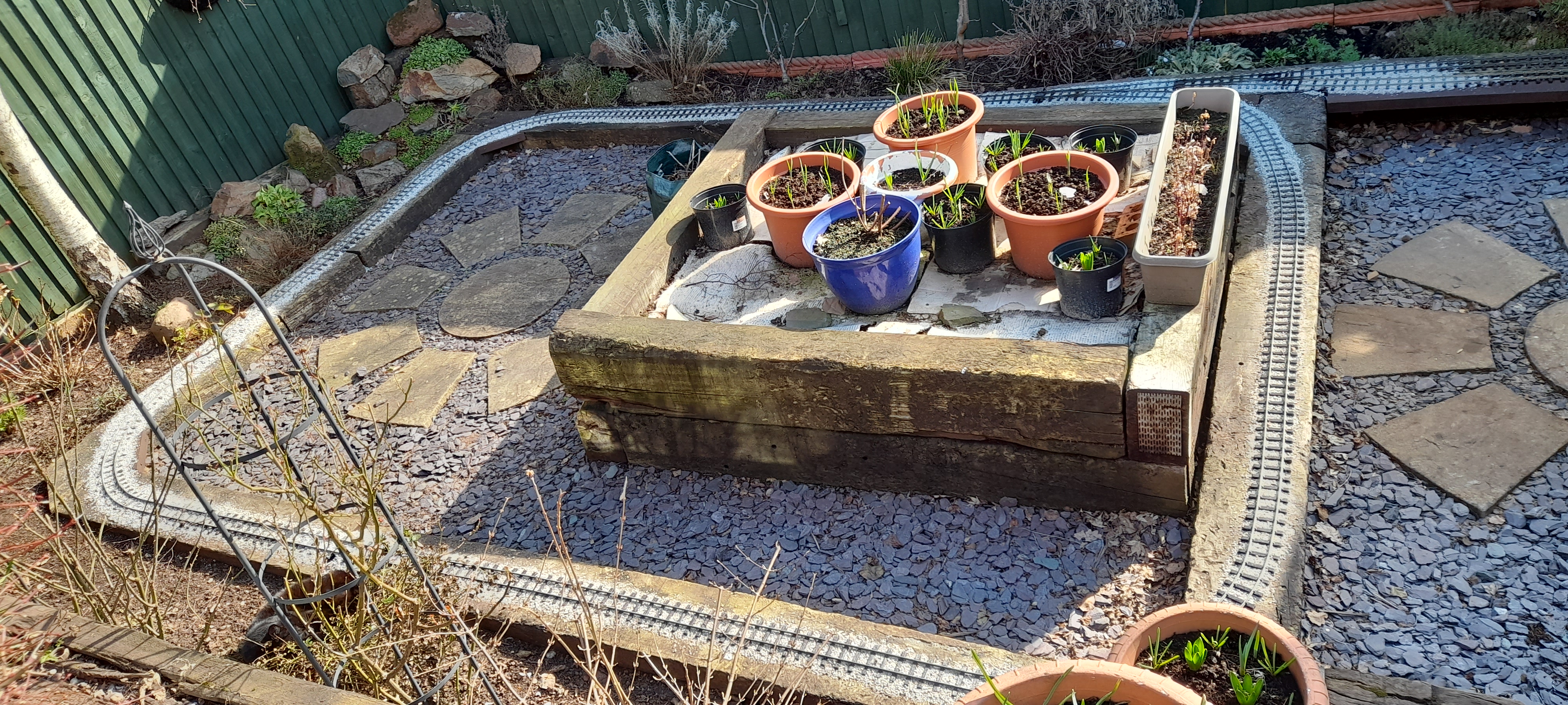

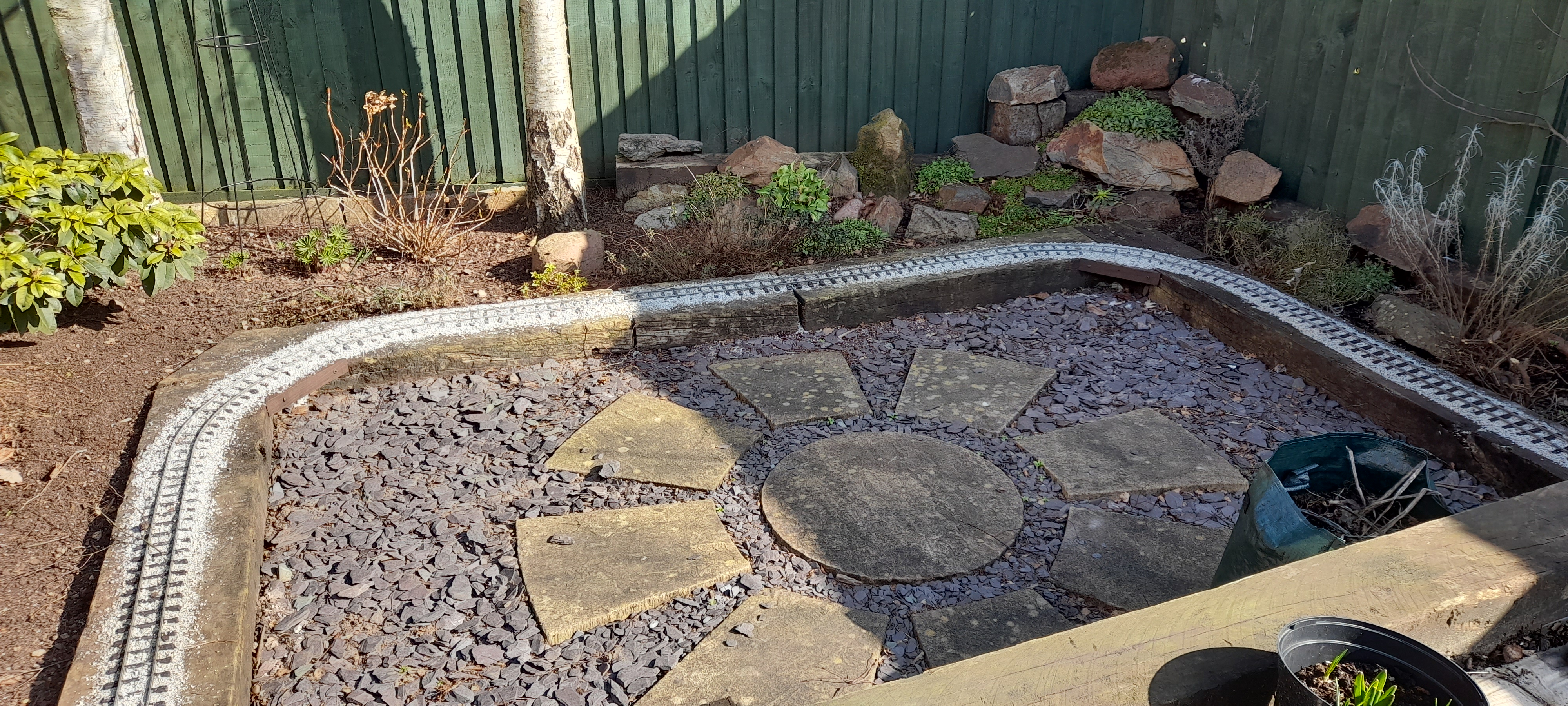

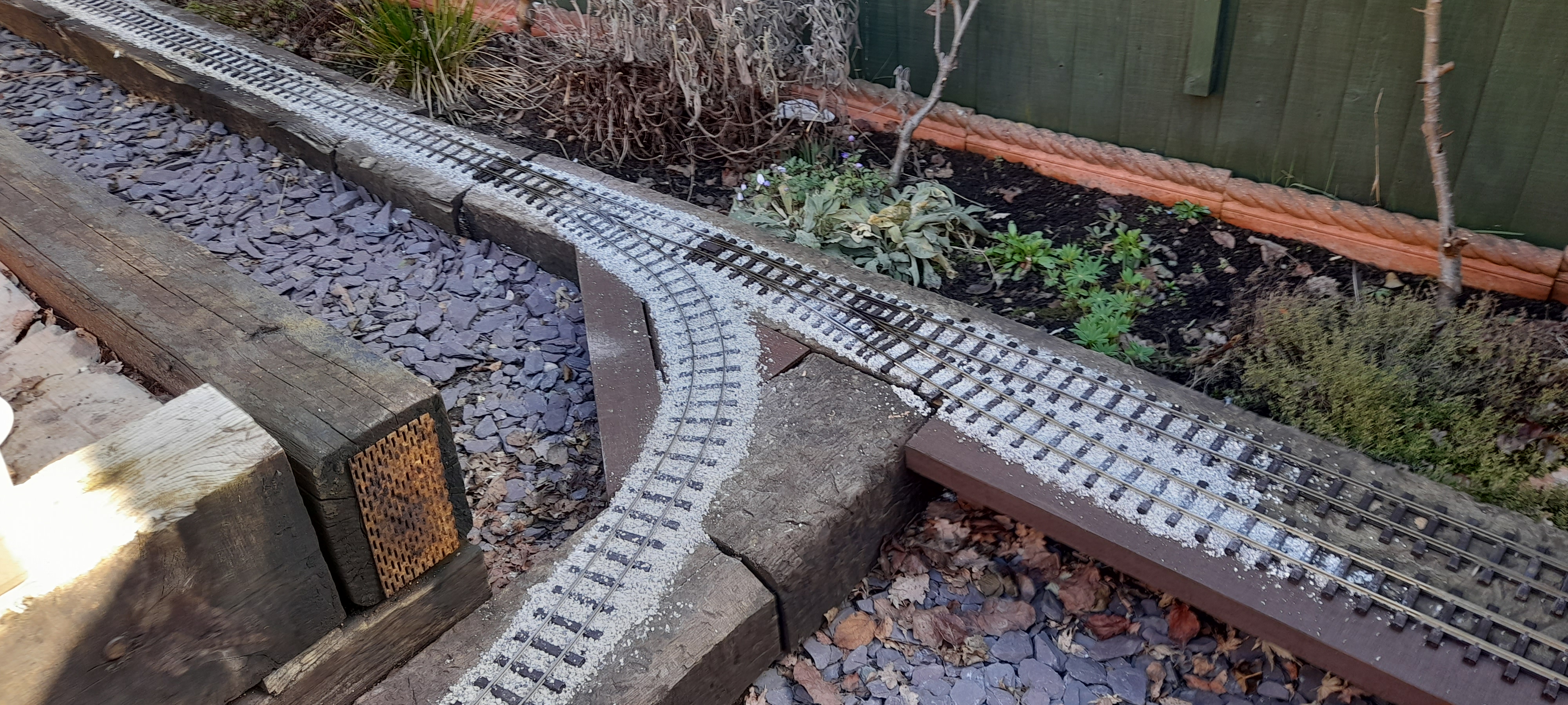

Some pictures attached of the current set up. Nothing too fancy, just a circuit of single track with a spur off to what will become a shed and loco maintenance area. I may put in a loop over the far side where I hope to put a station area. I'd also like some WR signals. I'm an N Gauge modeller so all this G Gauge stuff seems massive!

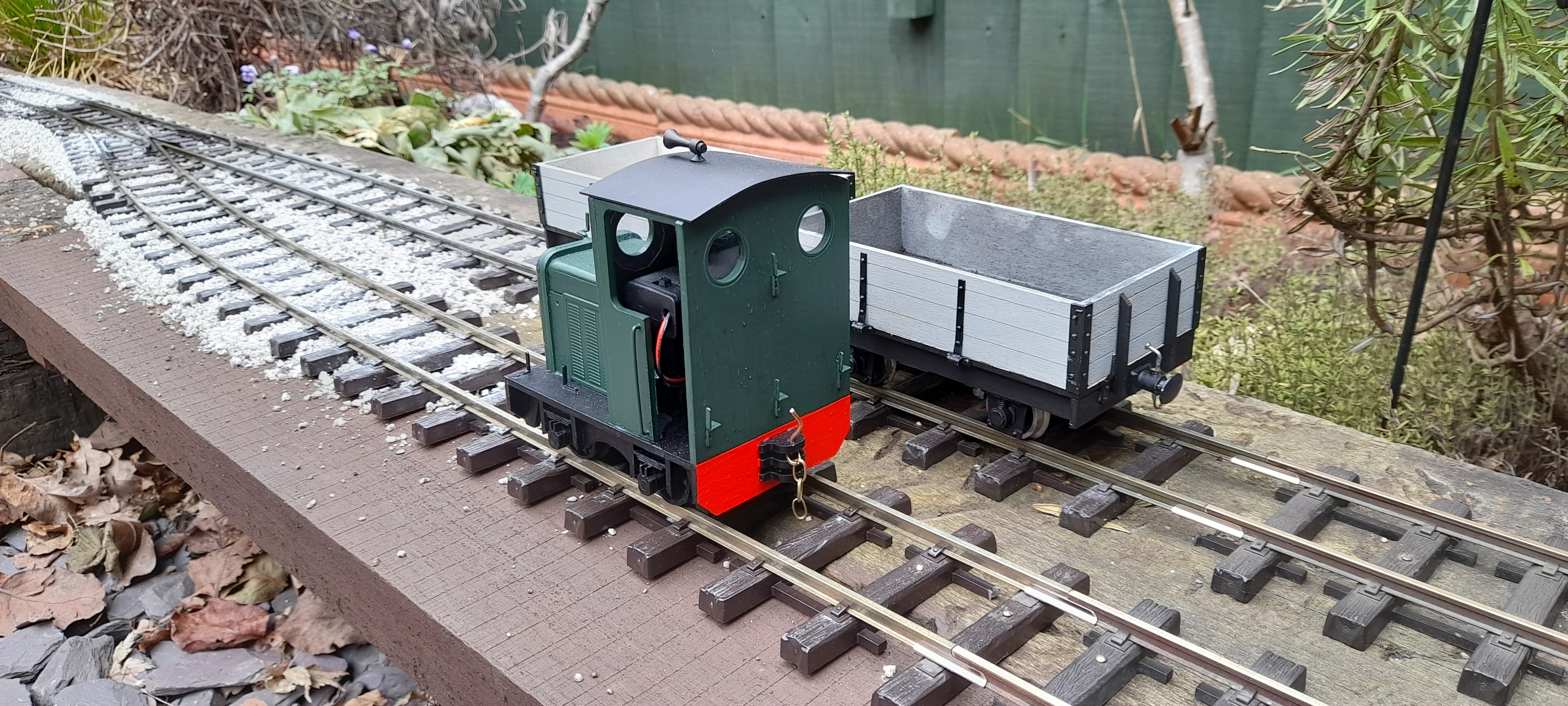

I've got a little IP Engineering battery powered shunter along with a few wagons which I got to test the track and have a play. I've got the Roundhouse Millie on order which should be arriving in May so I'm very much looking forward to that.
Thanks again all

More pics

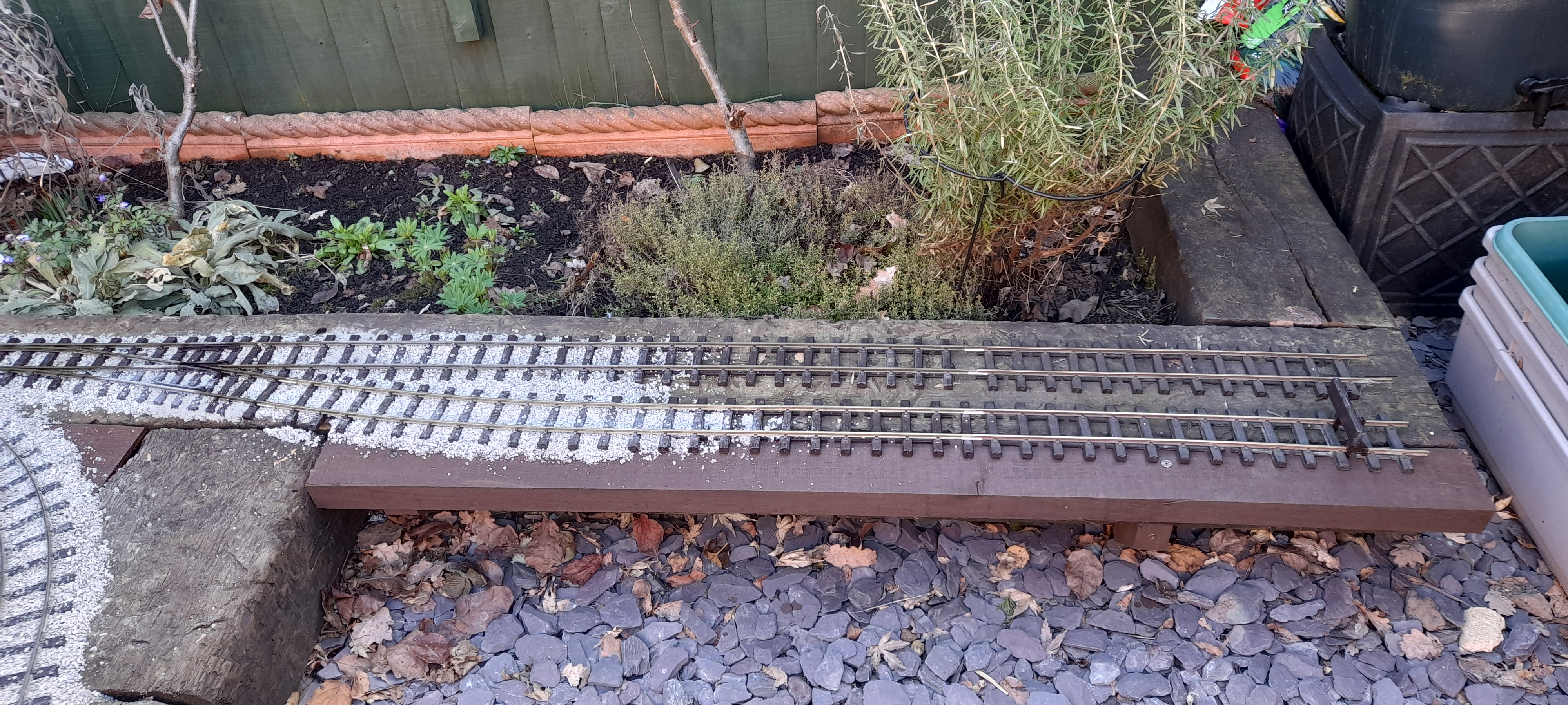

Loco and wagons in shed area which I hope to concrete over.

That's a promising start - I like the battery loco too.
Just a thought, but you might want to consider increasing the clearance between the two sidings before concreting? It could just be that I'm used to the spacings for 32mm track, but I wonder whether you might have trouble if you get any wider stock?
I look forward to seeing your Millie in action on the line - it sounds like it will be one of the last to leave the factory?

I agree with Andrew, it's looking good for starters. That little loco is a nice job.
I also agree with Andrew on your track spacing. It's difficult to be sure what you currently have, but as a rule of thumb you really need to be thinking in terms of around 150mm centre-centre, on adjoining tracks. Most rolling stock is around 80-90mm+ wide, unless you are planning on quarry/mine working.

Thanks - the gap seems plenty wide enough for the the wagons but I'm not sure how much overhang the steam loco will have so definitely something to bare in mind.

A Millie is 108mm wide but a Lady Anne is 125mm wide and of course overhang increases slightly on curves.Ensign Elliott wrote: Wed Mar 10, 2021 10:33 am Thanks - the gap seems plenty wide enough for the the wagons but I'm not sure how much overhang the steam loco will have so definitely something to bare in mind.
