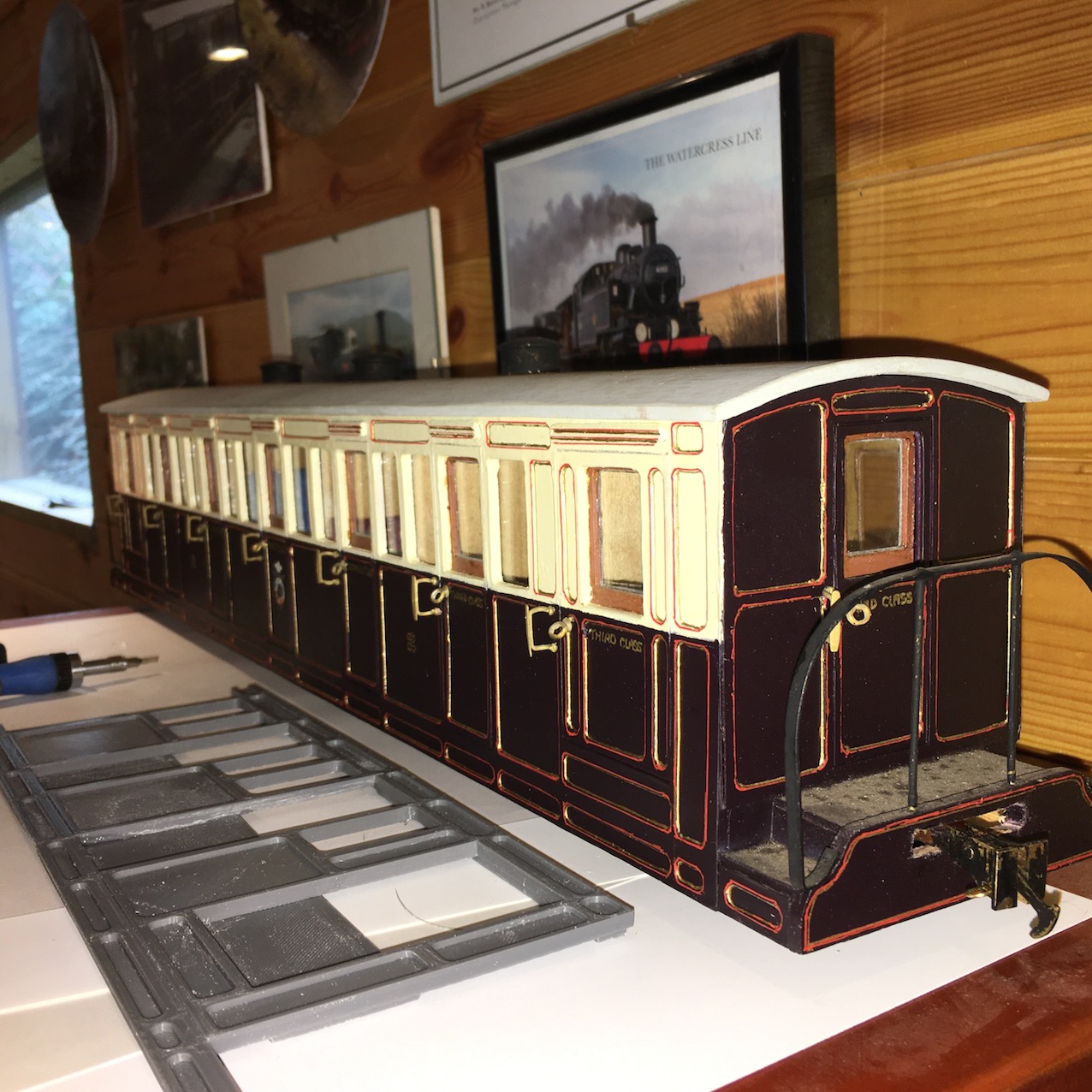

This is coach 15, so you can see what I am creating:
The prototypes are long bogie coaches - and they are supposed to have been the first narrow gauge bogie coaches. The end balconies were provided for passengers in the Birmingham 4 wheel coaches (sometimes known as Bug Boxes)which were also part of the train. Those 4 wheelers have longitudinal seats so passengers standing on one side of the coach may need to get to the other side of the coach to find a seat. When the bogie coaches were introduced the balconies enabled that to happen.The end compartments are odd as well - the doors to them from the side are shorter - because the floor is raised at the ends to accommodate the bogies. If you have to crouch going through a door it has to be wider - and that explains the wide doors in that compartment. Although those doors were only intended to pass luggage through, because the removable seats blocked those doors. The doors in the end compartment were to allow passengers to get into those end compartments when the seats were in place. It seems that the first class passengers servants and luggage were to go in these end compartments. I wonder if they were ever used like that?
So another particularly quirky coach!

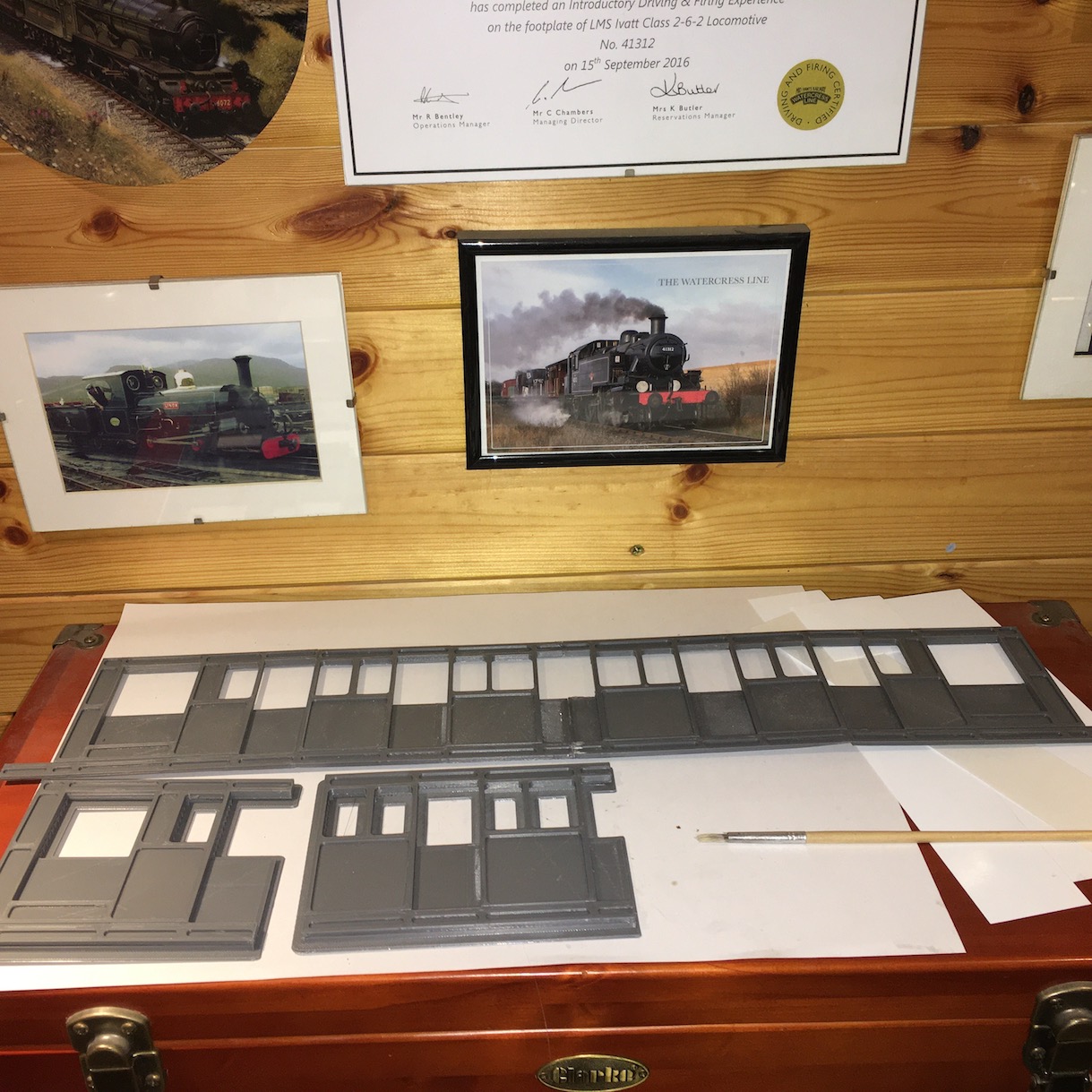

So far I have most of it designed. Luckily these coaches are symmetrical. So half of one side suffices for both ends of each side. It just needs that half side to be inverted for the other end. Due to the size of the printer bed (150mm x 150mm x 150mm) I have to print each side in four parts, two parts not inverted and two inverted.
Here is the first half side shown against the model.
Note that the three joints in each side are placed to be in the doorways, and the doors are going to be printed separately. the screwdriver blade points to the join in this. You can see that it is on the edge of a doorway - so I think it will be well hidden. The joint in the centre is in the middle of the first class doorway, so again there will only be short sections top and bottom visible.

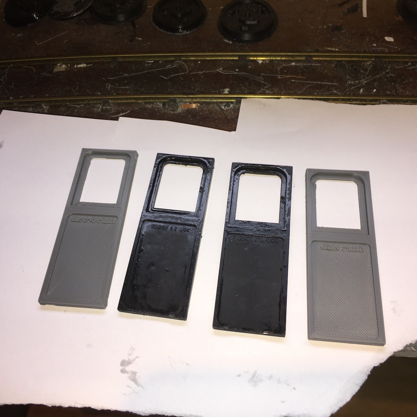

Both sides and ends are now printed and I have been experimenting with the doors. I was taken by the idea of printing the "third Class" etc onto the doors as they printed.
So I have tried it on both the filament and the resin printer and the results are here:
There are two (really three) things to say about them. Firstly you can see the black doors which are from the resin printer, and while the words are clear (readable) on these there are parts of the letters which just have not printed. The grey ones are from the filament printer and the letters are complete (but a bit thicker) and less readable than the computer generated text. Note how there is a difference in the way the framing has printed out. In the grey ones the bottom and top framework is the same width as that on the sides (as per the Cad file). On the black ones the top and bottom are significantly narrower. Perhaps less importantly the black ones have a better surface finish, but are less level where I have failed to wash the surplus resin off the door before the UV got to it.
As far as the text goes I think the issue is the font I have been using - Times New Roman - which seems more "Victorian" with its thick and thin lines and its serifs. The issue seems to be that the thin parts are too thin to print in text this small. Well that is all I can think it could be, and repeating it with bigger text did improve things slightly (compare the 2 black doors). I had a similar issue with the makers plates for Welsh Pony.
So I think I will stick with the filament printed doors!

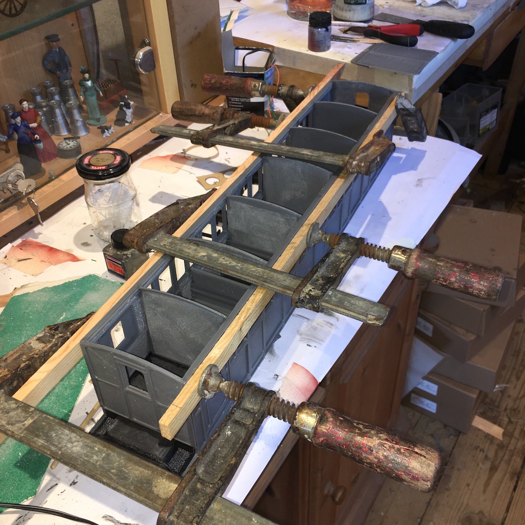

I have the end walls made and fitted, and am in the process of fitting the "bulkheads" which divide the compartments. The information I have is that the bulkheads in the 3rd class compartments were not to roof height, but in 1st and 2nd they were. However it seems illogical not to make the end compartments walls full height as they were intended as luggage compartments (or for servants of the 1st class passengers)!
So that is how I have built it:
I have used the clamps to hold the sides parallel which the glue hardens (or solvent evaporates) which is more accurate. One down side of making the sides from 4 parts has been the tendency for the glue lines to move as the solvent evaporates. I held them flat for 24 hours but obviously not for long enough or firmly enough. So the clamping arrangement in the photo is intended to flatten any kinks after softening the joints with solvent. I am going to leave them in place for longer this time.
