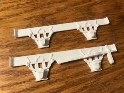

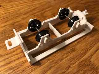

I've been working on a 'lego wagon' for my sister's children. I bought them the Tesco 'Caterpillar' trainset last Christmas as a cheap way to try to get them into garden railways, with a couple of open coaches for Playmobile people made from The Works boxes to combine it with their existing toys. In which spirit, I thought I'd make them flatbed wagons this Christmas, with a Lego top, so they could build their own superstructure, and my 3D printer arrived a just the right time!
I think I can use the sole bars from Rik's Southwold van for the wagons to save me designing those (thanks Rik!)
Initially I thought they might be too breakable for the youngsters, given the nice details, but they are suitably robust!
However I needed to create custom buffer beams - with couplings compatible with the Lego train... For this I started using TinkerCAD which has a remarkably intuitive interface for a 3D drawing package.
Unfortunately due to the dratted virus I cannot go and check whether the rather sketchy notes I made about the Tesco couplings are accurate...but fortunately I will be able to reprint them if the kids tell me they're too high or too low.

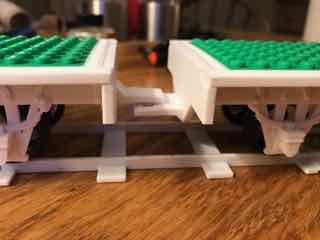

But of course the main feature is having a 'Lego' surface to the wagon, so I've been playing with Lego from Thingiverse, which has lead me into discovering parametric 3D designs...
Thingiverse has a 'Customiser' which allows you to specify exactly what brick you would like (I'll have a 4x1 or a 2x2 or whatever) and then generates it, based on SCAD files rather than STL files. Unfortunately, the customiser does not appear to work... It just put my requests in a queue where they remain unprocessed. Fortunately, it appears you can do the customising on your own computer - by downloading OpenSCAD, the programme for making the SCAD files, and using the customiser within that. Pretty soon I'd exported and printed some bricks, and figured out that a plate of 10 x 18 would be a good width (80mm) and a good match for the length of the solebars...
Unfortunately my Lego bricks were something of a wash out. They didn't clip on to each other, and worse the plate was uneven with a poor finish. One of the pips even broke off...
...and if that happens when I'm handling it, it won't stand up to the kids. By the look of it, the whole thing moved during printing (poor adhesion?) but it takes a while to print, and given the brick quality, I've lost some confidence. So I've hastily ordered some real Lego, if necessary I will incorporate it into the wagon. As I understand it, it is ABS and so should bond quite well with an ABS-printed frame...

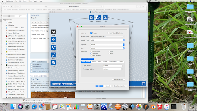

Just some thoughts on your lego prints. What you are trying to achieve seems to me to be pretty advanced. No criticism intended - just trying to analyse why it hasn't worked.
The potential forces on lego bricks are probably pretty high.
So some things to try:
In the print dialog box of Flashprint there are lots of options. This is the print dialog box:
I clicked the more options button.
Now the options include: Shells - this is about how many solid layers are on the top, bottom and the sides. Phillip has suggested that it can take 10 solid layers. I wonder if it needs to go even higher to make the pips solid - 20?
Now the infil option: You will see that I am using 40% as my standard infil rather than the default 25%. You might want to go higher - to increase strength.
Bear in mind that filament printed "things" are always weakest along the level layers where they are printed. One way of increasing the bond between the print layers is to wash the surface with acetone (if you are printing in ABS which I am convinced you are).
You hinted at the possibility of bed adhesion problems. I think if the movement is not in the first layer of the print then that is not the particular problem you are suffering. Assuming that the print jumped somewhere while printing the pips it isn't adhesion. Something has caused the printer to lose its zero settings. I have found that can happen if something hits the extruder - why that might happen - don't know. I have had it happen. One thing to look at is the way it prints. When you have generated the print file (.gx) you get this screen:
You can see what is going to print by moving the slider on the left up and down in the following view.
moving that slider lets you see just what it thinks it is going to print. It can reveal surprises!
Bed adhesion. I can be a problem with ABS. I have suffered it! You will know you have it when the corners of prints come off the bed. So in the case of this wagon frame printed up side down the top surface would be curved. The first thing to do if it happens is to clean the bed surface with alcohol (meths). If that isn't enough clean with Acetone - but careful we are getting into an area where getting the print free becomes an issue. If all else fails mix some ABS offcuts into a small bottle of Acetone shake it up until it has dissolved and clean the surface with this. Beware - you will have problems getting the print off the surface if you do this.
I don't know if you are using a raft - but I do find it gives the best results with large items like the bed of a wagon (lego or otherwise) even if it is wasteful. Using a raft is less wasteful than keep trying to print without one.
Hope some of this helps.
PS for everyone else it seems a bit printer specific but it might still be of interest!

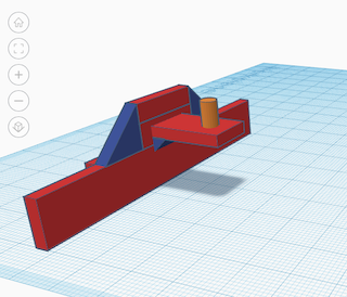

I can give you access to the original TinkerCAD drawings if you want, Simon. Just drop me a PM.SimonWood wrote: Tue Dec 15, 2020 6:32 pm I think I can use the sole bars from Rik's Southwold van for the wagons to save me designing those (thanks Rik!)
You could then copy and paste my drawings into new designs of your own - and then change the dimensions, remove or add parts as you wish. You can also see how I went about the making all the bits (by ungrouping the various components).
I tend to over-engineer the parts I draw - firstly to make them more robust in the rough and tumble of the PLR, but also to make them easier to print. For example, rather than a thin bar floating above the solebar and W irons, you'll notice that the brake lever descends all the way down to the print bed. I reckon that will hardly be visible when it's on the track, but it makes it far less susceptible to damage.

Thanks everyone for the advice here - especially confirmation that incorporating a real Lego plate was the way to go...
(Unfortunately the Duplo plate did not turn up in time, so the youngest gets his late... but since he's too young to have serious expectations of Christmas - last one was a third of a lifetime ago! - I expect he won't notice...)

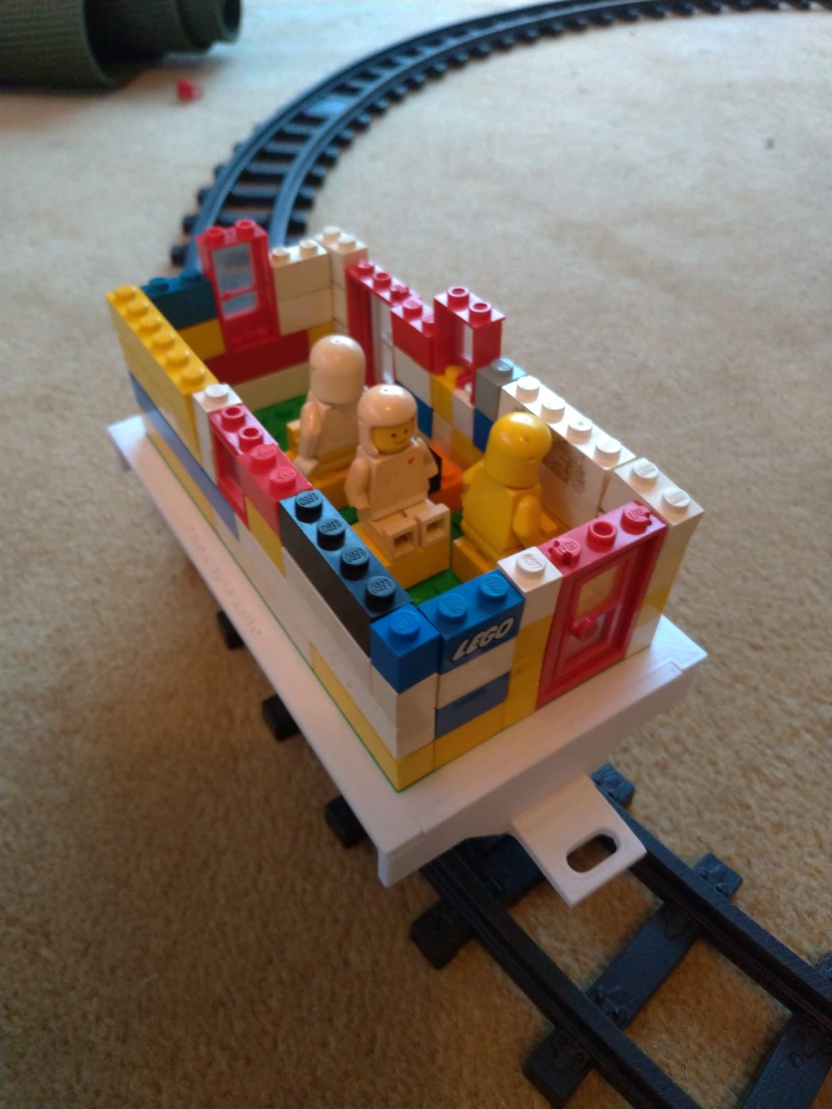

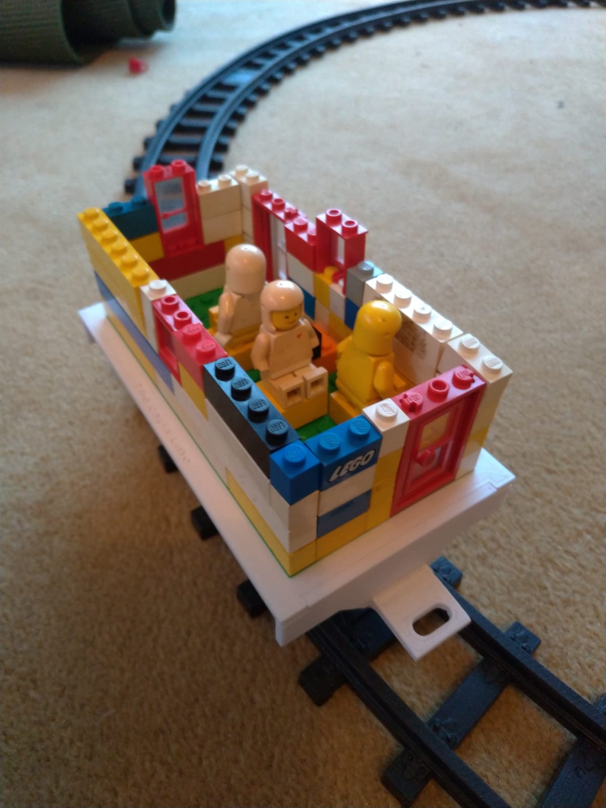

The Lego wagons arrived in time for Christmas and have formed the basis for some smart new coaches already...
Whilst the wagons with their short wheelbase run well on the Tesco track, and couple to each other without issue, they don't play well with the Tesco train. The reason for this is that the Tesco wagons have a long wheelbase, and to compensate for this, although they are 4-wheelers, their axles are mounted in... can we call them bogies if they are a single axle? Or are they 'trucks' (like on a skateboard?) Anyway, the coupling is fixed to these bogies, designed so that the coupler pulls the wheels in on the curves... But coupled to my wagons, with the fixed couplings protruding from the buffer beam, the coupling is held out and the wheels are unable to follow the curve causing binding and if not derailment then loco wheel-slip.
So I need to design a new swivelling coupling...
