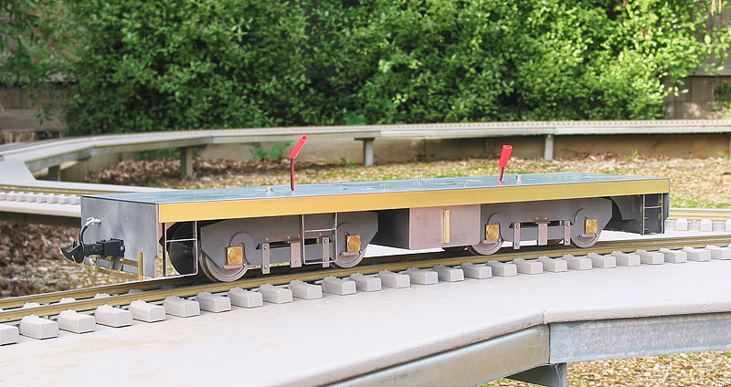

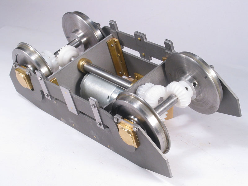

The first part of the project was to build a powered bogie, as there's not much point in continuing if this bit didn't work. The design did work and the basic mechanicals are shown in the next two photos. The motor is a Pololu with a fully enclosed gearbox and the final drive gears are standard 0.8 Mod acetal bevel and pinion gears. Much of the design delay was looking for a way to couple the two axles together. Suitable small chain was difficult to find and expensive when found.
The eventual design was based loosely on the Mk1 power bogie used by Tri-ang back in the mid '50s. The bogie design only worked because the gauge is 45mm and the prototype bogie had a long wheelbase. The clearances are tight, so it would require major changes to be usable on 32mm gauge. The motors had been in stock for several years for another project and when I dug them out it turned out that I had ordered too high a gear ratio, so the pinions driving the layshaft have a ratio of 1.5:1 to increase scale speed to a reasonable level.
Walkers 3.jpg (88.31 KiB) Viewed 13842 times
Walkers 4.jpg (86.44 KiB) Viewed 13842 times
Once one bogie was assembled and bench tested, it was a quick job to make up the second one. They were fitted to a temporary plywood chassis, with a battery pack and a couple of switches to confirm the speed calculations and ensure they would run on the layout without problems. The test lashup is shown in the next photo. during a test run. Using eight elderly NiMH cells gave a max running speed of 20 scale mph, which is what the bogies were designed to do.
Walkers 6.jpg (140.23 KiB) Viewed 13842 times
So, now that the mechanical design is tested and working it is on to the chassis. The design is simple enough, steel plate for most of it, with brass angle for the side sills and assembled with rivets instead of soldering. I'd have preferred an all steel chassis, but couldn't find a source of 1/2" x 1/16" bright steel angle locally. The next photo shows the completed chassis testing clearances out on the track on a cold wintry day.

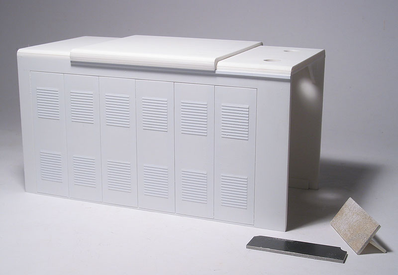

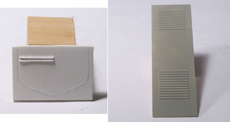

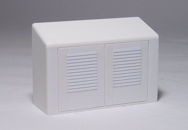

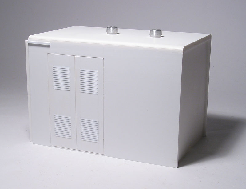

The first issue was that the chosen prototype had a very liberal supply of louvres scattered over most of the body access doors, so that was the starting point for body construction. The next photo is a composite and shows the first attempt at louvres on the left, which didn't work and the second method on the right that did.....
Louvre tests.jpg (56 KiB) Viewed 13842 times
The first method is one I used in the distant past in HO. A sharp chisel is pushed into the polystyrene sheet to raise a louvre, then step and repeat. This was going to require a jig of some sort to line up the louvres and ensure even spacing. Even with all that, the edges can still be ragged and with something like 500+ individual louvres to make, this wasn't a very good idea.
The second method I've also used before in HO and involves insetting a louvred panel into each door panel. Luckily Evergreen make a suitable sized weatherboard sheet and I had some in stock, so this was the path forward. The photo is a test piece and you can just see the joints where the door has been assembled from various size strips, in much the same way as a traditional wooden louvre door is made.
The next photo shows the body section assembled, which is the short hood in front of the cab. Tedious, but the construction went well. The body is heavily constructed as a box laminated up from 2mm plastic and is 4mm thick in most places. This gives enough thickness for the corners to be easily rounded without reducing the strength of the assembly.

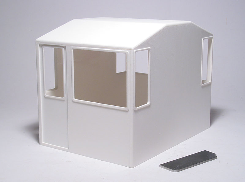

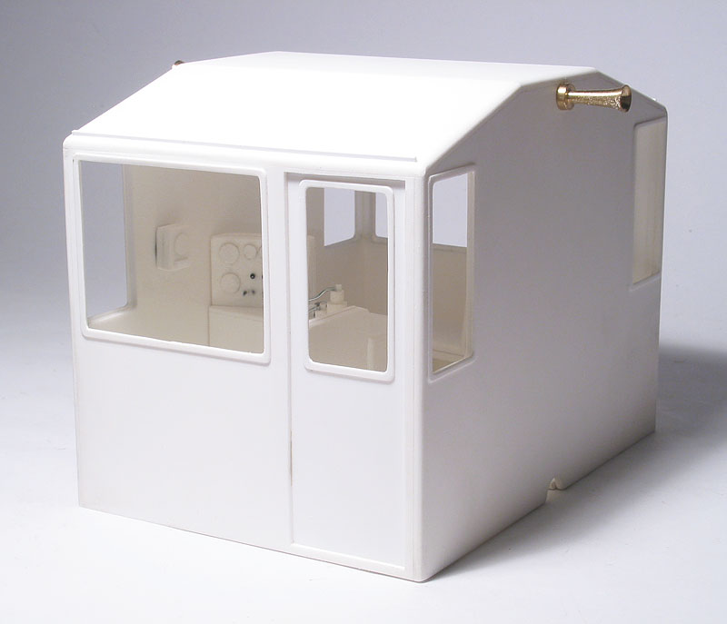

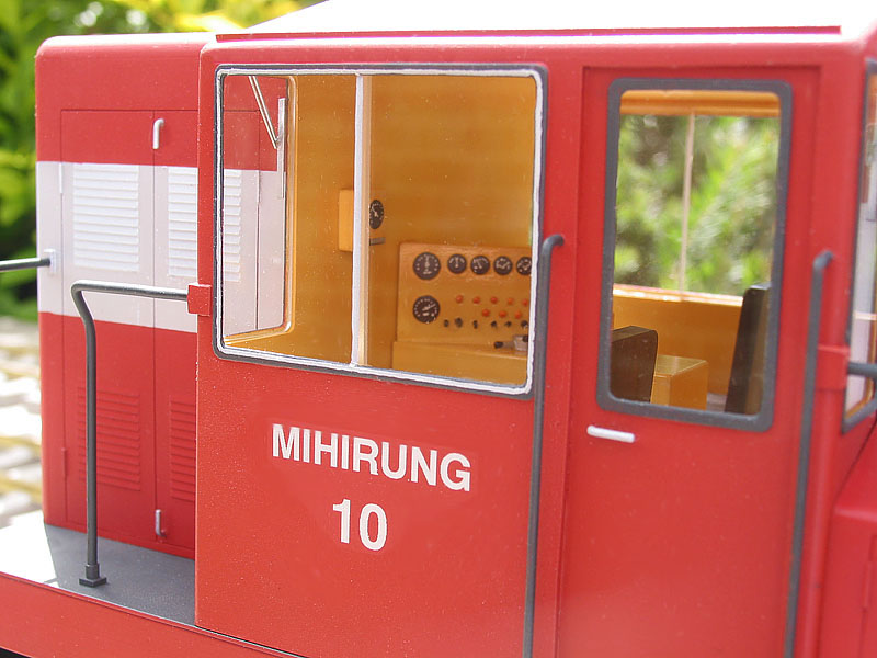

The cab windows on the prototype were large and some sort of cab interior was called for. I couldn't find a decent photo and in the lockdown the preserved ones were out of reach, so something typical based on a later loco from the same builder was knocked up out of scraps to fill the space. It is fitted separately to the underframe so that the interior can be accessed if necessary and the photo below shows it installed in the cab.

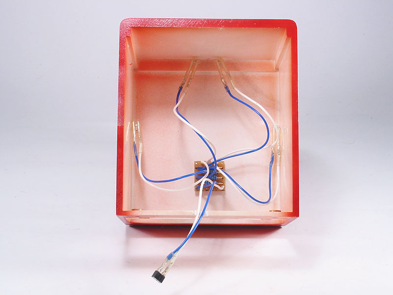

The model is fitted with working headlights and marker lights powered by the ESC. The next photo shows the wiring arrangement inside the front hood. The resistors for the LEDs are fitted to a small pc board so that only two wires need to be run into the front and rear hoods instead of eight. The plug on the input wires is so the body can be easily dismantled for service as needed, without resort to a soldering iron. There are other plugs in the wiring, including the bogies for the same reason.
This model fought hard all the way and there was a lot of light leakage from the LEDs, which showed through the bodywork when in the dark. This was finally cured by fitting the LED in a brass tube to stop light passing through into the bodywork and using a thick coat of silver paint to stop light leaking from the back of the LEDs lighting up places in the body not intended to be lit. I've found silver paint better than black paint at blocking light, but either way takes a lot of paint to be light tight.

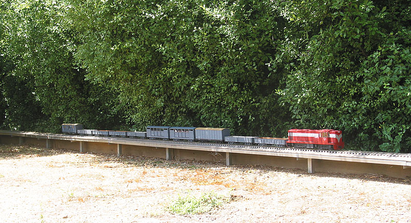

The weather was still too bad for painting at the time so I got on with other things until I finally ran out of excuses and started the long fight to paint the model.

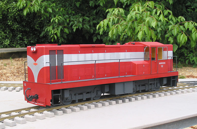

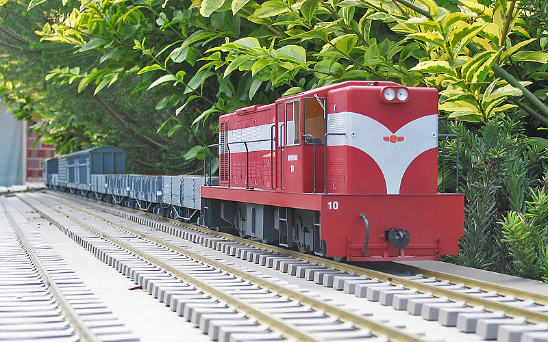

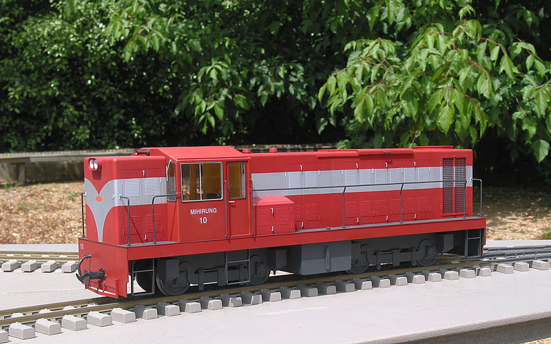

The last photos show the more or less finished model sitting for its family portrait, and yes I still hate modern paints.......
The livery is based on the first colour scheme used on the Clyde-GM G8 and G12 diesels that ran on the BHP owned Iron Knob Tramway from the Whyalla steelworks to the iron ore mines in the Middleback Range in South Australia. It's a variation of the common 'bow wave' colour scheme used on '50s EMD diesels.

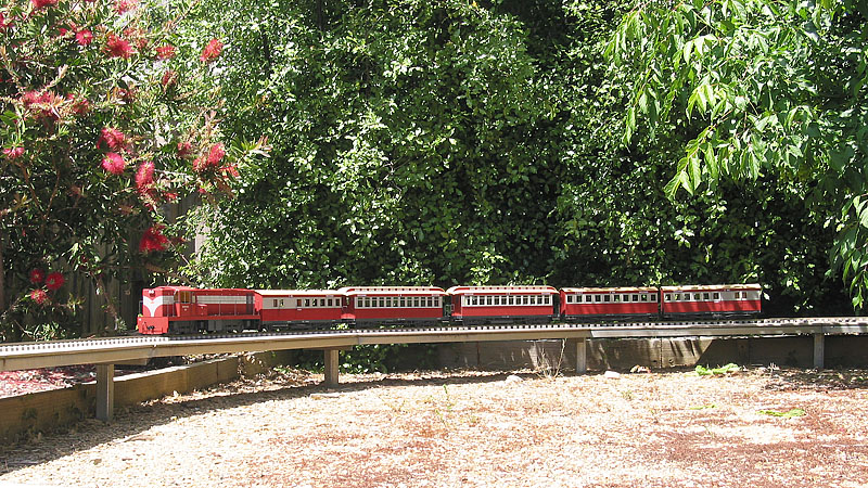

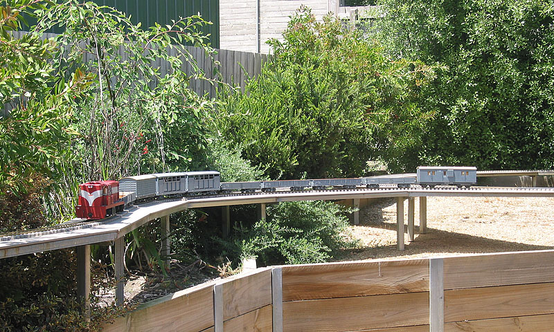

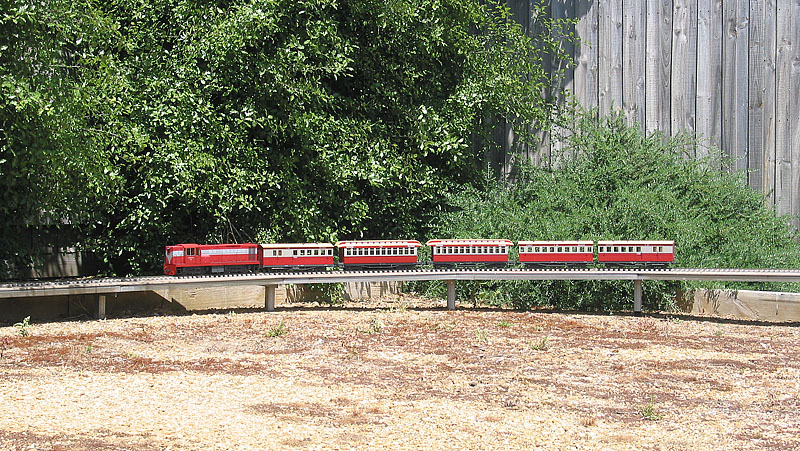

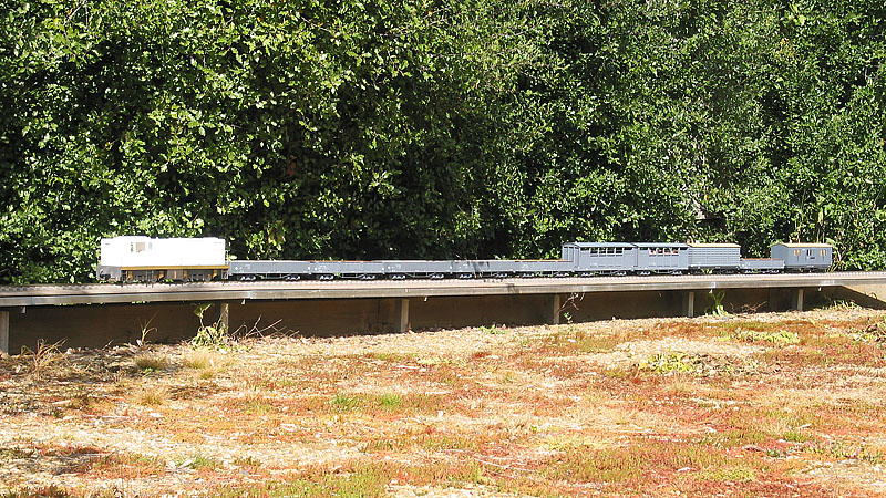

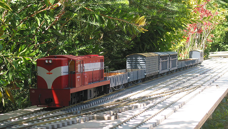

With the weather improving here the latest TVT motive power has entered service, taking the line into the diesel era.
The loco model is pretty well run in now, but a passenger train was chosen for the first run instead of going straight into goods service, as the Walker railmotor is still awaiting some modifications before re-entering service.
The first photo shows the train at the start of the run, heading through the s-curve leading to the wye junction and the main line.
Eighth Run-1.jpg (277.87 KiB) Viewed 13291 times

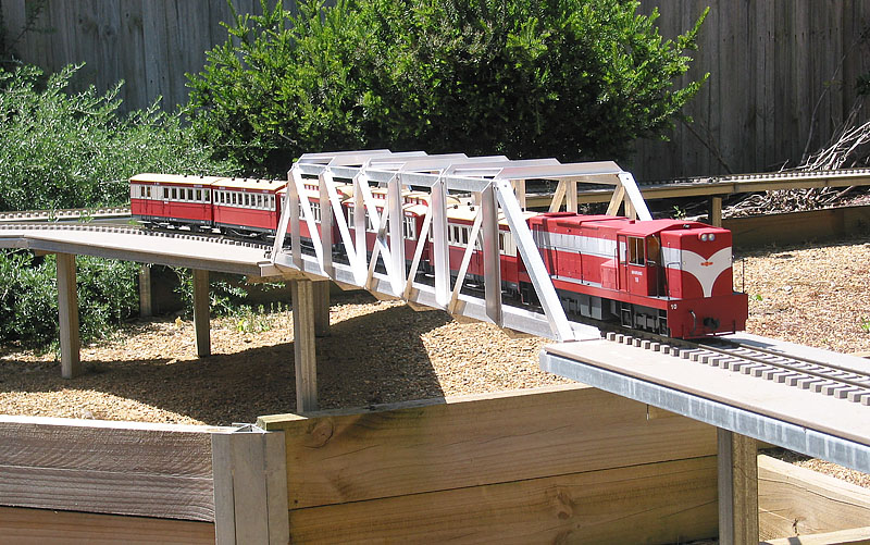

Having turned south at the junction, the train is now accelerating off the bridge and heading over the river flats.
Eighth Run-2.jpg (202.14 KiB) Viewed 13291 times
The next photo shows the train passing around the curve at the southern end and about to enter the long straight.
Eighth Run-3.jpg (258.43 KiB) Viewed 13291 times

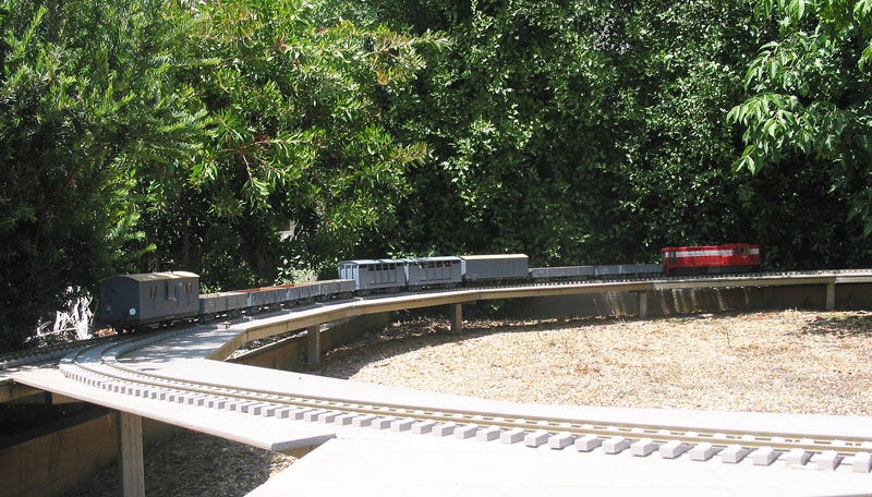

The Pittosporums and the maple tree have grown rapidly during a warm wet spring and much of the long straight is now a tunnel through the greenery and gloomy enough for the loco headlights and marker lights to be visible in daylight.

This size train is a trivial load for this loco and it just cruised around running quietly and smoothly. I'm impressed with how smoothly the combination of Polulu gear motors with their closed gearboxes and the acetal final drive gears runs. Any gear noise is barely audible when the loco is running, just the train noise of metal wheels rolling on metal rail.

I always like a big diesel, and this one is superb.

Post by Tom85 » Tue Nov 17, 2020 8:50 pm
An exceptional model - thanks for sharing!
RobRossington
Posts: 171
Joined: Sun Jan 30, 2011 9:57 pm
Location: Liverpool
Re: TVT - Mihirung, the Demon Duck
Post by RobRossington » Tue Nov 17, 2020 10:38 pm
Superb! Love the livery!
Posts: 7967
Post by ge_rik » Wed Nov 18, 2020 8:22 am
The livery on the loco complements to coaches perfectly. That train looks great snaking it's way round the garden.
Post by Andrew » Wed Nov 18, 2020 8:29 am
That really does look the business with those carriages, a lovely model. It reminds me of the RH&DR diesels, which I've always thought were rather handsome.

Post by GTB » Sat Jan 09, 2021 2:12 pm
We are now well into summer here and La Nina is fading, so the weather is more conducive to a bit of train running. :sunny:
A couple of days ago the temperature was a balmy 20C, the few clouds were white and fluffy and the secateurs have been deployed. So there is now a train size hole through the greenery again and the new diesel has gone into service on the weekly goods train.
The through goods load is ten bogie wagons for a total of 40 axles, but well within the capabilities of the loco. I don't think I've got enough rolling stock to really load up this loco, as the rolling resistance of this goods train even on curves is only about 1/4 of the drawbar pull.
The first photo shows the train waiting for the off. I had to wait for a cloud to pass in front of the sun to take this photo, as the camera angle is pointing at the sun at this time of day and the lens flare overwhelms the camera electronics........
Ninth Run-1.jpg (215.42 KiB) Viewed 10925 times
Next shot shows the train departing for the southern end of the line, which to confuse matters is actually the up direction on the TVT, via the great pittosporum forest.
Ninth Run-2.jpg (181.6 KiB) Viewed 10925 times
Emerging into the sun again from the green tunnel along the back straight formed by the maple and the pittosporums.
Ninth Run-3.jpg (211.64 KiB) Viewed 10925 times
Further into the run crossing the river flats and the girder bridge.
Ninth Run-4.jpg (201.51 KiB) Viewed 10925 times
Approaching the end of the run through the curves between the junction and the yard.
Ninth Run-5.jpg (251.35 KiB) Viewed 10925 times
Sitting in the shade at the end of the run, while the crew have wandered off in search of liquid refreshment. I still have no idea how long this loco can run with a heavy train and a full battery charge, but I do know it is significantly longer than my attention span. :roll:
Ninth Run-6.jpg (213.12 KiB) Viewed 10925 times
Th-th-th-that's all folks.
For the info of those with that white stuff on their track, whatever it is, today was the start of a forecast heat wave here, so no more running trains outside for a while.
Monday in Melbourne is forecast to be 37C with a UV index of 12 (extreme), so I'll be inside the house with a good book, a cold drink and an ice cream on a stick. 8)
