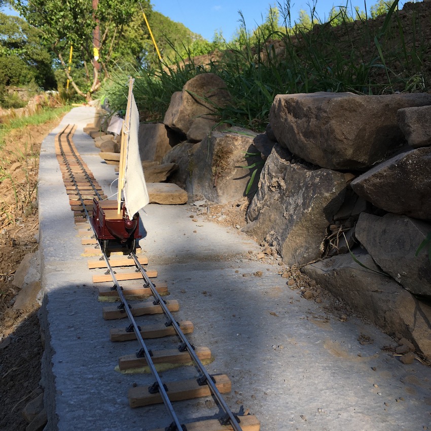

I have built a model of Spooners boat.
My railway has a constant gradient of 1 in 60.
It sort of runs under gravity - but not quite. It moves but the slightest thing stops it.
It has ball races in the axles, but the wheels are solidly mounted on the axles.
How do I reduce the friction so that it runs even more freely?

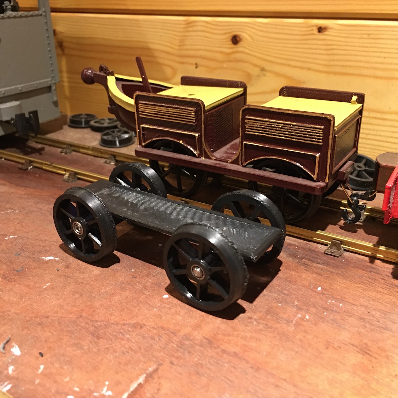

I have been experimenting - and have made some progress.
I ordered ball bearings, 3mm ID, 6mm OD and made experimental plastic wheels on the 3D printer.
I have tapered the treads (which I don't usually bother to do particularly if I am making the them in the lathe) and reduced the flanges to 0.5mm deep. I was thinking that they might self steer around curves and avoid the flanges making contact with the rail (and causing friction) - yet to see if that has any impact. I have also made a new chassis which incorporates compensation to make sure each wheel maintains contact with the rail.
The photo shows the new chassis with its experimental wheels. You can see the ball bearing. It is unshielded ( less friction without shields?) and there are two of them in each wheel, about 1mm apart. I cleaned the bearings to get rid of the preserving oil in them (which was causing friction) and lightly lubricated them.
The bare chassis with a weight added (300 grams) rolled freely on a gradient of 1 in 167. The original boat (with the same weight added) on its painted steel wheels and brass chassis required a slope of 1 in 64 to get it to roll.
So whatever transpires with the wheel experiment it looks like I have a viable boat to gravity run in the spring!

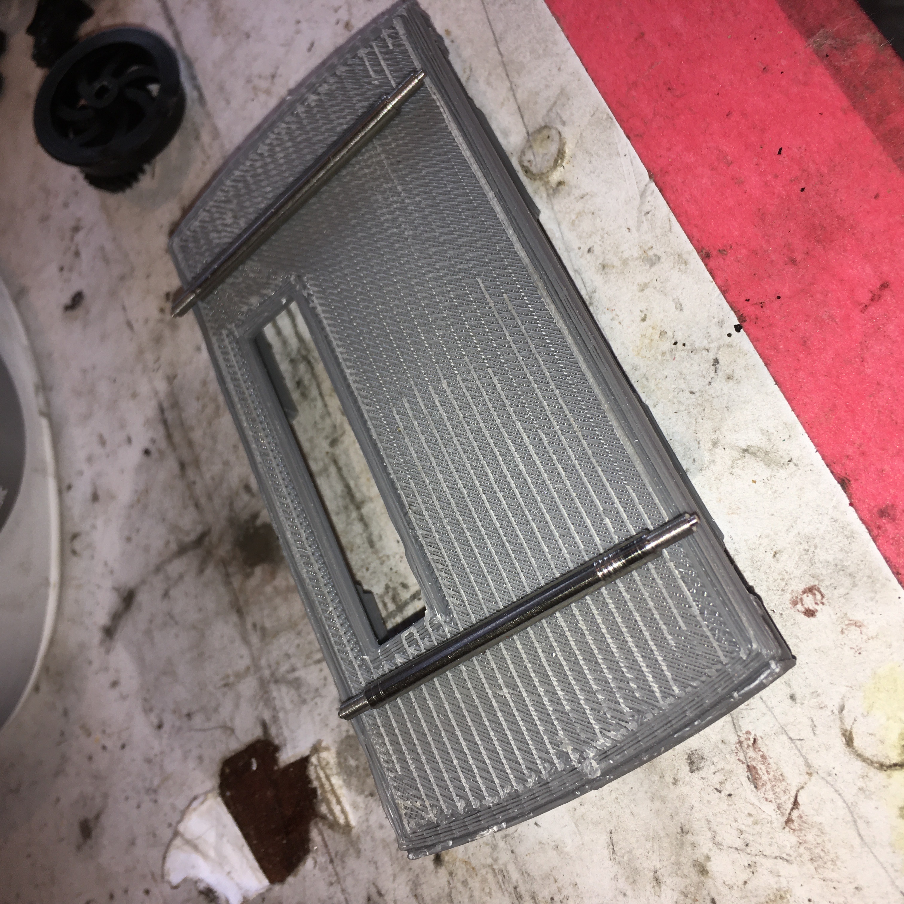

A bit of an update on gravity running.
Sparked really by a running session with Simon earlier in the week. He took one of my trains up the line and discovered that when he uncoupled the locomotive to run around the train the train took off down the line on its own.
So what have I done?
There are two types of wheel bearing arrangements.
Firstly early wagons (and the slate workmen's train "coaches") had inside bearings. It is straightforward to add ball races to them:
You can see an early wagon (a Dandy wagon which I suspect should have had inside bearings) and in front of it a printed bearing housing, which has a through hole for the axle of 4mm diameter opened out to 8mm diameter for 3mm at each end. There is also a packet of ball races in the photo, 3mm bore, 8mm outside diameter. The 3mm diameter axles are threaded through the housing after pressing the races into the bearing block - and then the bearing is bonded into place.

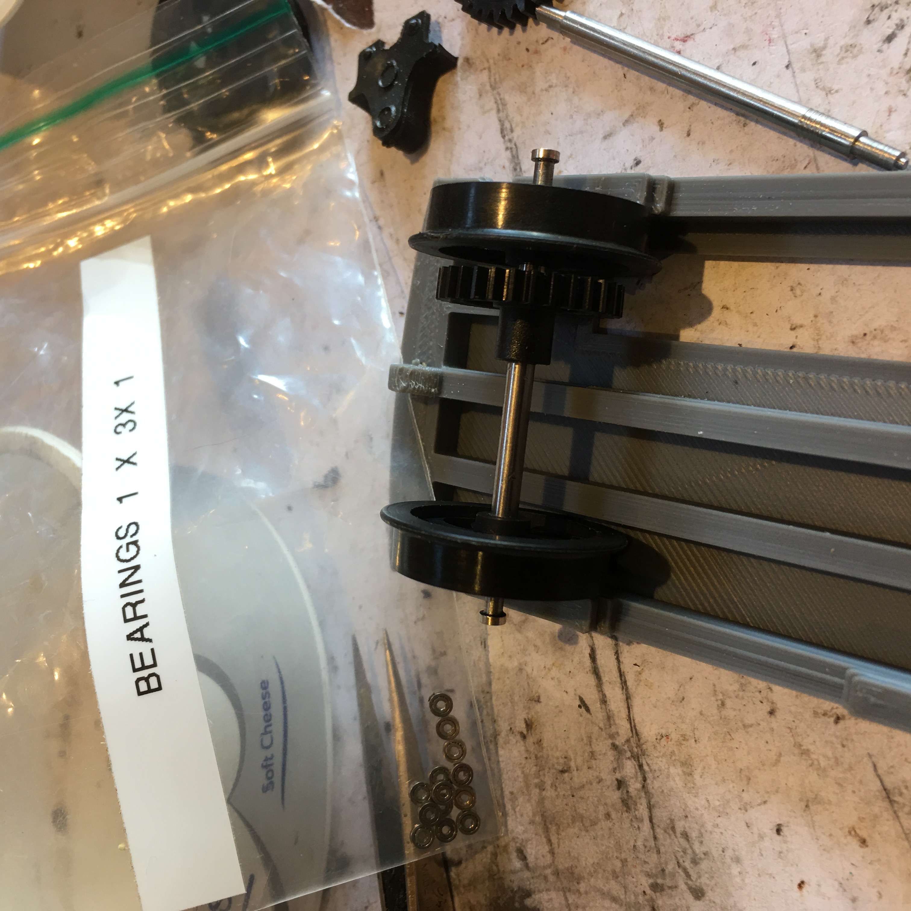

More complicated to achieve (but the end result is very satisfying) is to do the same with outside bearing wagons and coaches. In this case I found some very small bearings - 1mm internal diameter, 3mm outside diameter and 1mm wide.
The axles were turned down to 2mm diameter for 5.5mm and then to 0.95mm diameter for 1.1mm, at each end. Clearly this requires a lathe, and is easier to achieve with a digital readout system.The axles ready to use:
They are sitting on a wagon body which was modified to accept a geardtrain and motor! I don't think I will actually need to use it on my own railway!
and with wheels and bearings added:
The biggest issue in assembling these is that I have dropped bearings on the floor and I cant find where they have ended up.
Finally this wagon has descended on its own from further up the line - and its going quite quickly here:
I have yet to get the Spooners Boat to perform this well - but I am sure it can be done.

Chocks away! I can confirm that the bearings make a world of difference and introduce a new problem with runaway trains! An immediate solution - magnetic chocks, specifically one of Trevor's magnetic couplings, stuck to his steel track...Trevor Thompson wrote: Thu May 05, 2022 1:30 pm Sparked really by a running session with Simon earlier in the week. He took one of my trains up the line and discovered that when he uncoupled the locomotive to run around the train the train took off down the line on its own.
Of course since then, ruminating on the problem, I've realised this is the perfect opportunity for working r/c brakes...

Yes - I have thought about RC controlled brakes!
Might have to look further into that.
And of course I have designed a printed magnetic chock!
And I still cant see where those dropped bearings ended up.
