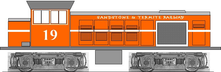

My usual method of drawing the plans is to take a side-on pic of the bogie and obtain either a pic or plans of the loco. I then crop the loco pic below the running board and paste both in to LibreOffice Writer. If I adjust the screen “%” (“zoom”) I can draw it to full or half size for an A4 paper size. I shortened the drawing to suit the wheelbase and the total length I wanted. I’ve decided 500mm is the absolute max length for any vehicle on my line, so this one is 480mm.
Then I used Libre Office Draw to outline around the pic to get a simple, full-size drawing, like this. Allows me to decide on colour scheme and lettering style too.
Now the hardest part for me - how to fit everything in and be able to access it, with the minimum number of plugs and sockets. This planning usually takes more time than building it !

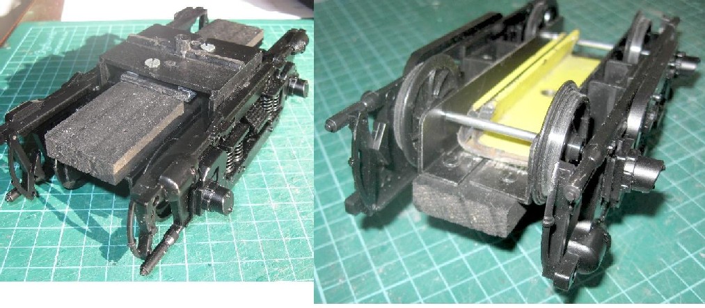

Finally I actually started work. First I built the dummy bogie from bits of 25x25mm aluminium angle, some wood and used old plastic Bachmann wheels. They are 3mm smaller diameter than the powered wheels, but who’s going to notice when the side frames are the same level. This shows the top and undersides. The yellow is a bit of scrap steel for weight.
The lugs on top of the bogies were ground off to create a flat bearing for the baseplate to swivel.

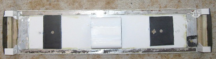

Then I cut the baseplate from 1.5mm styrene and glued 10x3mm aluminium bar underneath for strength.

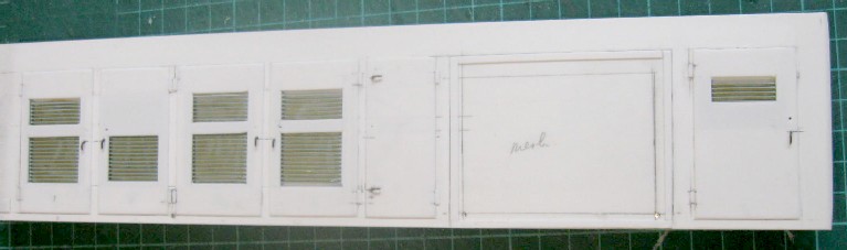

Then I started making all the body pieces, from 1.5mm styrene. It’s amazing how many bits there are. This pics shows most except the cab roof. I’ve learnt from experience that it’s best to put all the detail on BEFORE you assemble it ! (Did I really say that a diesel was easier to build than a steamie?)

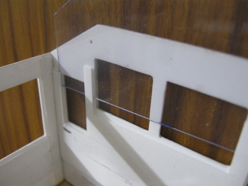

I used 0.5mm clear acrylic for windows and build up a sort of frame inside the cab so the acrylic slides in from the top. This allows the windows to be fitted after painting. This pic gives the idea. Here’s the top of the long hood and one of the sides. All the hood and cab sides glue/screw onto the base. All electronics fits in the long hood so all wiring to motor, battery, switch, sound card, charge points, and lights is fixed in place. The only plug/socket is to the speaker which is mounted on the hood roof which is held in place by small magnets. The 2" dia speaker mounts under the circular 'radiator' grill.

I like the idea of making the window glass removable. I must try that on my next build. Actually, my next build is the boneworks - but the idea should work equally well on buildings!
- -steves-
- Posts: 2473
Re: A scratchbuilt "big" diesel
Totally agree with Rik on this one as above, brilliant idea to have a removable window, certainly something I shall be doing in some future builds

A lovely model there Greg. Can I ask what method you used to cut the windows and other openings in your model? I have to say I have varied results doing such things, and it's quite demoralising having to start again when I make an inevitable slip of the knife
- especially when it happens on the last cut!
- gregh
- Posts: 622
- Location: Sydney, Australia
Rule1 is always cut on the backside, so slips don't show. And always cut to the inside of the window.Lonsdaler wrote: Wed Aug 05, 2020 12:55 pm A lovely model there Greg. Can I ask what method you used to cut the windows and other openings in your model? I have to say I have varied results doing such things, and it's quite demoralising having to start again when I make an inevitable slip of the knife- especially when it happens on the last cut!
A lot of my models have a 'inner box' made from 1.5mm styrene covered by an outer 0.5mm styrene 'skin' with any rivets etc on it. So any slip cuts are covered up.
When cutting windows in thicker styrene (>1mm), I drill holes inside each corner of the window, then cut diagonally across between the corners, then finally around the 4 sides. That allows me to break out the 4 triangles easily. Then a square file in the corners.
And I admit - I hate doing them!

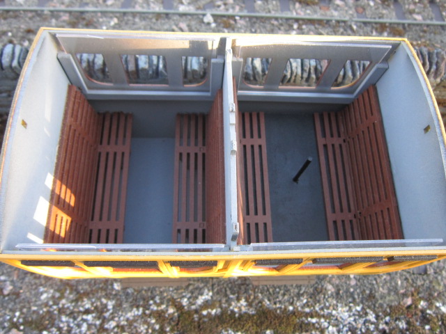

When making passenger carriages with lots of windows, I make the outer sides from 0.5mm styrene which is much easier to cut the windows out of, and then build up the 'insides' of the windows with smaller, thicker styrene pieces for strength. Then a final inner 0.5mm to cover it all up. (then the slide in window holders.)
Sorry if it's hard to understand, but I don't have any pics.
I can't remember where I got the idea from, but it's how I have always done my windows after my first disaster trying to use superglue.ge_rik wrote: Mon Aug 03, 2020 1:14 pm I like the idea of making the window glass removable. I must try that on my next build. Actually, my next build is the boneworks - but the idea should work equally well on buildings!

I certainly can't claim to have invented the idea of removable glazing, but I have always used it for various reasons, firstly, as Greg says, superglue is a nightmare to use as it gets on the glazing and shows marks, no matter how careful you think you have been, it can also 'fog' and cause further damage.
Also, I find it a better way to spray paint models as card can be slid in to the grooves to prevent paint entering the carriage whilst spraying the outside of the model.
The most important thing is that the glazing will not be pushed into the model if pressure is applied to the windows by rough handling. This can be a major issue if roof sections are permanently fixed so getting to the inside becomes almost impossible without causing more damage.......

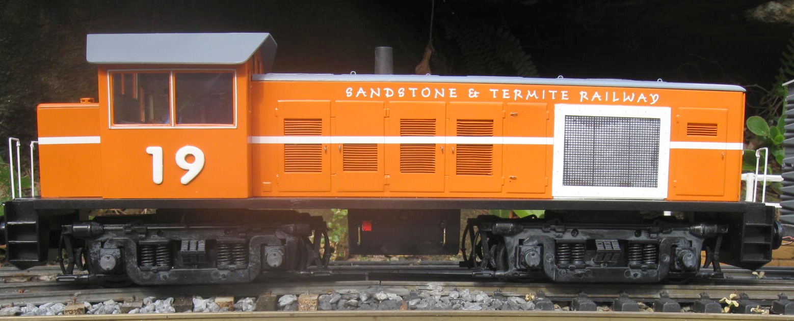

This time, I decided to paint and line all the parts before glueing it all together. It seemed to be easier to work with.
I managed to glue it all up without ruining any paintwork.

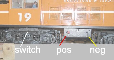

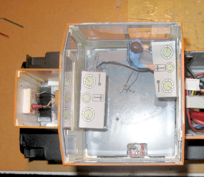

I used 2.4 GHz radio control (Hobbyking) with a 3000mAh Li-Po battery and a Talking Electronics diesel sound kit. In this pic, the battery is under the electronics at left and sound board on right. I built my own Picaxe interfacing circuits to allow the diesels revs to speed up before the loco speed.
The same picaxe controls the driver rotation too – see later.
Note that I do not use a charging socket – just two ‘pins’ that I clip onto with alligator clips. Here the pins are disguised as handles. That also means I don’t use a 2-way switch to disconnect the electronics from the battery when charging. I have never seen the point of that idea.
I got a bit carried away and decided to mount the driver on a servo so he rotates to face the direction of travel! This was a bit complicated as a servo only turns through 90 degrees whereas I need 180 degrees. So the servo arm turns 90 degrees and the driver’s seat is mounted on the arm and is turned through another 90 degs by a ‘fork’ on the floor of the cab. See video later.
I also had to perform a sex change operation on the driver as I only had some seated female figures and this is the 1950s so no women drivers!
And a video of the servo moving the driver from above.
The lettering and lining is adhesive vinyl made by Gscale Graphics in USA.
The large numbers on the cab are wooden, from a craft shop.

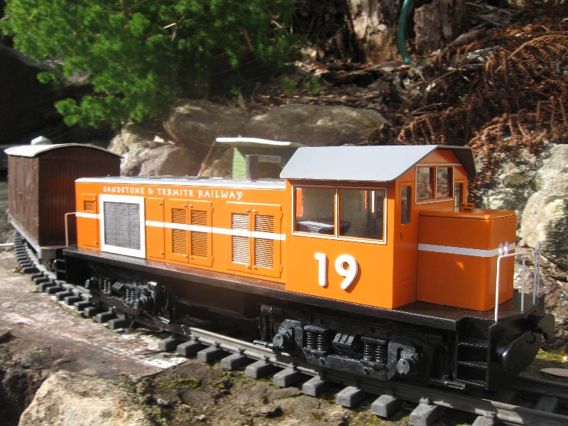

And here’s the finished product: The only problem is the light weight of LiPo batteries compared to NiMH. I had to add a lot of lead!
Here’s a link to a short video on Youtube:
