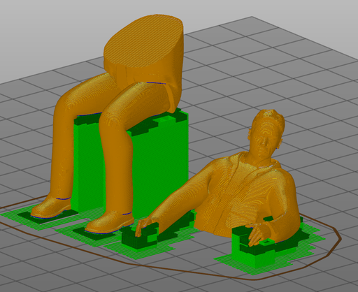

3) Screenshot of the Blender stl export in Cura waiting to be sliced ( this is where it gets interesting but complicated):
Driver Cura screenshot.jpg (36.29 KiB) Viewed 13843 times
Note:
Cura has automatically scaled it by 10,000% but the resulting figure is 143mm tall on the buildplate, as shown. That's easily sorted by telling Cura to scale to say 85 or 90mm high (or whatever is needed). However the point is that the original Blender export is huge and as I've found before with other things, a mesh with fairly gentle curves at a large scale can't be translated down very much before those curves become too small for the software to handle and you get holes in the mesh. That is most likely to happen round the face of a human figure, most notably on the eyes, nose, mouth, chin and ears, plus hands/fingers, which is exactly what I've found previously without understanding why.
4)Closeup Screenshot of the figure in Cura, after reducing to 90mm high:
Driver Cura closeup screenshot.jpg (11.81 KiB) Viewed 13843 times
I now suspect that the blue shading on the Cura picture, above, is actually indicating that there are mesh holes in these areas. Then when it comes to slicing and printing, the software and printer simply do their best and gloss over the defects which is why strange holes, lumps and blobs appear.
There are mesh repair tools available, 'Meshmixer' is one, but I've downloaded and taken them out again more times that I can remember. Not because they don't work but because they are too complicated to learn and understand for the limited use I have for them.
So, I think I now understand what is happening but no idea how to deal with it. Even if I could use Meshmixer, I'm not sure that it or Cura or the printer could handle the extremely fine detail, so we might still end up with featureless shapes.

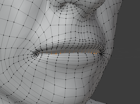

I have a a few tricks to try and make printing figures from makehuman easier.
First, you are totally correct about there being holes in the mesh as it comes from meshmixer and this can contribute to ruining the face quality of a print. The main problem I found is that the mouth is an open cavity, so the printer has to try and form the lips with a tiny amount of material, the area might be thinner than the nozzle diameter so you get messy extrusions in that area.
To get around this, I have two steps:
In edit mode in Blender, close off the mouth by moving some of the vertices of the lips so they intersect:
Now netfabb can remove the mouth cavity, before and after:
Netfabb is a mesh repair tool that is built into PrusaSlicer, but I think there is a standalone service you can use as well. You can see it also altered the shirt that would be too thin to print. Meshmixer can probably do the same job.
I also like to cut the figure in half for printing using the tools built into PrusaSlicer:
This has a couple of advantages, namely if if you end up having a failure or quality issue, you don't have to reprint the whole figure, only the bad half, and it minimises support required for the arms. You can also flip the legs so cut surface is flat to the bed, significantly reducing the required support material, but then you have to do a lot of filling and cleanup on the very visible top of the thighs. If you were printing a standing figure this would be much less of an issue, and I would print with the cut flat to the bed.
Phillip, I think the blue faces in your Cura screenshot are the software pointing out where you have steep overhangs, the printer will be extruding in thin air there which will almost always result in imperfections. Because I cut my figure at an angle, the top half is leaning back when printed, this reduces the overhangs on the face and makes it worse at the back of the head, but the back of the head is much easier to fill and clean up after printing than the face.

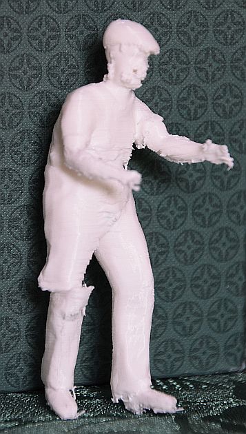

Post by philipy » Sun Jul 26, 2020 4:06 pm
Ok, so I've now done a 'fixed' mesh print, using the Netfabb online repair tool.
First the latest Dr Who monster, before his support was removed:
Next with the support roughly removed, from this side it looks virtually identical to my original, unfixed mesh, print, including the hole in his face:
Finally, from the other side, the 'fix' seems to have left the poor chap with a major break to his leg which he didn't have before - the cure seems to be worse than the disease.
