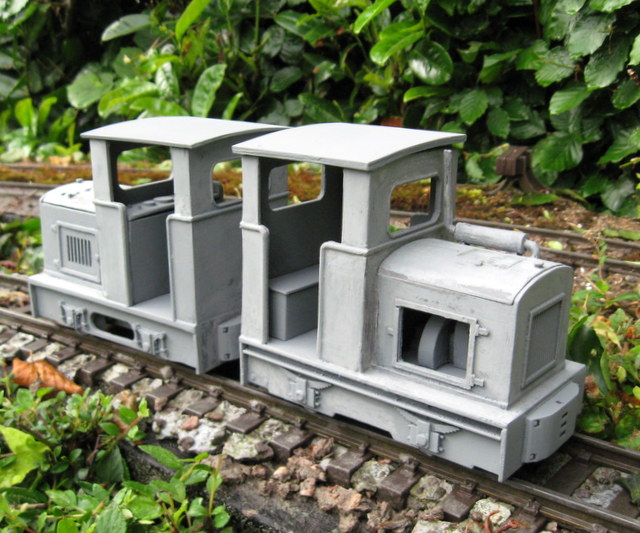

The latest project ..... a 3D printed diesel loco (x2)
I thought I would try something a bit more ambitious with the printer. The model was downloaded for free from Thingiverse and then the parts printed out an assembled. I wasn't entirely happy with the first print (I discovered the X and Y axes weren't perpendicular), so I printed out a second one. I then decided the slightly wonky first one was OK and so will run them back to back (as per Australian sugar cane railways) - one powered and the other a trailer (for now).
So far each loco has cost around £3.00 in plastic, wheels - £9.00 (IP Engineering), brass bearings - £1.20 (G-Bits) and then the motor and gears for the powered loco - £12.00 (IP Engineering) plus 2 x li-ion AA - £8.00 (Ecolux) and a Deltang receiver/controller - £40 (RC Trains)
Total = £86.40
Many thanks to Ivan at IP Engineering. While fitting the gears, the insulating bush in one of the wheels shot off across the room and disappeared into that void where all small screws and washers end up. I contacted Ivan for a replacement and four bushes with wheels arrived FOC. Excellent service!!
Total = £86.40

They look really good together Rik and the printing looks tidy too. When I first read the title of your thread I expected to see the two conjoined, Fairlie style!

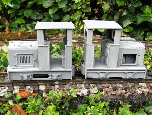

You'll notice that there are slight differences between the two locos. One is the original and the other uses additional / replacement parts which a fellow modeller added. That's one of the things I really like about 3d printers: the willingness to share ideas and resources. Just like Garden Railway modellers!philipy wrote: Tue Jun 16, 2020 4:32 pm Who's got the bug then???![]()

Not necessarily. There's a steep learning curve with getting the printer to behave and, unless you are skilled with 3d CAD programs, you are limited to the range of models which are available online. I'm in the process of drawing and printing out a simple box car / van for my railcar. I've managed to draw and print the sides but the ends are giving me all kinds of problems. The drawing looks ok on screen but when I try converting it to a 3d print all sort of weird things keep happening. Apparently, 3d drawings are susceptible to invisible issues (eg "reversed normals", "non manifolds") which mean they are impossible to print. I've discovered a couple of online tools which analyse and repair drawings so I am currently exploring those.BertieB wrote: Tue Jun 16, 2020 10:39 pm That’s really neat. 3D print has to be the way to go, I guess. Hmmm...

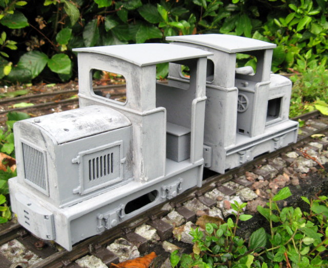

You do realise that it's your fault for seeding the idea of the b2b diesels.
Thanks for the video (and the photos sent previously).
I don't think my diesels will end up looking as smart as yours. The wonky one will be especially heavily weathered to distract attention from its wonkiness.

There's a fair amount of filling and sanding to reach this stage. I've found a couple of coats of filler primer sanded down are needed before the normal two coats of ordinary primer, plus a fair bit of targeted filling and smoothing in between. I'm not sure how the finish from my cheapo printer compares with more expensive ones, so I might need to exert a bit more effort to get a decent finish.

I still reckon they should be nose-to-nose not cab-to-cab. I guess that in Queensland they would get better cooling airflow with one loco's radiator at the front. But heat shouldn't be a problem on the PLR surely.

I'll give it a try to see what it looks likegregh wrote: Thu Jun 18, 2020 6:46 am Great looking brace of locos Rik.
I still reckon they should be nose-to-nose not cab-to-cab. I guess that in Queensland they would get better cooling airflow with one loco's radiator at the front. But heat shouldn't be a problem on the PLR surely.![]()
