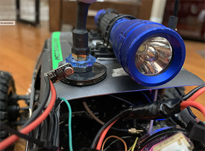

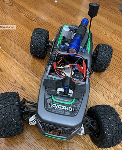

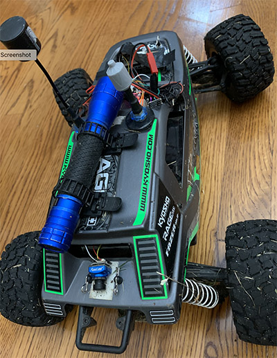

After hearing many ideas, I came up with this RC car. I wired up 2 VTXs connecting to 2 FPV cameras and associated antennas. Further, the car has intercom system along with a tiny but powerful microphone. As I tested in the basement, with a large flashlight on the roof of the car and powerful VTXs that enable me to check for water leakage very effectively.
RC car3.jpg (75.28 KiB) Viewed 4078 times
RC car2.jpg (121.57 KiB) Viewed 4078 times
RC car 1.jpg (128.04 KiB) Viewed 4078 times
