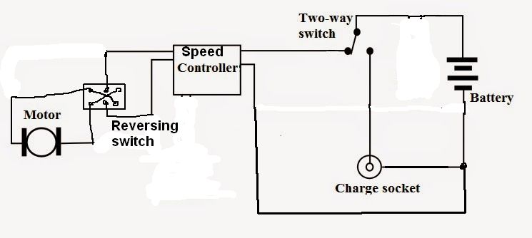

Hello everybody new boy here. I am looking to wire a scratch-built 16mm Diesel loco. I need a wiring diagram (simple) to connect the Batteries/charger socket/speed controller and direction toggle switch the on-off-on version. If someone out there can help you have my thanks. Frank.

Here's a basic wiring diagram. You won't need the receiver otherwise the same as this. .

Just realised you need a reversing switch as well. This would go in between the speed controller and the motor. Rik

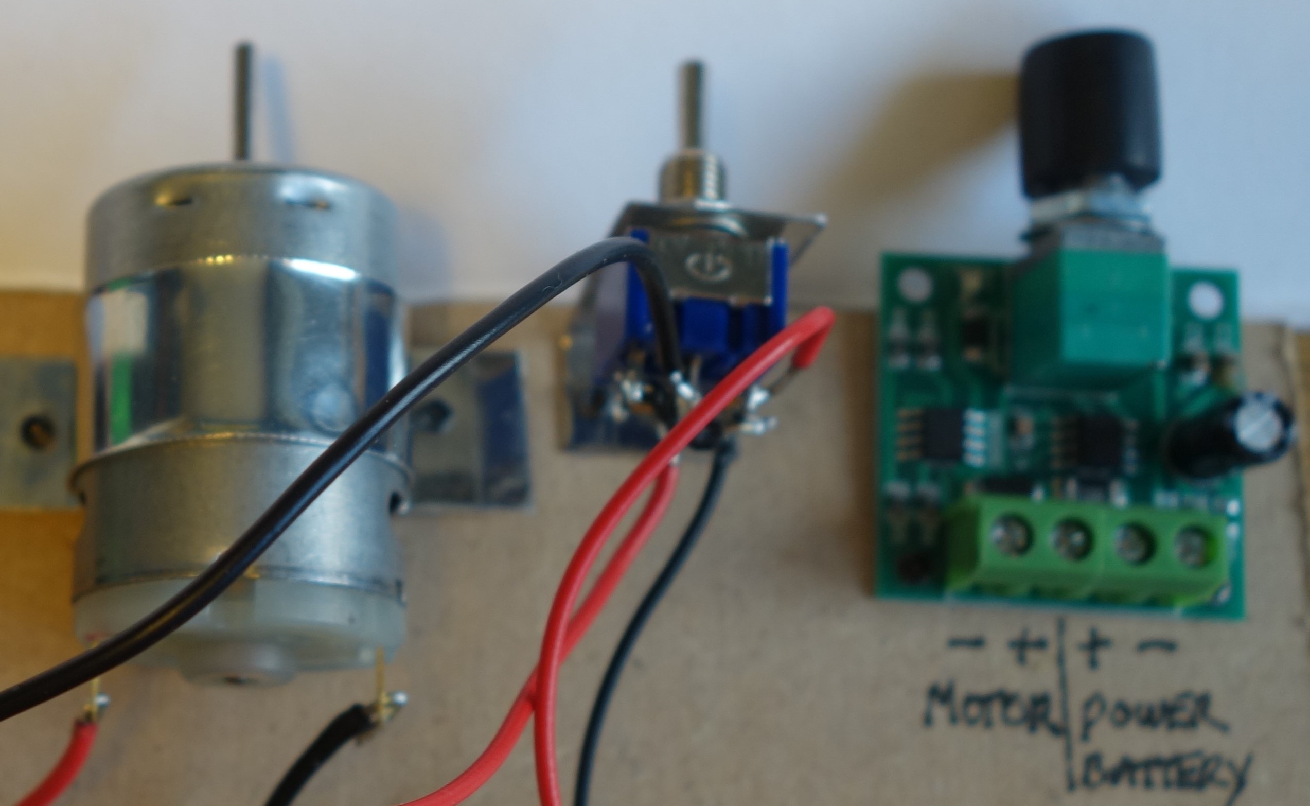

I am still struggling with the wiring I am trying to wire up a Motor, Toggle Switch (on/off/on)/PWM speed controller and batteries I have attached a photo as to what I am trying to achieve. I just need a Sparks out there to show me where the wires go a freehand diagramme would be great.

The photo doesn't help much with what you've actually done, since it is fuzzy and doesn't show the full paths of all your wires,plus the connections to the switch are partially obscured as well.
Rik's diagrams are spot on but I've slightly redrawn them ( very crudely, my apologies Rik!) to hopefully make them somewhat clearer to somebody who has no experience. If you don't want the charging socket then you can simply omit it and it's switch, and connect the battery output, direct to the speed controller input.

To quote Professor Dumbledore.... " Help will always be given at Hogwarts to those who ask for it"frank3447 wrote: Fri Oct 25, 2019 10:39 amThanks to you all. Diagram did the job (big relief). I can now fit it to my Diesel. Once finished I 'll post a photo. Frank.

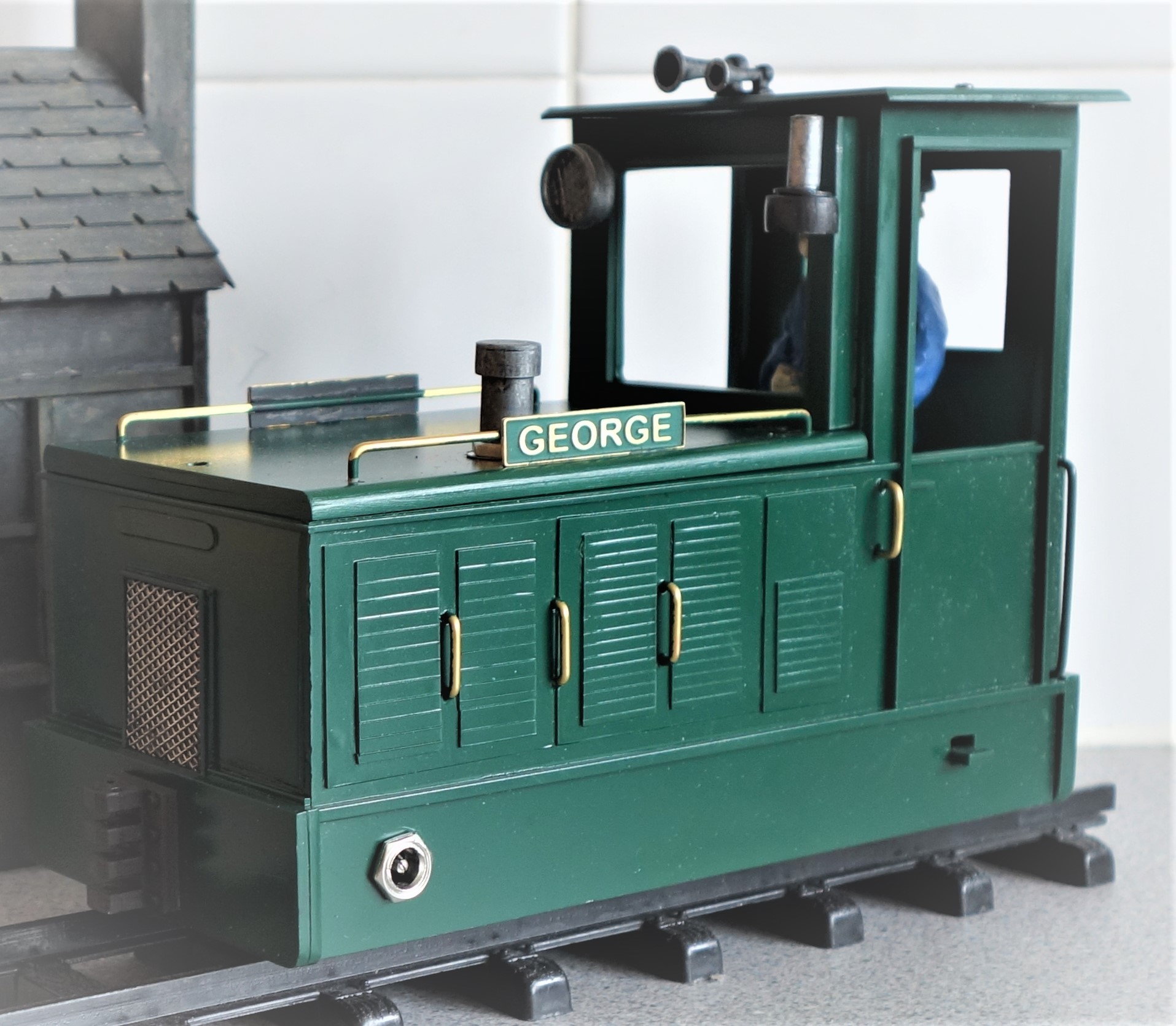

Hello.
It works
My first effort in scratch building it can only get better right!. Thanks again.
It works
