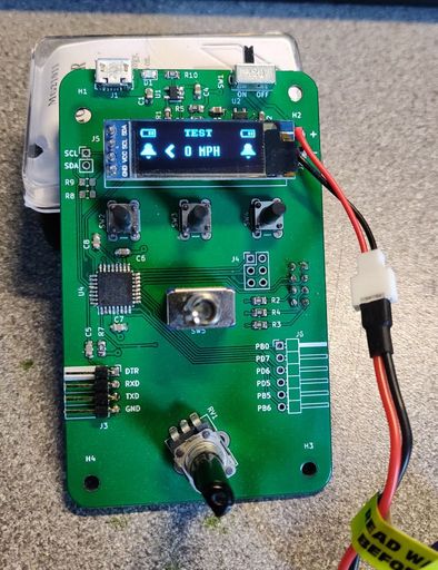

With regards to the lack of tactility, it looks like it should be pretty straightforward (for anyone with the prerequisite knowledge) to make a transmitter like the common knob-and-reverse-switch type that works over the bluetooth link.
I have been playing with alternatives to the usual Deltang type setup for a while, in an attempt to keep the costs down. My latest messing about has brought me to cheapo chinese clone NRF24L01+ modules, with these you get a 2 way radio link for £2. I built a transmitter that is basically an Arduino with built in radio module, USB LiPo battery charger, OLED screen and buttons for menus, reverse switch and speed knob, photo attached. Would be relatively easy to use a bluetooth module instead of an NRF24.
On the other end, I wanted an integrated solution to radio control, motor driving and sound effects. I managed to get an AVR playing multiple sound files off an SD card at the same time, and another one sorting the radio and motor control, but when it came to integrating both functions into one little 8-bit chip... I was asking too much of either it, or my programming skills. Now looking into more powerful alternatives that also don't break the bank...
- Attachments
- IMG_20190702_181222.jpg (80.52 KiB) Viewed 15976 times

Really interesting stuff - you read my mind - I've got some NRF24L01+ modules on order and am just researching a Bluetooth equivalent. Gregh has been playing with 8-pin Picaxe chips for quite a few years and is experimenting with controlling sound files from an SD card as well as controlling the speed. You probably have a lot in common.metalmuncher wrote: Tue Jul 02, 2019 6:41 pm With regards to the lack of tactility, it looks like it should be pretty straightforward (for anyone with the prerequisite knowledge) to make a transmitter like the common knob-and-reverse-switch type that works over the bluetooth link.
My programming skills are acquired purely on a need to know basis - trouble is I sometimes don't know what I don't know .....
Edit: Just discovered that the HC-05 Bluetooth module is in 'slave' mode by default but can be reprogrammed into 'master' mode. Time for a play....
