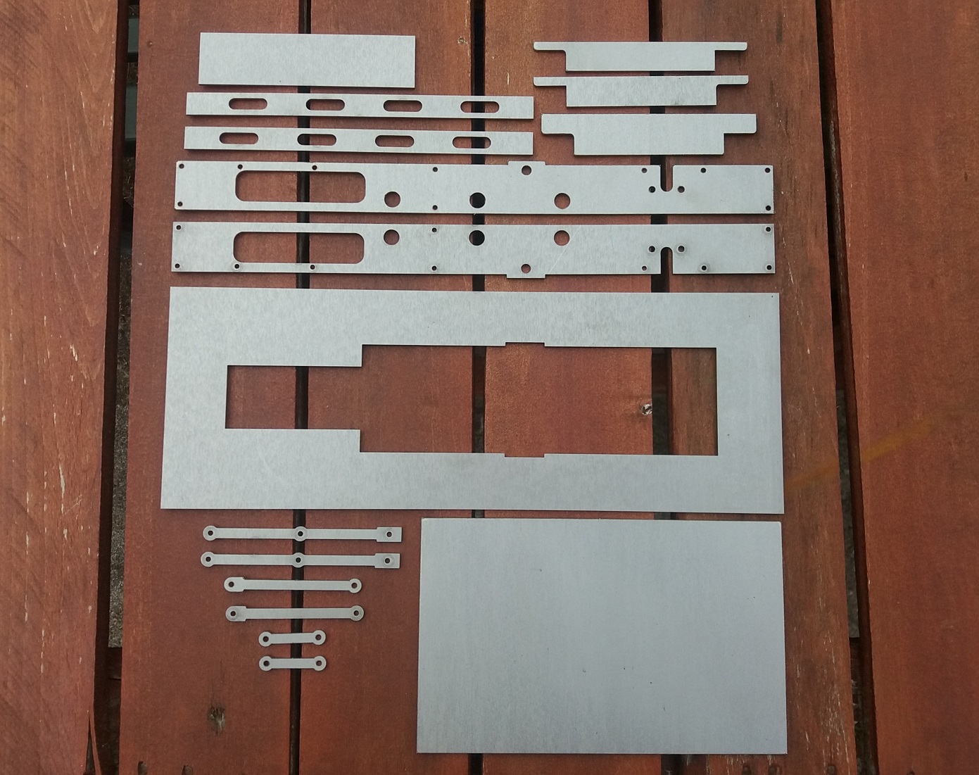

Post by Busted Bricks » Mon Jun 10, 2019 12:10 pm
Here are some loco chassis parts I recently cut for a UK modeller. 2mm mild steel. Total cost of £14 excluding postage.
locoparts1 small.jpg (429.94 KiB) Viewed 179914 times

I assume that the £14 you mention is simply the material and cutting cost? i.e No drawing/set up cost - you said it excluded postage, of course.

Post by Busted Bricks » Mon Jun 10, 2019 3:15 pm
Tracked shipping was £16. It just sneaked past 1kg. For just a few quid more I could have shipped 20kg!
£14 was for cutting and material. I normally charge £12 for setup cost per sheet thickness but this was a special offer for the locobuilders Yahoo group members, where I would waive the setup charge provided they could wait for the parts until I had a larger job for the laser using the required sheet thickness.
Customer provided a dxf file so there was little for me to do on that front.
