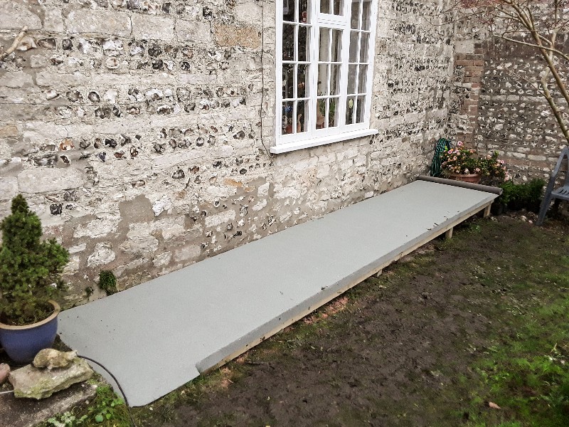

The first stage of the Compton Valence Light Railway, henceforth known as the CVLR. This is the base for the station, goods yard and MPD area nearing completion. 😁

That looks good. The wall will make a great backscene too.

I hardly noticed the track base because I was drawn to that wonderful wall..... lovely piece of architecture.

Ooooo flint walls.........
Growing up in a flint area this reminds me of home. I love this type of construction.
Have fun with the railway and please post lots of pictures.

It's a very old converted dairy. If you look closely you can see the blocked in doorway at the far end where they used to take the cows in for milking. And yes, it will make a great backdrop especially as tnere's a profusion of Mind Your Own Business growing up the wall ready to creep over the track and ballast when it's laid. ;)

Is that a wood or concrete base?

It's a tanilised timber frame 'L' bracketed to an existing concrete path, topped with felt covered exterior ply. I wanted ventilation underneath as it's so close to the house wall. The cottage is so old there's no dampcourse, just 2' thick walls! It will be ballasted, and have rocks and a gravel path fronting it but with gaps for air circulation and water run off to escape, so should all blend together nicely.
