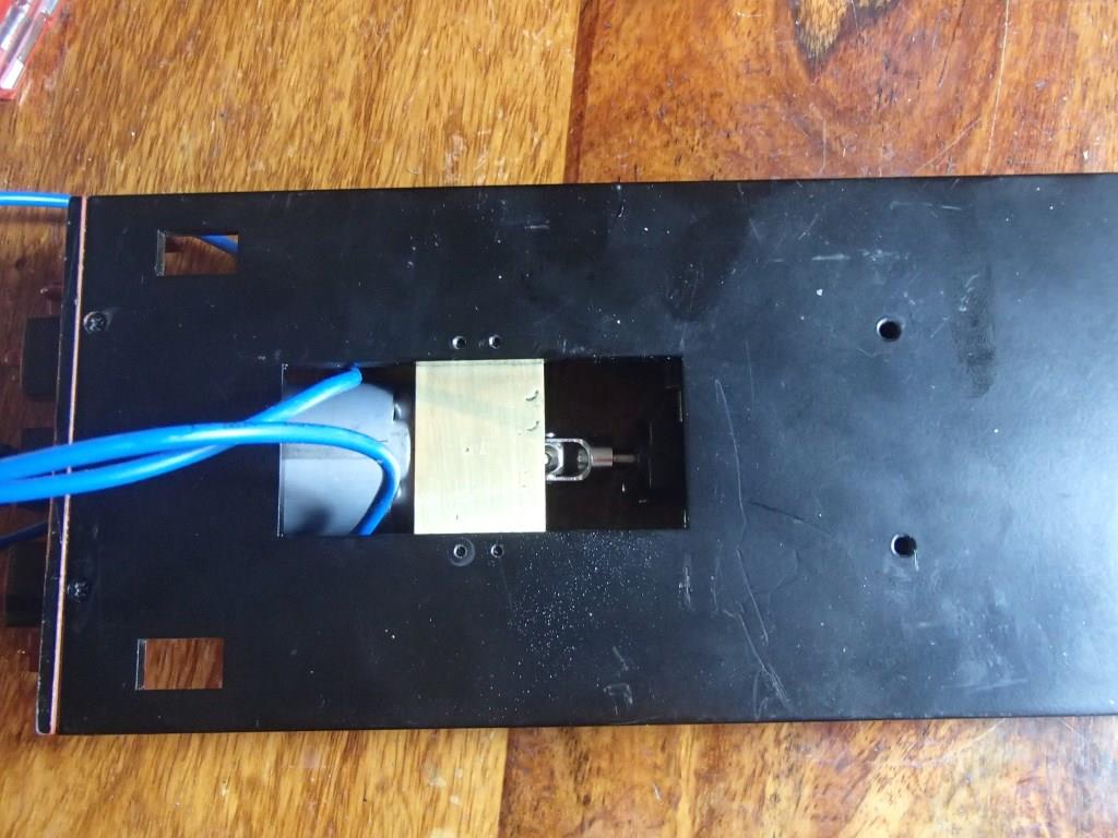

I have relocated the motor and changed the rubber coupling for a metal universal joint. The air filter thingy on the bonnet top now doubles as an on/off switch.

Initial tests show that it runs as smooth as it ever did, the motor is the original. I intend to use Eneloop NiMh batteries.
My long term plans are to get rid of the accucraft worm drive. Worm drives are always less than 50% efficient. That means you are getting less than 50% of the tractive effort, or that you have to carry twice as many batteries.
My final plans are to add an epicyclic gearbox to the motor and have a helical drive to the jackshaft.
