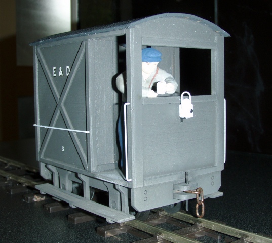

SVLR wrote: Tue Jul 18, 2017 12:27 am Not sure about colours, was going to spray it grey or a green colour, not sure yet - any ideas or opinions on colours?
Colour choice is really whatever floats your boat.
I have an Andel brake van which looks fairly similar to yours. Mine is in grey because thats my freight stock colour.
003 small.jpg (336.5 KiB) Viewed 12122 times

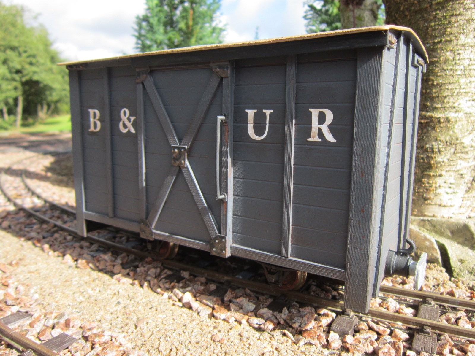

Try this way then, hopefully, you will see the van in its first coat of green paint, I have now decided to paint it grey.
by Jonathan Demery, on Flickr

Post by SVLR » Mon Aug 14, 2017 4:48 pm
Did it all myself, luckily I have access to a laser cutter. After doing a rough sketch to flesh out some dimensions I drew it using 2D Design. Mostly cut out of 3mm laser ply and 1.5mm birch ply. I am happier now that I have resprayed it grey. Its a 95p can of Battleship Grey from Buyology, the whole can allowed me to give it three coats. I have also now covered the roof in Solartex and sprayed it with white primer before the final coat of a slightly off white.
Image20170814_163439 by Jonathan Demery, on Flickr

Post by markoteal » Mon Aug 14, 2017 6:16 pm
Yes - can see your pics now - the green looks good but I'm a grey or bauxite red guards van man!
markoteal
Posts: 763
Location: Yorkshire
Re: BRAKE VAN
Post by markoteal » Mon Aug 14, 2017 6:17 pm
And your final pic proves that!
Posts: 6057
Re: BRAKE VAN
Post by philipy » Mon Aug 14, 2017 6:51 pm
Very nice, and I much prefer it in grey, myself.
