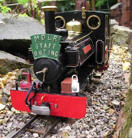

Mine (as you saw on Tuesday) runs very well. I added a pair of Roundhouse sand boxes on the front of the saddle tank, a tool box and jack on the rront running plates and a lubricator on the side of the smokebox. With lining out, name and number plates she looks well!
