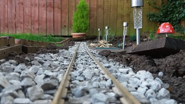

Firstly, it's not as beautifully intricate as many of your garden layouts but this is my own little line. After three and a half years... :D
I've even laid out a history of it but first things first.
I've laid the track temporarily upon the foundations along with the platform. So far everything doesn't fall off or hit a tree which is a good sign.

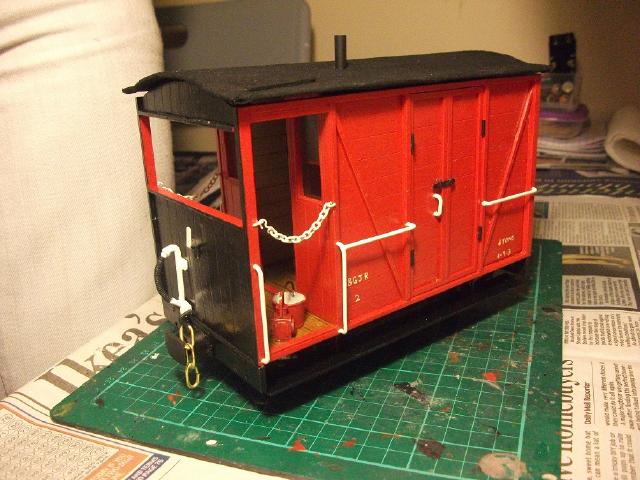

Well I ballasted last night (literally - with only the solar lights and the torch on my phone along with a very annoyed girlfriend) and checked it out this morning.
There have been a couple of running issues with rolling stock and the likes which I've sussed to be two problems.
The first being some of the curved track was bought second hand - it was LGB which I thought would have been okay but the joints weren't flush causing some of the stock to derail. In the end I adjusted the back to backs and filed the offending joints down which seems to have negated the worst of it.
The second was the curves are on slight inclines - this was a problem for one wagon, my IP Engineering brake van, which is lovely model but a bit of prima donna to run. I'm not sure if I've skewed the chassis slightly or if it's a deign issue but it's not a fan of uneven trackwork. I've managed to raise some of the track bed in the worst corners to help prevent it riding up the rails but this could be an ongoing problem (watch this space.

My IP brake van is also a "Prima Donna". It comes off in places where there is no obvious defect in the track. I think this is because it is very light. I put a detailed interior in it and didn't add anything heavy, so I might glue a metal plate to the underside. They are nice-looking vans though.
Sylvian Tennant
Posts: 327
Location: Teesside
Post by Sylvian Tennant » Mon Sep 12, 2016 8:28 pm
This is my main offender
I added weight that the bottom similar to LMS wagons
I might be useful to do as it helps the centre of gravity. I am considering (if the problem persists) to try and compensate one of the wheels though that could be a bit of a fart on. is yours the same type? I'm not too sure of the wooden axel boxes to be truthful. saying that I suspect it could just not like rougher track as it seems to be square.
Posts: 5713
Post by Peter Butler » Mon Sep 12, 2016 10:00 pm
I'm sure you have identified the cure for this.... make one axle 'float' (compensate) and your problems should go away!
Long wheelbases and tight curves are not good partners.
