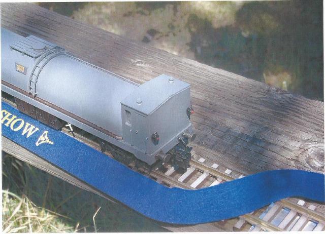

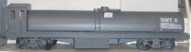

N.S.W.G.R. SWT Bogie Water Gin 1/32 Complete Flat pack Kit , Chassis, Cabin,are laser cut in 3mm MDF, Elliptic Tank is Vac-formed in 4 mm Styrene, with a flat piece Glued on the Bottom of tank, Ladder over Tank is cut in Card ( Not Happy with the Card ) replaced with 1.9mm Plastic and Brass wire rungs, Piping on side of tank Styrene,
Bogies, Buffers, Brake cylinder, Vents on cab Roof, are spin cast in White Metal by me
A Customer bought one and won First place in the Modelling Section

Here are your pictures, Greg Ellis:
Great work!
