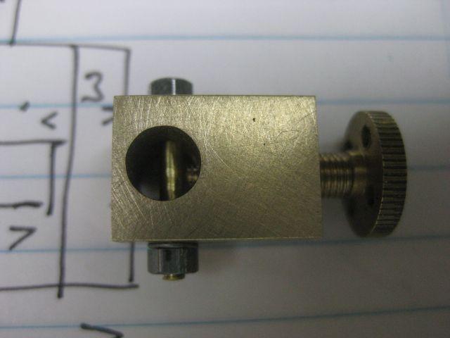

I decided to change the wheels on one of my Mamod based locomotives. So some cast iron wheels that I have had for a long time were turned and Mamod crank pins fitted to them. Having fitted the wheels I decided to make and fit an exhaust regulator; I haven't made one for many years and the ones made were basically the same as a conventional regulator. The all metal ones made were always difficult to fit into a smoke box and connect pipes to. For sometime I have been thinking of a slightly different approach. This is the result.
The parts.
The assembled working bit.

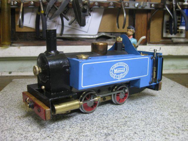

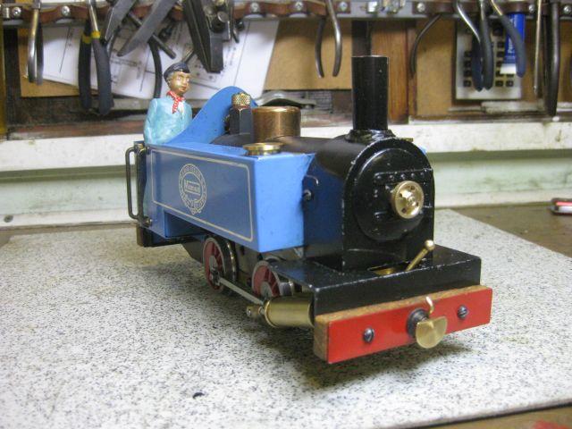

The model completely assembled.
The exhaust regulator certainly works as well as the all metal ones that I have made and is a lot easier to fit.
Exhaust regulators are very sensitive and work very well allowing slow powerful running.

The control knob gets a bit hot! The Mk. 3 version doesn't but doesn't look as good.
Its a modified IPE piston that I have a few of
