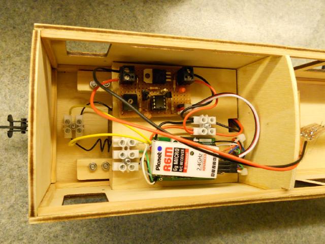

Post by hussra » Wed Feb 08, 2012 7:20 pm
Busy... so busy...
But the Guard's compartment is filling up nicely with electronics. There is a lower layer under this lot which has the on/off switch, charging socket and fuse (as well as the motor sticking up through the floor); the 5xAA batteries are in a big box under the floor which needs decorating with "engine"-looking bits.
Need to drill a big hole in the front for the headlamp, and also holes at the back for jumper leads, then progress to finishing off & painting the bodywork.
Still room for another layer of gubbins. Must think about sound options.

hussra
Posts: 872
Post by hussra » Fri Feb 17, 2012 8:44 pm
Right, after proving that the RC carriage lighting circuit works nicely, this car has now been stripped back to the basic body shell for filling and painting, followed by interior fitting-out. (RC carriage lighting might be a bit much - especially with directional headlights to boot - but there's a spare channel with a handy on/off switch on the transmitter, so why not? Will be handy when running in daytime on lines with tunnels.)
And the two other cars (another driving car, which will be finished as a second driving motor car though in fact unpowered, and a buffet trailer) are on their way from TrackShack.

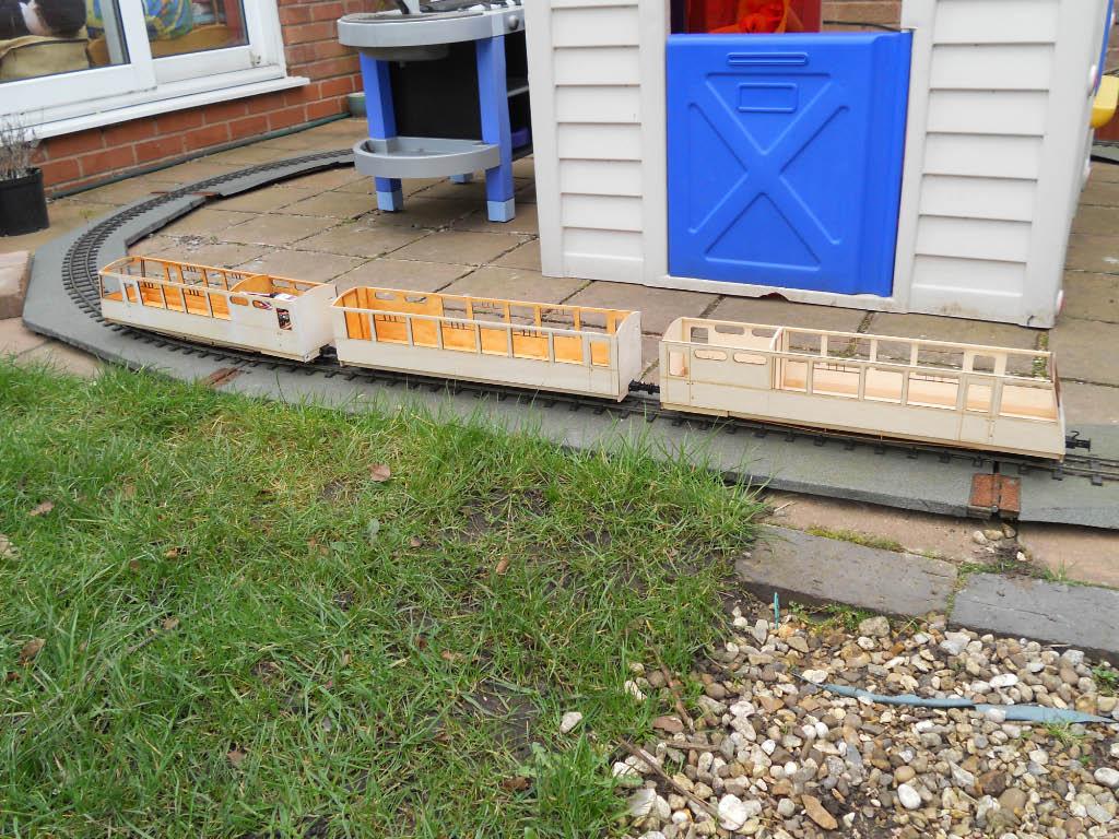

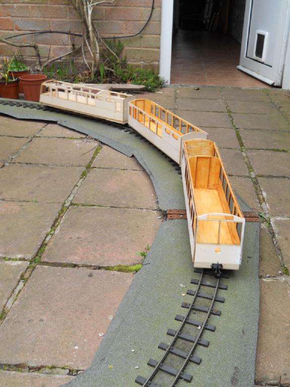

Post by hussra » Thu Mar 15, 2012 9:54 am
Very brief update. All three bodyshells have now been assembled, and await filling & painting. But we had a quick test run yesterday:
Richard Huss
in sunny Solihull
Posts: 1717
Post by GTB » Thu Mar 15, 2012 11:32 am
hussra:67963 wrote:All three bodyshells have now been assembled, and await filling & painting.
That will be impressive to see in action out on the line when finished.
Have you considered recessing the intermediate couplers to reduce the space between cars? There seems to be plenty of clearance on the curves.
hussra
Posts: 872
Post by hussra » Thu Mar 15, 2012 11:54 am
Good idea, but I don't think it's going to be feasible, sadly. The motor bogie, being substantially longer than the now-cosmetic IP sideframes, comes very very close to the inside face of the buffer beam.
I think some more serious haulage trials will be needed before long, to see whether one motor bogie will do or if another would help. The best method is probably to give it a run at Pendo's line :D
Still intending to consider the possibility of gangway connections, just to make uncoupling trickier.
Richard Huss

Post by spooner » Thu Mar 15, 2012 1:54 pm
You could use a bar coupling between cars so there closer coupled?
TonyW
Posts: 1357
Location: North Wales
Post by TonyW » Thu Mar 15, 2012 2:29 pm
spooner:67976 wrote:You could use a bar coupling between cars so there closer coupled?
You beat me to it!
Tony Willmore
hussra
Posts: 872
Post by hussra » Thu Mar 15, 2012 2:30 pm
May be worth considering, but it would need to be reasonably straightforward to couple and uncouple. (The whole train is 5' 4" over buffers at present, so can't really remain semi-permanently coupled here, never mind when travelling.)
Plus the motor cars will have the exhausts on the inner end and some space is needed for those, and for the jumper leads to adjust to the varying curvature. Leave it with me... time to experiment with gangways, I think. Somewhere here I have a little stash of neodymium magnets...
Richard Huss
in sunny Solihull

Marquis DeCarabas
Post by Marquis DeCarabas » Thu Mar 15, 2012 7:42 pm
FWIW, I think the spacing looks about right.
You'll soon fill up that room with exhausts, gangways, water fillers for loos, mysterious little boxes that formerly held carbide for the gas lighting, vac. butterflies...
Posts: 1717
Post by GTB » Fri Mar 16, 2012 1:08 pm
hussra:67968 wrote:Good idea, but I don't think it's going to be feasible, sadly.
Hmmmm. I see what you mean....
These aren't the sort of thing one would shunt regularly. If I built something like this, I'd just put a pin on one car and a flat brass plate with a slot in it on the other one. You could even use a curved slot to open up the spacing a bit on curves if needed.
hussra
Posts: 872
Post by hussra » Fri Mar 16, 2012 1:42 pm
GTB:68018 wrote:If I built something like this, I'd just put a pin on one car and a flat brass plate with a slot in it on the other one. You could even use a curved slot to open up the spacing a bit on curves if needed.
Aha! - like the coupling between loco and tender on my father's Hornby O gauge clockwork stuff. Will have a think. Loads of great ideas on this thread, thanks all.
Richard Huss
in sunny Solihull
Narrow Minded
Post by Narrow Minded » Fri Mar 16, 2012 1:49 pm
How about Bachmann knuckle couplings Richard?
They wouldn't look too unprototypical, would close the gap a bit and wouldn't foul the gangways when uncoupling like the chopper hooks might. ;)
