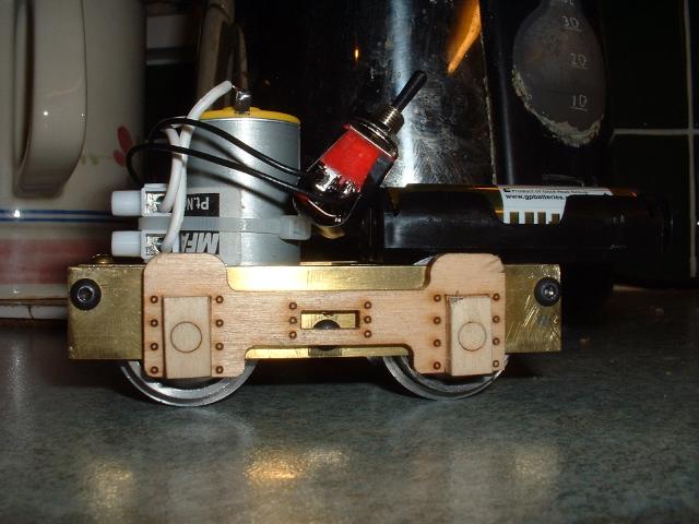

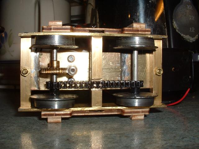

The power bogie had its first test run outdoors today, with a temporary lash-up of 2 AAs and a single toggle switch.
The idea has been to reuse as much of the kit-supplied bogie as possible - which basically comes down to wheelsets, bearings and sideframes which are now cosmetic. MFA motor, Hobby gears, frame spacers from Essel.
Here it is in the kitchen getting ready for the off:

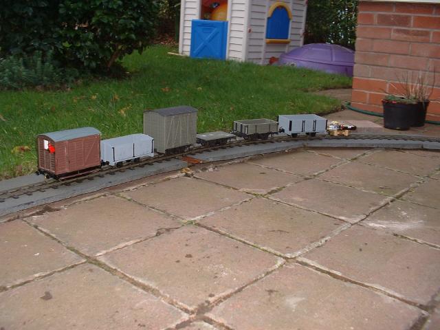

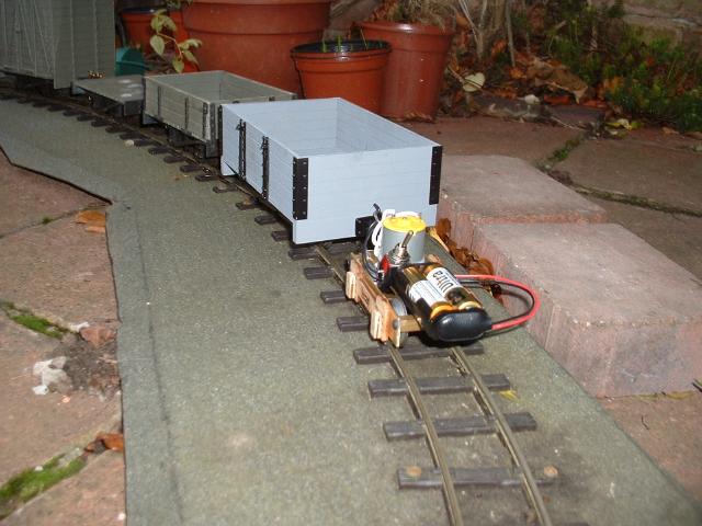

With the batteries it weighs 11oz, 9oz without. Plenty of space to add weight. After a few tours around the test line on the patio, it was out with the paperclips to see how the haulage capacity was. Managed quite nicely with 12 axles:
Haven't tried any more yet. Sprockets really need pinning to the axles. Encouraging results so far!

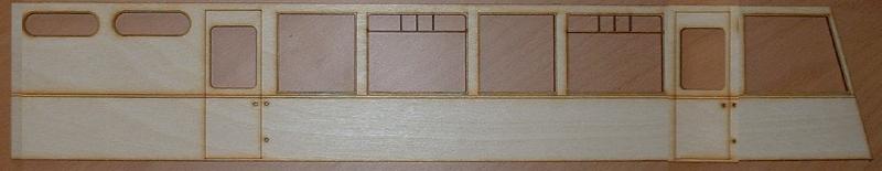

Hmmm, musing on the door-rearrangement idea. Out of the box the bits look like this:

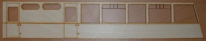

It would be possible to rejig it more like this:
But is it worth the hassle, and the fun putting it all back together neatly and concealing the joints?
