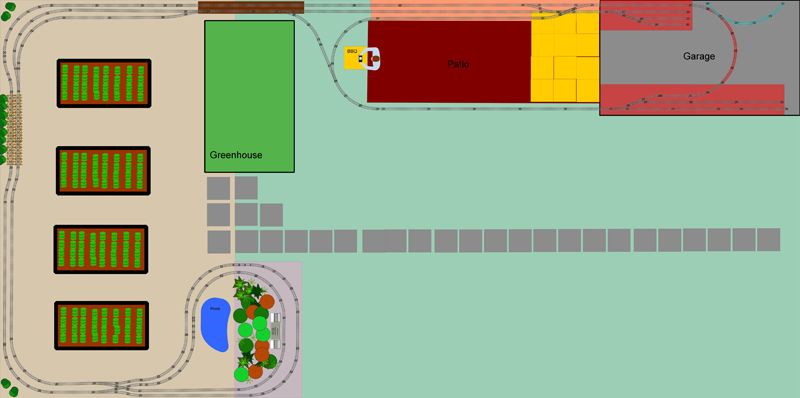

Progress in a way.... we now own the property and as work on the inside is coming to an end i've had a few spare days to start sorting the garden out.

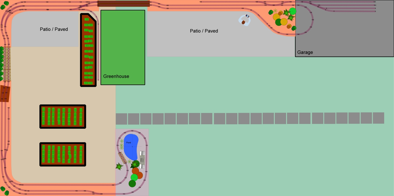

The current plan is (with a water feature added)
Click to see full size image

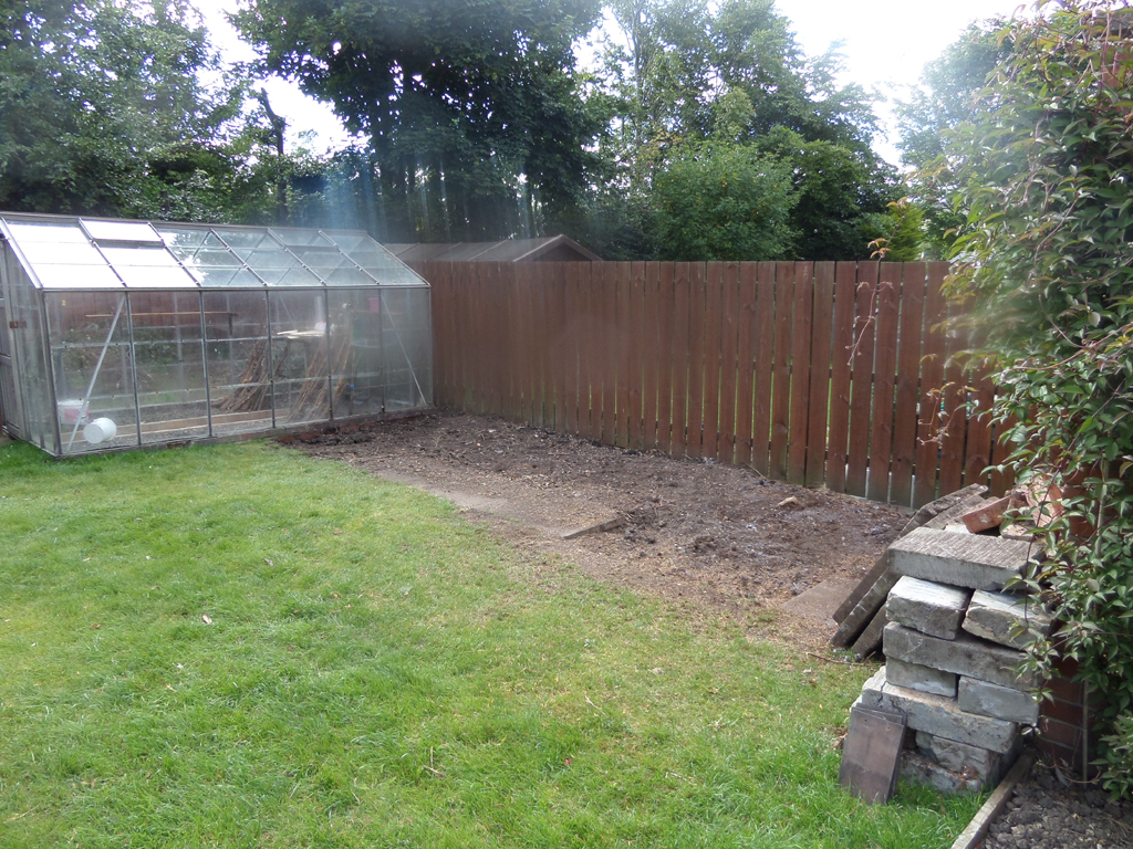

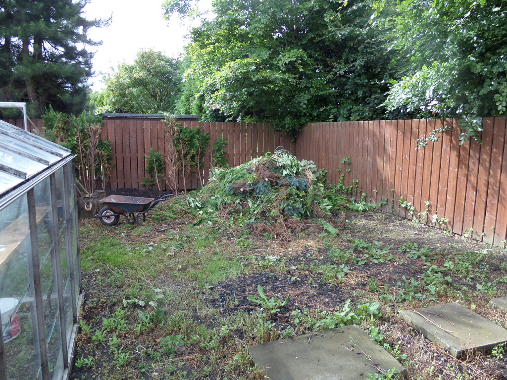

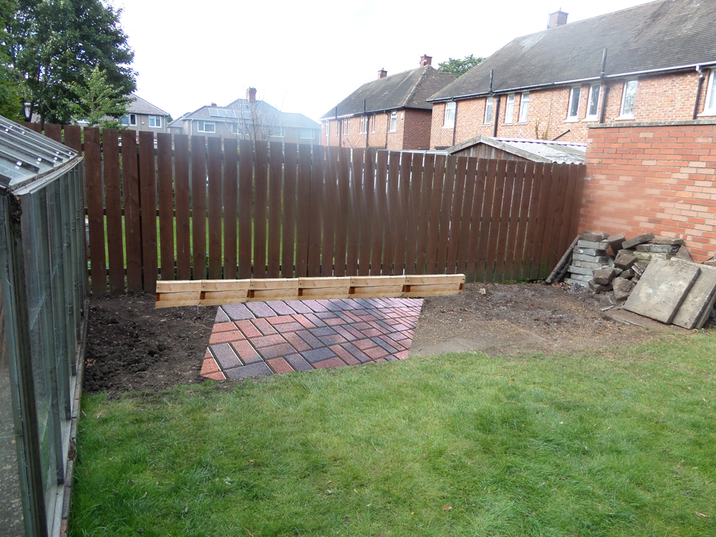

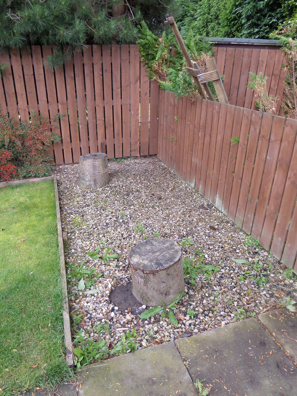

Some images of the area top centre of the plan before, during and after. Not bad for a day and a half work with a saw, spade and barrow i think.
Before:
During:
After:

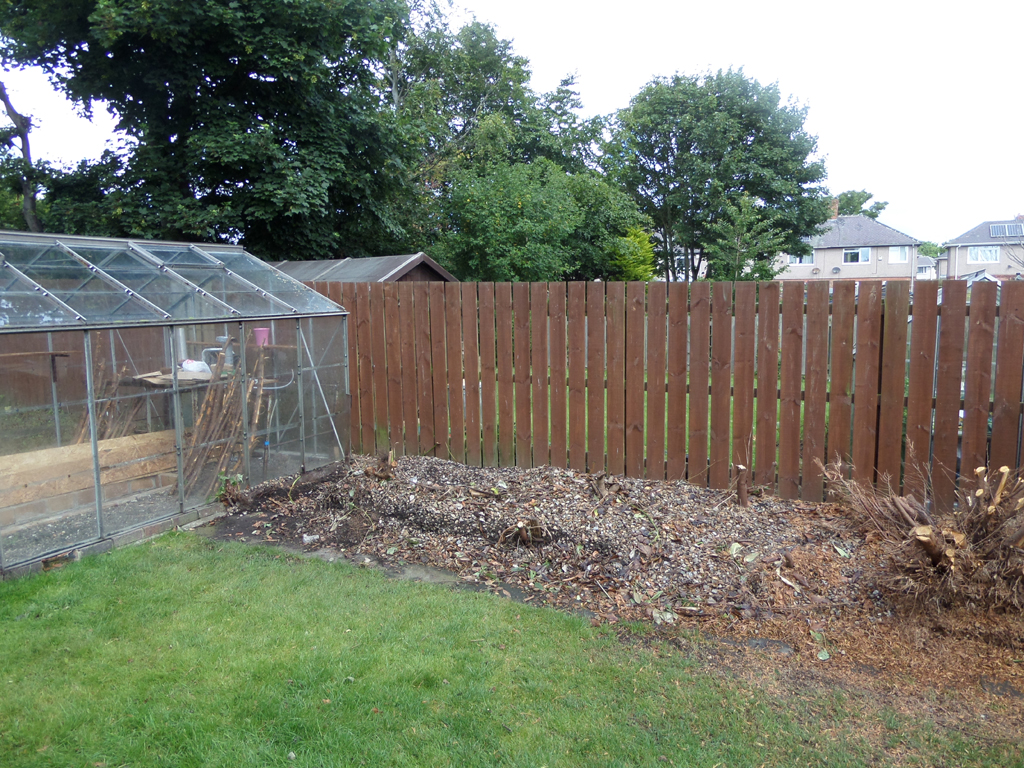

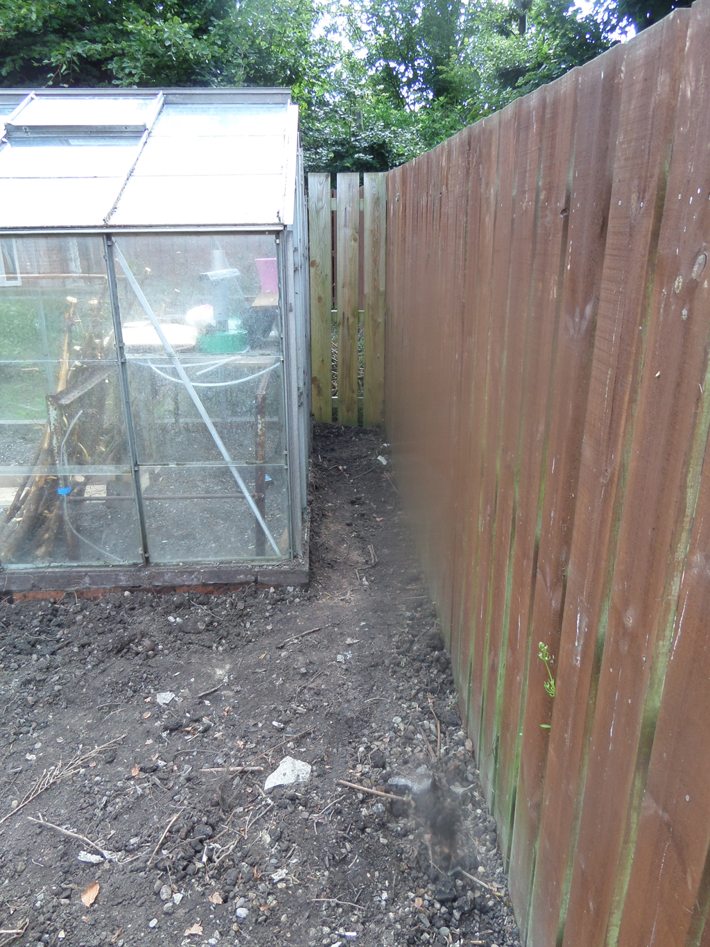

The run down behind the greenhouse, originally i though a single track only but it turns out a double will fit, even better!
The area around where the raised veg beds will be built, the railway will be raised around the edges approx 2ft high.
The area that will be raised up approx 2ft to include the pond and return loop.

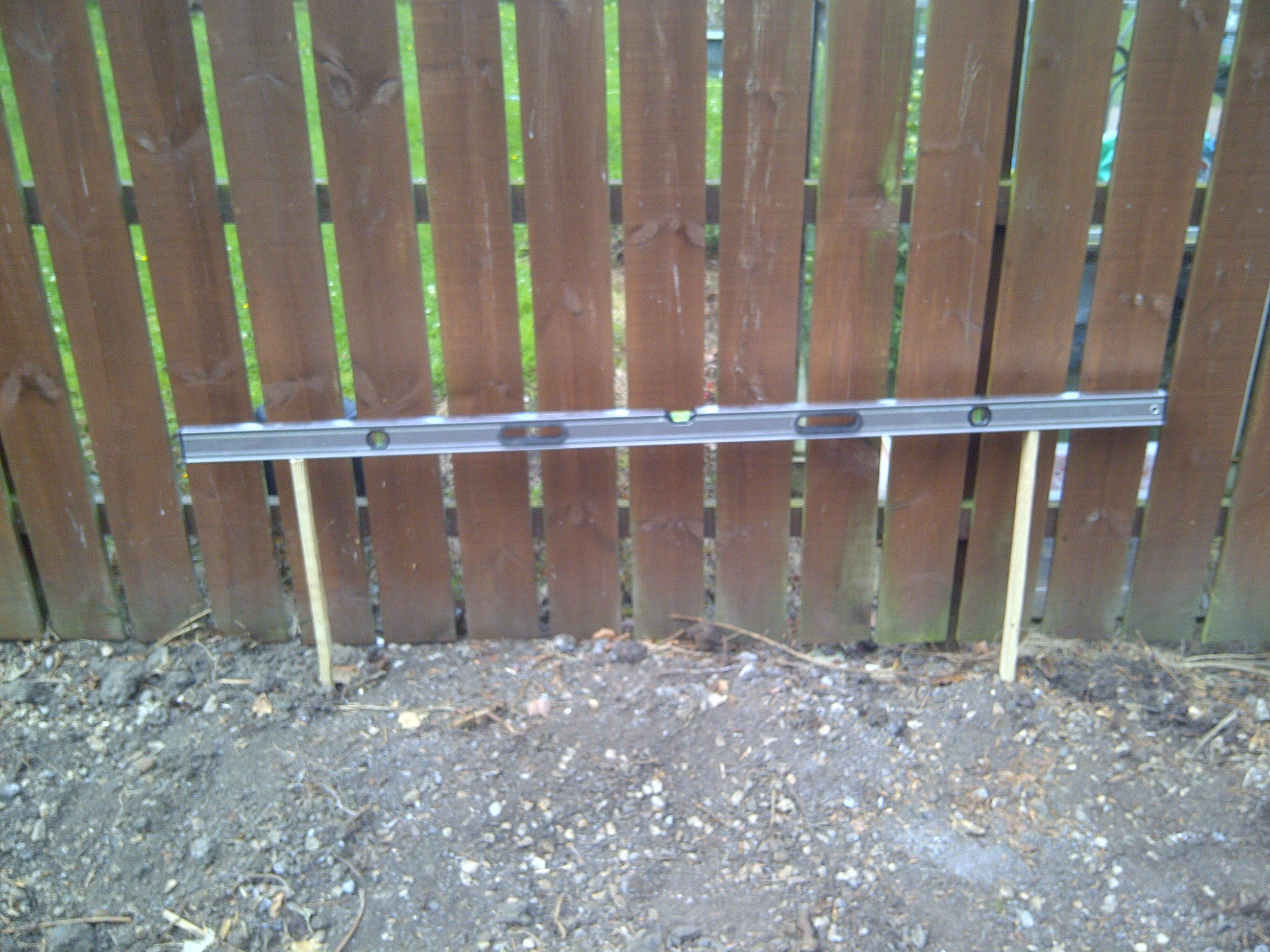

After re-watching the first few episodes of 'Mark Found - The Garden Railway' i decided it was time to start setting a level on the first outdoor section that will be built.
The garden is on a slight slope uphill away from the house.

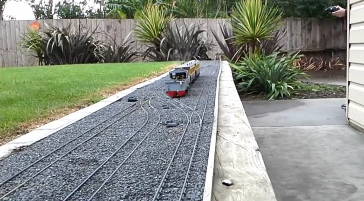

Next on my list is to decide how the raised beds in/on which the track will sit are to be constructed. I've seen the following in a youtube video (sorry i can't remember which video) and i like the finished look, there wont be grass behind mine, just a breeze block retaining wall then a small gap to the fence.
And (sort of) mocked up the idea here i photoshop.
The question is what do i fill the space with the ??? question marks in the below.
maxi-model
Post by maxi-model » Sat Aug 08, 2015 8:13 am
Earth. hardcore. Leave a bit at the top for a weed membrane and a 2-3 inch layer of granite chippings ( for ballast). Don't forget somewhere for the water to exit, seep out. Max.

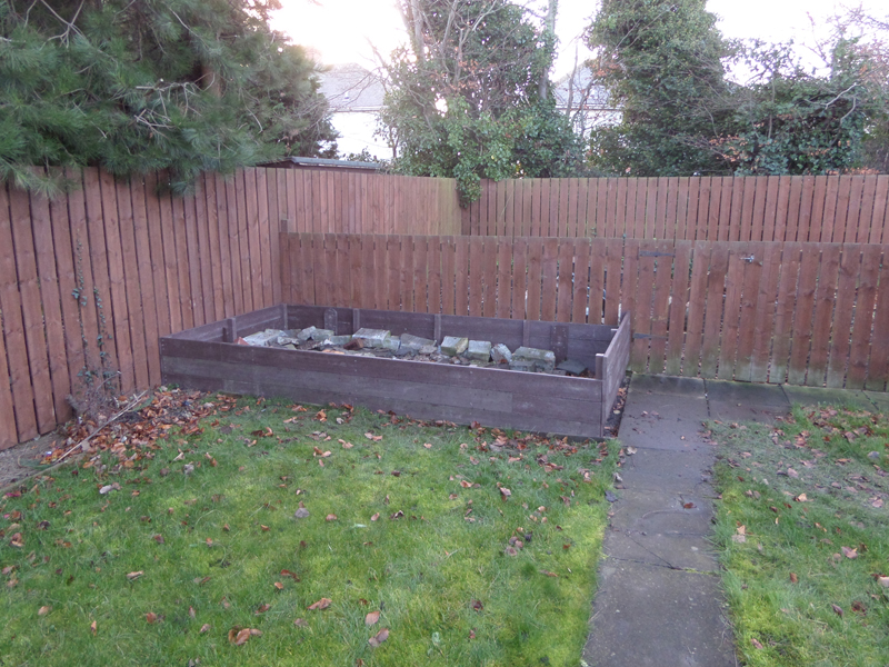

Post by stevenfitch » Thu Dec 24, 2015 2:48 pm
After looking round a bit i've come across building a ladder rack support system from recycled plastic (doesn't rot, doesn't need painting)
So i'm using some stuff from this lot - http://www.filcris.co.uk/products/garde ... y-products
Ive got the materials to build a ladder rack but first ive made a raised bed which one end of the track will run through and also gets rid of the soil excavated from elsewhere.
The bed is the grey block with trees etc in at the bottom of the plan.

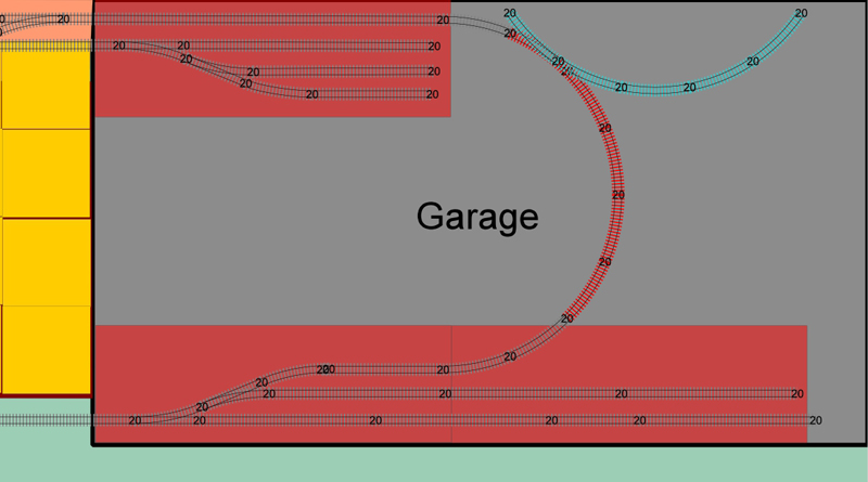

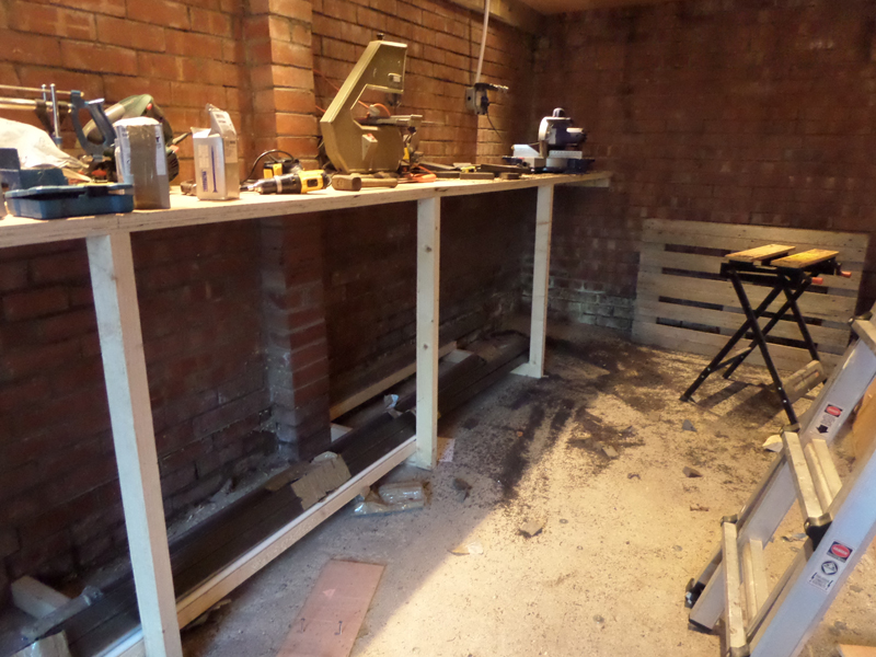

Also some progress in the garage, there are now work benches, lights etc - The track is going to come through approx 6 bricks above garage floor level and run under the bench.
I need to work out how to make the track highlighted in red removable to it can be stored where the track in blue is when not in use.
The rear of the garage has been dug down to just below garage floor level, paving slabs, steps up, more paving slabs then a (full size) door being put in that wall along with two portals for the train tracks.

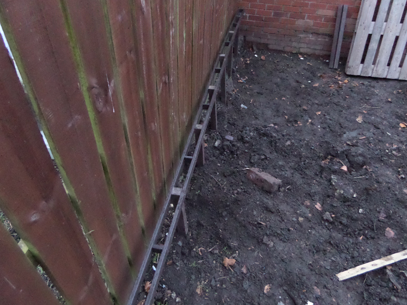

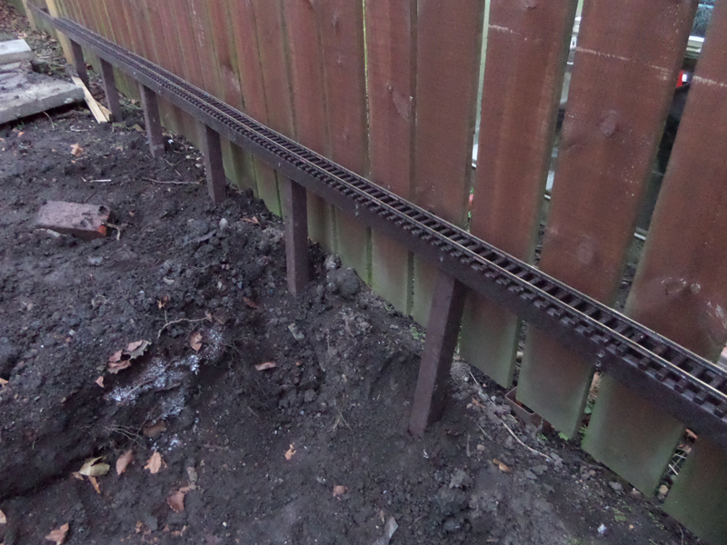

Post by stevenfitch » Fri Mar 04, 2016 7:19 pm
Some progress in the garage / storage yard side of things.
Ladder trusses constructed for the track as pictured, these will sit on top of some 2by2 cross pieces fitted beneath the benches once the exact height from the floor has been calculated.
stevenfitch
Posts: 223
Location: Northumberland UK
Post by stevenfitch » Fri Mar 04, 2016 7:23 pm

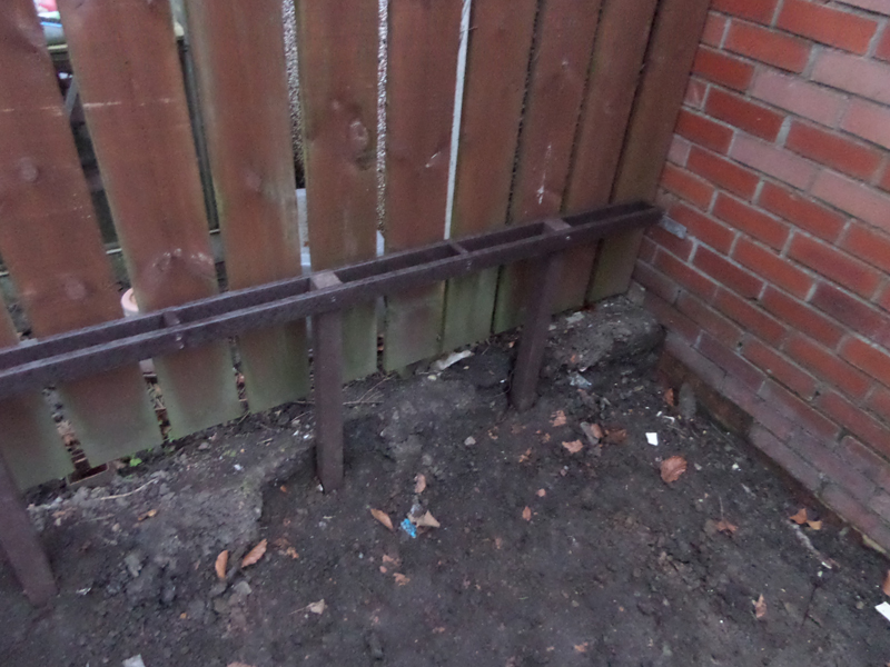

and outside, first set of recycled plastic truss is in..
lessons learnt, 6m is too long to handle at once on your own! and bedding the posts in need some improvement.
Posts: 6033
Post by philipy » Fri Mar 04, 2016 8:13 pm
Steven,
It's looking impressive but I'm not sure if I'm missing something, but are you really proposing to fit the track on the filcris ladder as you are showing it in these pictures?
You've got absolutely no leeway for derailments and at that height off the ground it is likely to get VERY expensive.
stevenfitch
Posts: 223
Post by stevenfitch » Fri Mar 04, 2016 11:04 pm
philipy:116590 wrote:Steven,
A fair point!
The ground at that point is likely to be raised some more to form a raised bed with the track level approx 30cm above and that would be the highest point (the garden slopes uphill away from the garage)
From what i've seen of other raised railways there doesn't seem to be any protection provided, some even running over paved areas. What would you suggest?
