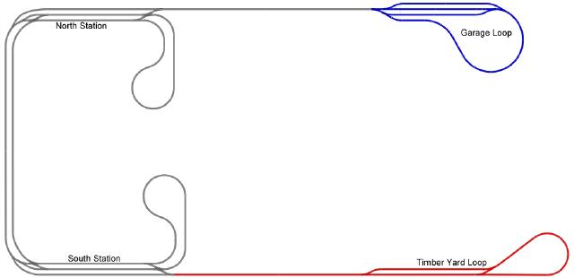

Decision Made...
OK, some deciding has been done and i've dropped the idea of UK rolling stock in favour of 'whatever goes'.
I've also got as far as an initial plan done in anyrail. Don't worry, the tracks will not be as perfectly / boringly straight as the plan and its nowhere near scale size!
The trackwork itself will be approx 2ft from ground height situated in yet to be built raised areas, fronted by railway sleepers (similar to what Mark Found did in the TV series). The beds will be full of compacted earth, trackbed made out of breeze blocks, track screwed to this with rawl plugs. I am hoping to keep the trackbed mostly a few inches above the surroundings on a mini embankment. Track surrounded by various rocks, plants etc to provide the scenics.
The BLUE track will be inside the garage used as a hidden yard during operation and also provide on and off track storage.
The GREY track is phase one and is to go into the currently blank canvas that will in the centre have some raised vegetable plots.
The RED track is phase two which will hopefully be fitted in and around the existing flower beds down one edge of the garden.

maxi-model
Peco is a code 250 (rail height in thou) track system not code 332 like all the other easily cross compatible 45 mm types - Piko/LGB/Accucraft/Aristocraft/Trainline/Bachmann. Yes, Tenmille, another make, is Code 332 but is a different rail profile and needs adaptors. You can incorporate Peco with the others but only with special adaptors. So, awkward to "mix and match" and less comprehensive where specialist "set track" formations and components are required. What do you consider "larger radius" ? Anything below 4 ft (8 ft diameter) and you could be making serious limitations for yourself in future. Depends on what you want to run though.
Rail benders (a type of hand held rolling mill for rails) IMHO are pretty essential if you are bending lots of flexi rail sets. Not cheap to buy (some retailers will rent them) but well worth it if you want clean running track and no awkward transitions. Again if you start using different rail profiles you will need different rail benders for each type, or at least different roller components fitted to the rail benders. Expensive
Looking at your track plan I can see a lot of electrical conflicts, if you are going DC, where your track loops back on itself that are going to require a lot of reverse polarity switches or similar and need to consider usable train lengths in these sections. Don't know if anything in DCC solves this. Doubt it.
As you say are going down the DC/DCC route I would recommend you join the G Scale society and get along to one of their group members' meets local to you to get a feel for what it is all about before doing anything else. Their annual show is on in Stafford, if that is not too far, on 22nd March. Or you could go to the 16 mm NGM show at Peterborough on the 13th April. Both have all the big (and small) retailers in attendance, pretty much the same bunch at both, who will be able to put you on the straight and narrow (geddit !). They are well worth the trip as you will easily spend a whole day there at either. Leave credit card at home and don't be tempted by the cash machine :D Max.
P.S. You might want to take a look at the G Scale Central Forum http://www.gscalecentral.net/ for posting regarding DC/DCC related matters. The Garden Railway Forum seems to be geared mainly to live steam and battery power operators. Most here may not be familiar with the issues surrounding DC/DCC operation that you will be needing information on. No disrespect to those here.

Cheers for that:maxi-model:109160 wrote:Peco is a code 250 (rail height in thou) track system not code 332 like all the other easily cross compatible 45 mm types - Piko/LGB/Accucraft/Aristocraft/Trainline/Bachmann. Yes, Tenmille, another make, is Code 332 but is a different rail profile and needs adaptors. You can incorporate Peco with the others but only with special adaptors. So, awkward to "mix and match" and less comprehensive where specialist "set track" formations and components are required. What do you consider "larger radius" ? Anything below 4 ft (8 ft diameter) and you could be making serious limitations for yourself in future. Depends on what you want to run though.
As far as track goes i think i'm going to stick with PIKO code 332 and the curves will be using the setrack so no need for a rail bender.
As far as the electrical side goes i'll be going DCC automated which ive already done in n-gauge (http://www.modelrailwayforum.co.uk/show ... php?t=5314) so i'm fine with using auto reversing sections etc, just need to work out what cabling to use now.

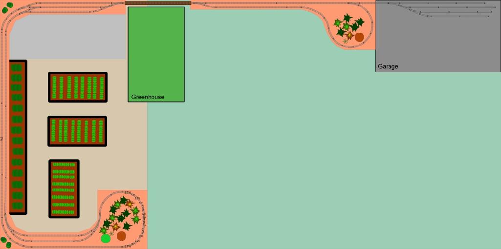

A new plan has been devised now i've started using the actual dimensions of the garden, the brown boxes are raised veg beds.

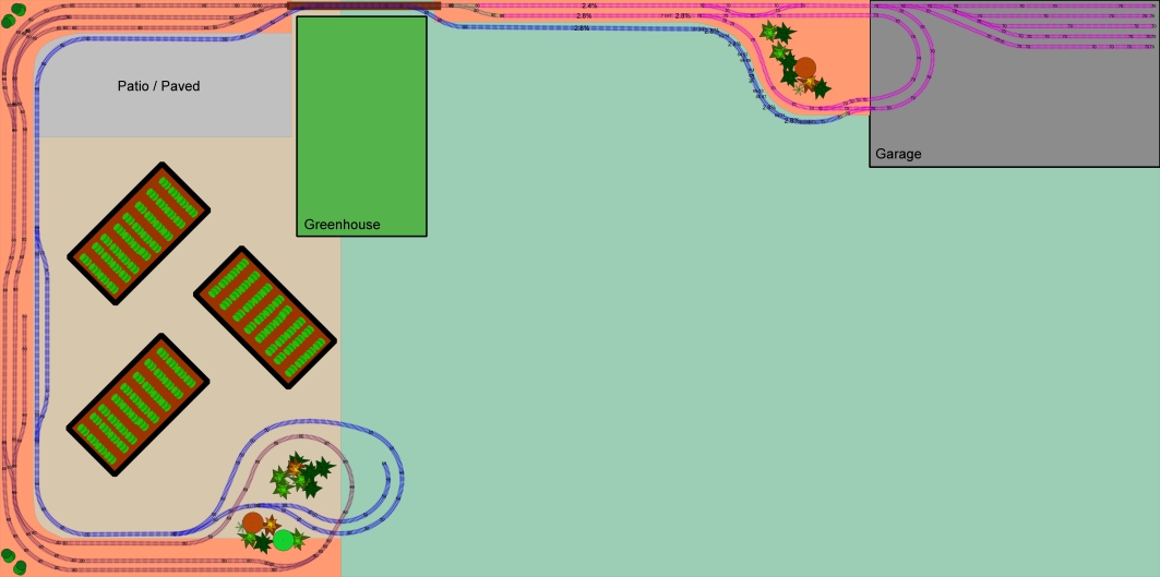

The decision has been made that my current N Gauge layout will be dismantled and sold off as there is just no room for anything like it at the new house. This then gives me the equipment, budget and justification to go bigger on the garden railway plans.
Existing Layout - http://www.modelrailwayforum.co.uk/show ... php?t=5314

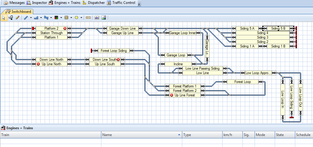

New plan and schematic of automation.
The dark purple is at 80cm from ground height
The pink is as 70cm from ground height
The blue is at 50 cm from ground height
There will be a double level bridge behind the greenhouse (track levels 80cm and 50cm)
