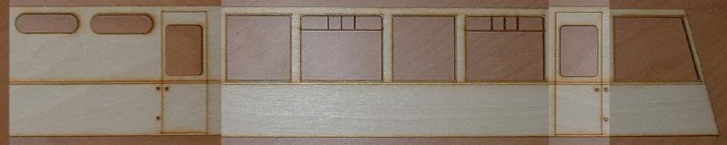

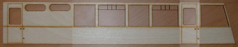

Ah, more like this:spooner:62188 wrote:I think the rearrange layout better.Have you thought of leaving the door at the rear and moving the over door?
This I quite like - space between rear doors and passenger saloon to be Guard's compartment on one car, and toilet on the other?
Not convinced I can add an extra door in a sufficiently convincing way that will match IP's laser cutting.

I think your fears are unfounded Richard, especially while you're still working with the kit in component parts.
I bought a very rough (build & paint) "Atlantic" buffet coach and successfully cut out a centre section to shorten it to a four-wheeler.
I've yet to shorten the obsevation coach I got at the same time - I just haven't decided how short yet
Whichever layout you chose I reckon you can tackle the surgery without too much worry. ;)

.....suggestions.....Narrow Minded:62219 wrote:Whichever layout you chose I reckon you can tackle the surgery without too much worry. ;)
A good, sharp scalpel - or a crummy old stanley knife to break the grain and finish off with a razor blade?
Use 2 strips of scotch tape separated by your cut width to stop the edges whiskering?
Fill using high-build spray primer, rather than that stuff off the Marian in Jolly Jelly? (Milliput). Lots of rubbing with 600 grade?
Sounds easy, but might be awkward. I think I'd sneeze at the wrong moment!

These things have always reminded me of the VR 280hp Walkers, which had two coaches articulated to a 4 wheel power car. Somewhat like the GNRI ones, but more modern looking with streamlined ends and no outside cranks. They lasted until the '80s here and at least one is restored and running in preservation.hussra:62184 wrote:Hmmm, musing on the door-rearrangement idea.
http://www.victorianrailways.net/motive ... lk280.html
The cab at each end took up half the body width and there was an external cab door on that side, with an internal door into the saloon on the other. The motor man had to lean over the passengers to change the staff if the platform was on the wrong side, as it was half the time. There was a double seat on the other side with a great view forward through the other half of the windscreen, which we knew as the railfan seat.
Rather than monkey around moving doors, I'd just add a thick pillar in the side window opening on the drivers side and scribe a suitable door opening. On the passenger side just add a narrow piece to the window opening to make a quarter light.
I've easily scribed in doors and boards on decent quality ply (like IP use) by using a fine tooth Exacto saw blade to cut a narrow groove. Most Exacto saws have the teeth pointing towards the handle, so you just angle it so the last couple of teeth cut the groove. Clamp a steel rule to the car side as a cutting guide and draw the blade towards you, so it is in tension and remains straight. Only cut through the top ply by about half the thickness, any deeper is wasted effort. A coat of sanding sealer (or model aeroplane dope, or shellac) to bind the wood surface and it will look like Ivan cut it with the laser once it's painted.
Any gaps in seams where you glue the wood together can be filled with model aeroplane filler (I use Squadron White Putty, which doesn't dry in the tube before you use it) and sanded flush before sealing the wood for painting. If you use a block of wood with sandpaper glued to it to square up the mating edges, the joints will be close fitting in any case. I've found there is plenty of extra ply left in an IP kit, so the thickness and texture of additions will match the rest of the body.
The simplest way of making vestibule connections between the saloons is to find some very soft black foam rubber, glue a sheet of plasticard to the face as a rubbing plate and have them almost, but not quite, touching on straight track. If you use R1 curves, forget the connections as they'll cause more trouble than they are worth, but on medium or better curves, the problems will be controlled by mounting the rear bogies as close to the back of the car as possible, so relative side movement is minimised. The trick is to have just a little clearance between the running plates. From most angles you won't see it, but they won't hang up on crossovers or S bends if they aren't under tension.
If you want something a little more prototype in appearance, fold some heavy black paper into concertinas, make the rubbing plates wider than the foam block and glue the concertinas to the rubbing plates and the car ends, but not the rubber. For the canvas used on the top of a lot of vestibule connections, glue a piece of thin black fabric to the top of the rubbing plate and a piece of plasticard on the car end. Don't glue it to the concertina or the foam. Try to use black paper and fabric. If you paint it, it will lose flexibility and cause you grief sooner or later.

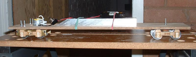

Incidentally, the power bogie came up well. Nice neat engineering.
Consider enclosing the metal gears in a light casing. 10 thou brass is plenty thick enough. Gears are down low near the dirt in garden railways and if they aren't enclosed, the lube oil or grease picks up dust blowing around and turns into something akin to lapping compound.

Yes, a cover over the working gubbins is planned - the bogie is workable but not yet complete. (It could also do with some means of attaching it to the vehicle, really!)
Good to have a range of ideas for what to do with the bodywork - time to do some thinking and to suck my pencil a bit. I am still sort-of minded to move the doors one way or another. Another idea would be to do that, plus swap the rear portion between sides (assuming I can cut the two sides in the same places), ending up with a door at either end of the passenger saloon:
(Clearly the camera wasn't quite square on when I took the photo.)
The idea would be for a half-width driver's compartment as you describe, opening into the passenger compartment, with the bonus seat with the great view next to it. Time to consider, then get chopping.

That's normal on saloon carriages with doors at each end of the saloon. The doors are hinged against the end wall/toilet wall/partition wall, whatever.....hussra:62266 wrote:Ah, no, that's no good - you end up with the two doors on each side hinged different ways. (The two sides are lasered as exact mirror images.) Will continue to consider option 2.
It's usually only dogbox compartment stock where the doors all open the same way.
