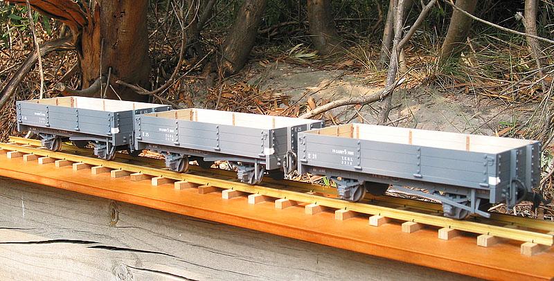

Summer this year has been too hot to spend much time out in the workshop, so I've been inside building rolling stock.
Back when I started building wagons for the TVT, I built a batch of three drop-side open wagons. I recently built another batch with some minor changes and finally got around to taking a photo. the other day. These will probably the last 4 wheel stock built, as I've moved on to completing the bogie goods vehicles that have been sitting around for some time.......
The sunlight at the time was a funny colour due to smoke haze from the bush fires in Gippsland, hence the slight orange tint.

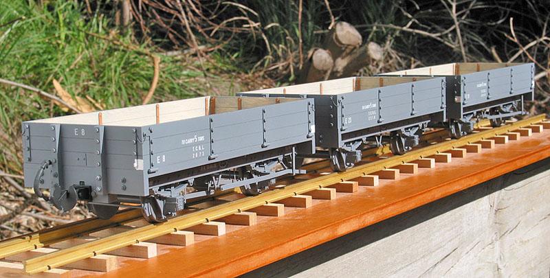

The following photo. is the original batch of trucks for comparison.

Post by robc_wa » Wed Feb 19, 2014 7:12 am
The quality of your work never ceases to amaze me. Beautiful wagons!
BTW, is that track code 250 rail spiked to sleepers? If so, what wood are you using to get a combination of “spikability” and resistance to the great Aussie outdoors?

Post by GTB » Wed Feb 19, 2014 8:47 am
robc_wa:96879 wrote:BTW,  is that track code 250 rail spiked to sleepers?
That's just my photo track, it only sees sunlight when I take pictures.
The rail is some locally made brass code 330 and the sleepers were sawn from an off-cut of mountain ash, which wouldn't last very long at all outside in this area. The base is just an MDF off-cut.
If I get around to building a track at home, I was planning on using brass or aluminium code 250 rail and cypress sleepers. Cypress is used locally for fence posts and pickets and seems to last pretty well, so I'll just rip a few pickets down to sleeper size. Jarrah would be better, but it's a bit pricey here in the Eastern States. I'd like to try recycled plastic sleepers, but can't currently find it in suitable sheet form.
I prefer a raised track, so was planning to use recycled plastic for the support structure. There's a company making it locally who sell direct and I notice Masters stock something similar now. Haven't seen recycled plastic at Bunnings and the local hardware doesn't stock it anymore.

Post by Andrew » Wed Feb 19, 2014 9:52 pm
Beautiful wagons, well done!! A whole rake of your scratchbuilt stock will be a sight to behold... Just out of interest, what do the little white squares signify?

Post by GTB » Thu Feb 20, 2014 9:44 am
Andrew:96888 wrote:Just out of interest, what do the little white squares signify?
The VR had a lot of goods trucks with handbrakes on only one side and the white square gave the shunters an indication of where it was when they needed to get to the brakes in a hurry. The TVT is located in Victoria, so follows VR ng practice.
