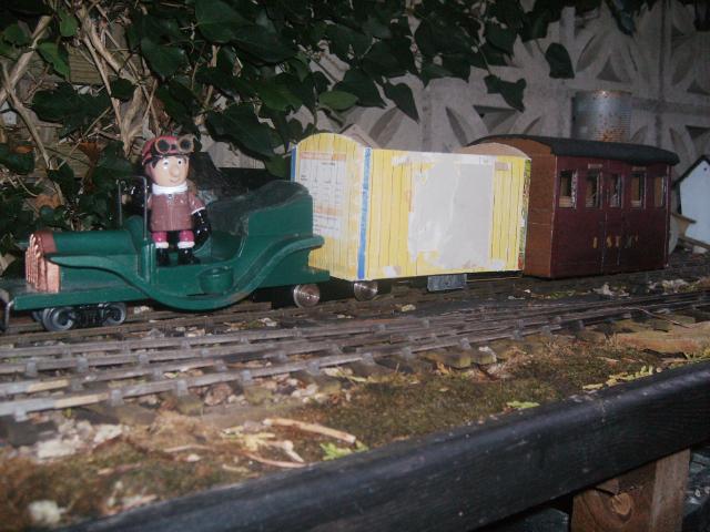

I enclose photos of sons Phils first fun locos on a similar theme....they need proper running chassis. I just plonked Binnie wheels on them

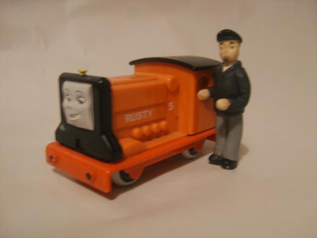

A word of advice to those thinking of the cheap Thomas toys (and similar i.e. Postman Pat or even the figures...the originals were something you could convert to small 16mm / g scale or even Gn15, but I noticed this Christmas they are smaller in size....so worth checking dimensions or it will be a oo build!!!
This is 7/8ths...another forgotten project!
