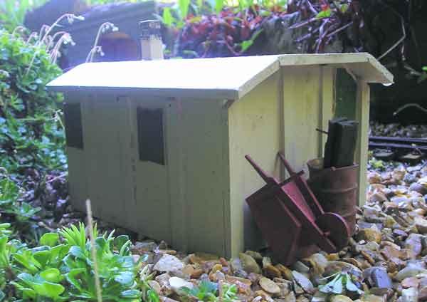

Foam board (like wot estate agents in the UK use for "FOR SALE" boards is good - the MDLR's Southern Railway concrete lineside hut was built with this, with added wooden detail and painted with masonry paint.

Foam's good and weatherproof ~ the "ultra low relief" row is just a sheet of foam, while the grey "back-to-back terrace" is sheet foam construction with a plastic roof and resin shop fronts on the street side.
