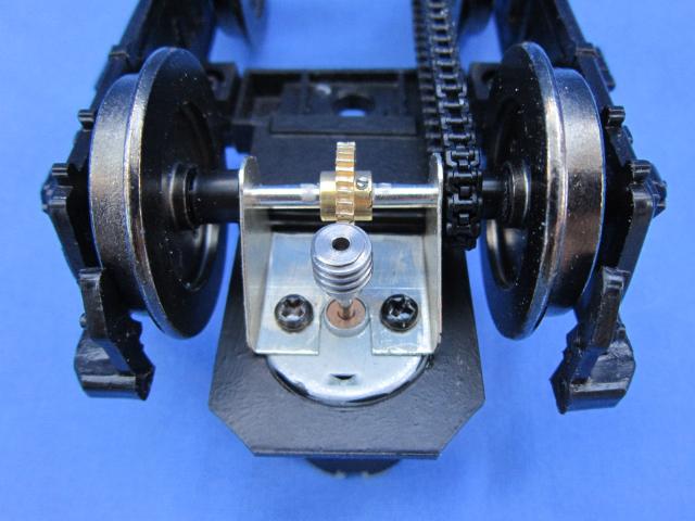

The bogies which came with the kit are well made with heavy duty solid metal, free rolling wheels set at 45mm gauge (which I don't do normally. The advantage of extra width made it possible to fit a gearbox to one axle with Delrin chain drive to the other. The motor is battery powered with the holder attached underneath the chassis for easy access but hidden from view.

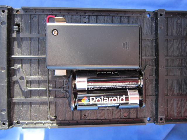

Also supplied are interior lights which are powered from a separate, switched battery holder placed underneath.

Pictures show progress so far and include shots of details like the battery boxes and switches, engine sump... (who on earth is going to see that???) driver, bogie and drive mechanism.

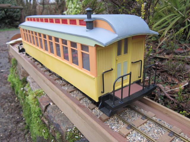

The finished article.
Photgraphed outside where it should be but on a length of 32mm track because I don't have any 45mm to put it on.....use your imagination!
