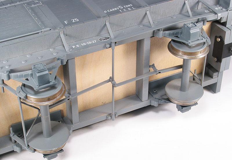

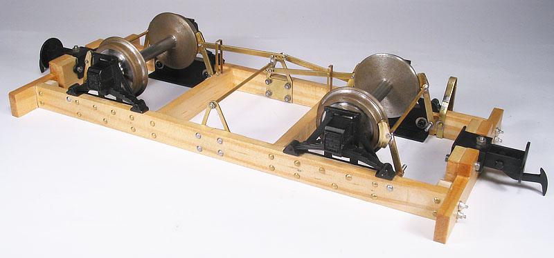

4-wheel Underframe
I've standardised on Accucraft W&L couplers and axleboxes, but I make my own wheels, brake parts and saw the wood to size. The 'rivets' are brass escutcheon pins and the 'hex bolts/nuts' are white metal castings. The westinghouse brake hoses are from Ozark Miniatures, but aren't fitted to the underframe until the body is in place.

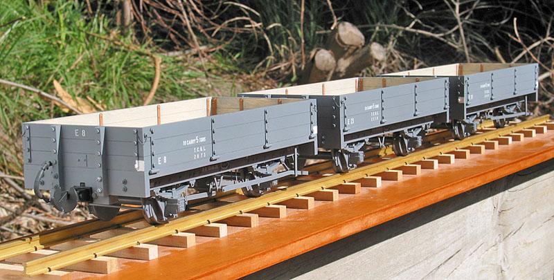

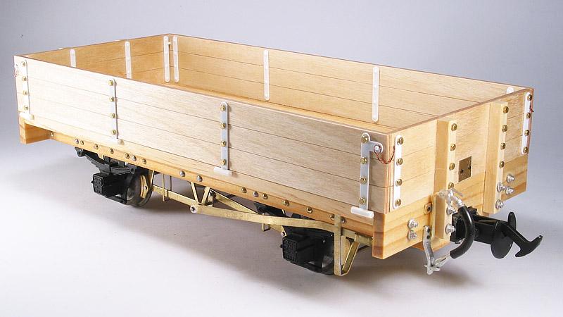

Drop-side Trucks
These are basically just a 2.5mm ply box, with planks scribed in and strapping, hinge detail, etc. added. White bits are 0.5mm polystyrene sheet and the brass 'bolts' are miniature lag screws, #0 x 3/16" from memory. Assembling the basic body only takes a couple of hours, but as always the devil is in the detail and adding the surface detail takes several days.
I built these as a batch of three, but need to build more.

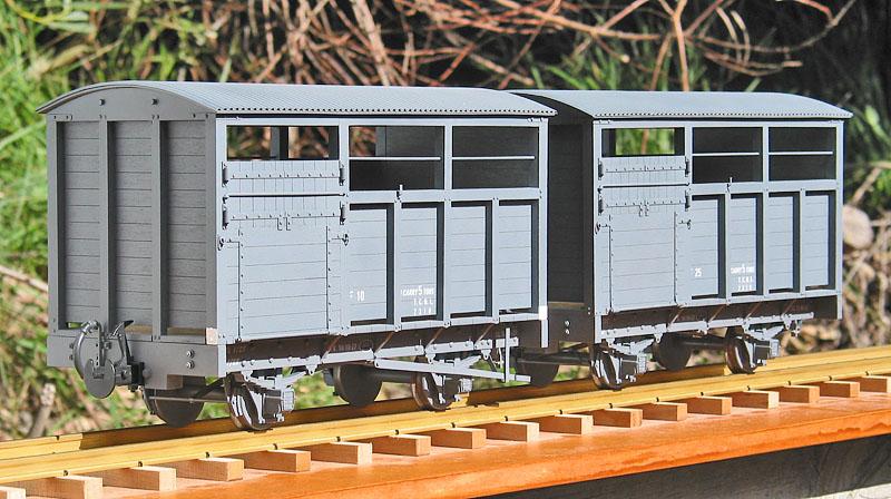

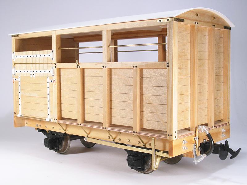

Cattle Trucks
These are based on early VR broad gauge cattle truck designs and the bodies are built from wood strip and scribed ply. The roof is made from corrugated card over polystyrene, to simulate a double roof.

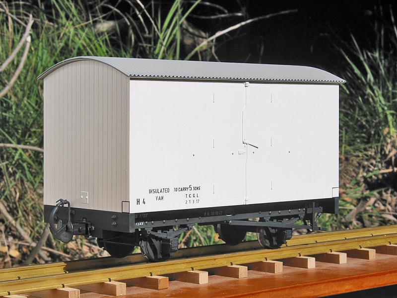

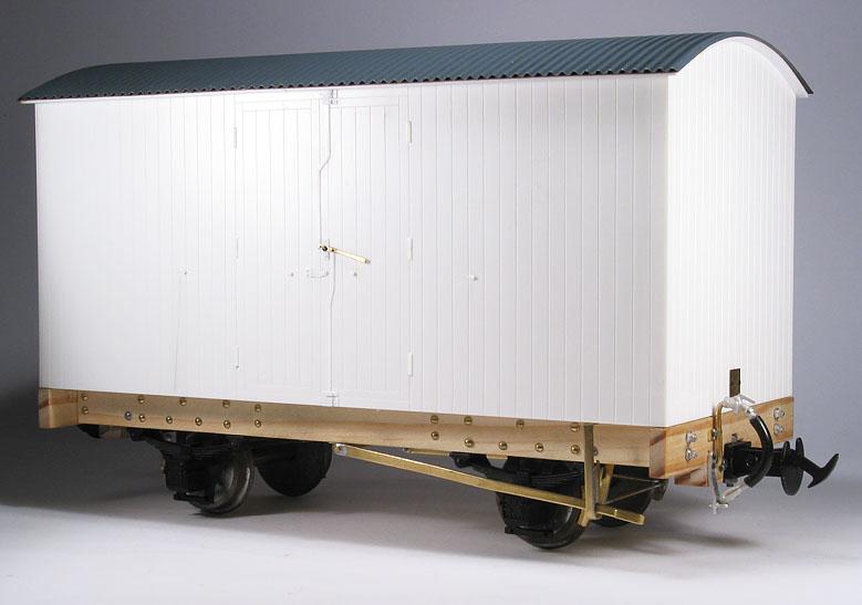

Insulated Van
This has a body built from polystyrene sheet, with the same roof construction as the cattle trucks. It isn't easy to take a photo of a white model, but the matchboarding is simulated by scribing the polystyrene sheet with an Olfa P-cutter. Basically a 4 wheel version of the VR narrow gauge bogie insulated van.

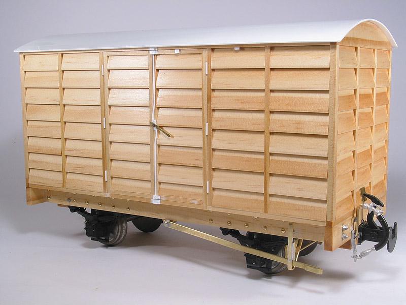

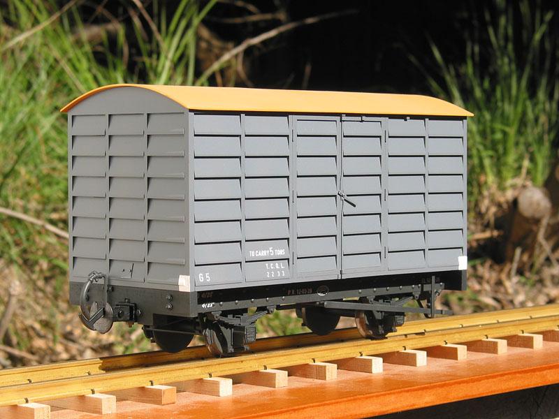

Louvre Van
This is built up from machined wooden louvres with stripwood frames and a polystyrene roof. Again, basically a 4 wheel version of the VR narrow gauge bogie louvre van used for carrying perishables.

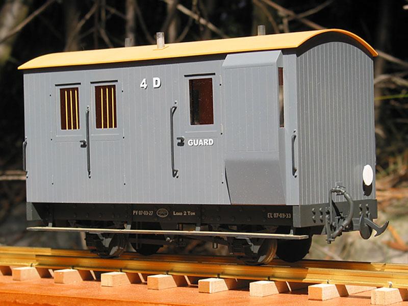

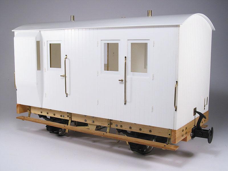

Goods Guards Van
I think this one has it's own more detailed thread somewhere....
Also built from a scribed polystyrene body and roof. The sides are built in three layers, 0.5mm layer scribed to represent match boards, 0.5mm layer with smaller openings to represent the window sashes and finally a 1mm inner layer with larger openings to provide a recess for the perspex windows. The side lookouts were built up in a similar manner and fitted over a large opening in the side.
This is based on the VR broad gauge guards vans, but is fitted with side lookouts, rather than a roof cupola.

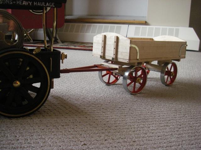

I built something similar, although not as complicated once to go with a model steam tractor, sort of a "semi scale" Fowler traction wagon

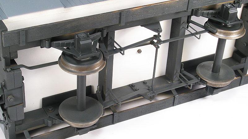

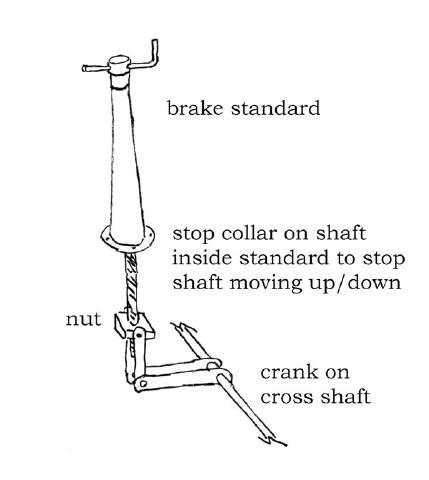

Keith S:75361 wrote: I would like to make some brake detail on my IP brake van, but I have no idea what the brake gear looks like on a brake van as opposed to a regular goods van. Do you have any information on this? How does cranking a brake handle activate the brakes? I would be grateful if you had a picture of the bottom of your brake van so I could copy it.
The main difference is that brake vans have a brake standard/wheel inside to operate the handbrakes and all wheels have at least one brake block, which was not always the case with an ordinary wagon, especially in Britain. There were probably as many designs as there were railways........
This photo shows what is under my TVT guards van. This is the sort of thing that you'd find under a van with handbrake only. Since the van is closed and I wanted a working yard brake, you'll see a pull rod running off to the buffer beam at one end. This has a notch that fits over a small screw and latches the brakes on. There's a bend on the end that gives enough finger purchase to apply and release the brakes. The TVT is an air brake line, but I haven't bothered fitting the cylinder, air reservoir, etc., or the slotted lever that would allow the handbrake and the auto brake to be applied independently. You can't see most of it in normal use.
This sketch is the sort of thing you'd find inside the van if the brake wheel was located in the middle of the van. It could have a spoked wheel, or a handle like the sketch.
If the brake wheel was fitted at one end of the van, you'd also need an intermediate shaft and a crank with a pull rod to the crank on the central cross shaft. The pivoted nut and double pull rods are to clear the screw shaft and to make sure nothing binds as the nut moves up and down. Real ones had a square thread, but a BA or similar thread is fine in this scale. You also need a collar somewhere on the shaft inside the standard to stop the brake wheel just lifting out of the standard as the handle is turned, instead of applying the brake.
The last photo is the brake arrangement under most of my wagons, which I've now standardised for future construction. On a real wagon this would be a combined air/handbrake and there would be a cam on the brake handle to separate the operation of each brake. When the VR started fitting air brakes to everything in the 1880's, this was the arrangement used to replace old handbrakes that had just a single wooden brakeblock. My open wagons were built before I changed the design and they have separate yard and air brakes, which was a much later VR design.
